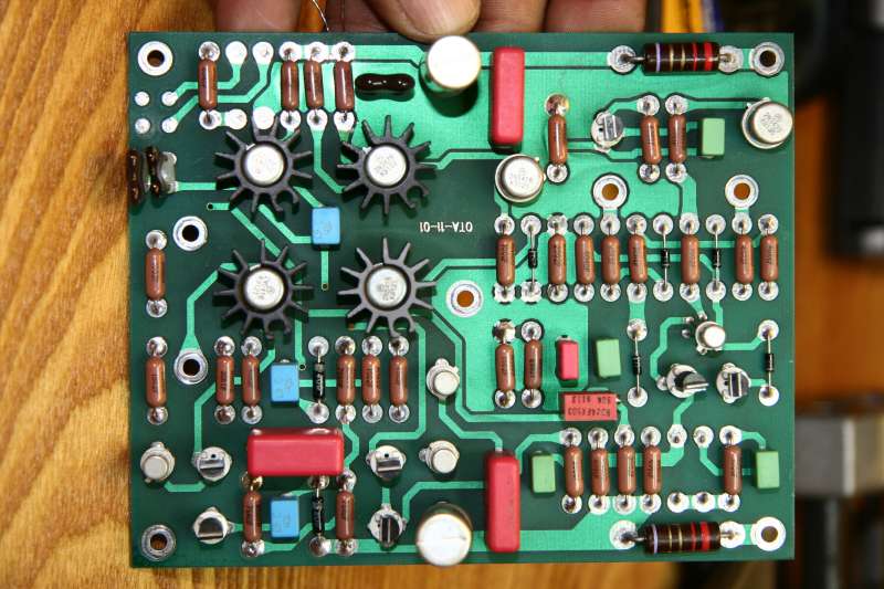

Got about $50 worth of parts, mostly same specs as the ones in the Cello (quite a few are Mil-Spec). Replaced the electrolictic and some other caps, a few transistors, and a few resistors for good measure (I had "smoked" a couple of them trying out something I absolutely shouldn't have).
Quite hard dealing with double-sided plated-through boards with old solder, but managed to get the parts I thought needed replacing on to the board. So far, works beautifully and no crackles and pops as yet...

Hmmm....
It appears that the main power transistors in the "fixed" channel are running considerably cooler than the the other channel (heatsinks are nowhere near as hot). The sound appears to be OK from both channels, and similar in volume and quality.
I believe the Duet is a pure "class A" and should be running "hot" even when there is no signal. This doesn't make much sense.

The 350W duet is ClassAB2 as Cello calls it, see here
So just a tiny amount of ClassA to reduce crossover distortion (several 10s of mA).
By the way, I hope you didn't change transistors that need to be matched. Would be a pity to unnecessarily kill the performance of the amp. But without a schematic impossible to say - however the outputs are definitely matched. If you changed e.g. the drivers with different parts bias readjustment could be necessary.
A few things come to my mind: the tiny bandwidth that this amp has; I do not remember another amp that goes already 1dB down at 20kHz. 2nd, it was largely argued by Colangelo that a high input impedance is beneficial, though the inverting input is again - as in the Encore - of rather low impedance (5k). Gain is also a bit high (just as in the Encore).
I'm wondering wether this Duet has the same interesting topology details as the Encore* has or wether it is more convential.
All the best, Hannes
* don't forget the Encore was the heart of the Performance, top of the line Cello-amp.

Same zero NFB output stage is what the THD numbers of the Duet indicate, likely also the reason for the steep roll-off.
The Duet output stage with 6 output devices in parallel probably has 0.33 ohm emitter resistors, means at least 60W of dissipation per channel for close to 90V rails.
Personally i can not imagine anyone not hearing a difference between an optimal Class AB and a close to B biased channel of such a power amp.
(a regular Class AB biased solid state amp is Class AB2, a VFET output stage would be AB1)

Hannes,
The transistors changed were in the voltage gain amplifier board, which is a small board piggy-backed onto the main output board. Transistors changed were 2 x 2N5416 and 2 x 2N3439, and the capcitors around them (please see jpeg below).
Matching could be the reason - maybe the bias is off with the new parts. Still, it doesn't sound strange as yet. I will be using some of my test tracks later on tonight to carefully listen to what is going on.

Well, certainly I can only guess. PCB-layout looks a bit like the Encore's, also the used parts are the same. Seems you changed - as you said - the VAS parts. If a current mirror is used in the Duet - it seems so - matched bipolars for the VAS are not necessary.
However these parts are not particularly stressed thermally (less than 1 W in the Encore), so I doubt that they're broken. But lets hope your problem is gone!
Well, it's all guessing at the moment.
Unfortunately your problem sounds like a tough one (even if one would have the schematic).
PS: funny, seems they used again the U403 at the input.
EDIT: oh I forgot: the drivers are not on this board, so output bias is most likely unchanged.

Well, yes - the main drivers are on the main board, which this board on the jpeg connects to. I am listening to some of the tracks I have produced/engineered, and they sound just fine through the B&Ws. A "mono" test also seems to be fine. However, the channel that was "fixed" still is running much cooler on the heatshsinks than the other channel's.
Should an AB2 amplifier run hot all the time, even with no signal? I find this pretty strange - although I cannot be sure if both channels were running at similar temperatures before the "fix". The board in the JPEG is the Voltage Gain Amplifier board. I might swap this board with the other channel to see if the cooler running goes with it.

The plot does thicken...
Exchanged the VGA boards between channels. The heathsinks still behave the same way - in other words, the cool heathsink didn't "go" to the other channel with the VGA board.
Something else must have gone wrong on the "fixed" channel's main output board, or the amp is just playing around with me. The sound appears to be exactly the same on both channels, even when swapping speakers.

Hi Cleiber,
I'm sorry that I wasn't clear on the heat issue.
Just general comment: the temperature of the heatsink is determined by the bias current set for the output devices. The bias is usually - also in the Encore - set by a trimpot mounted close to the output devices.
The VAS you swapped does not set the output stage bias; so swapping them does not have an effect, just as you found out.
What you need to do is to measure the voltage across the emitter resistors of the output devices _of the working channel_ and adjust the trim pot of the _other channel_ so that you get the same voltage drop across the emitter resistors of the other channel.
However that has still the problem that you don't know if not both channels need readjustment. I will mail you an email-adress, maybe he has the details on the correct bias.
But all of this has nothing to do with your crackling problem. I would recommend you to stop changing parts blindly.

Something is definitely funny with this amp.
Read a bit about bias and DC offset - one of the tests listed was to check the quiescent voltage across the speaker posts. One channel is reading 1.4 mV, the other one 50.2 mV. On the latter (the "cooler" channel), turning the adjustable pot (the only one on the main output board) changes the voltage, but it doesn't go below 30 mV or so. On the other channel (the one that runs "hot") turning the adjustable pot makes no difference whatsoever to the voltage.
The only other adjustable pot I can see is in the VAS (VGA?) board, and I have not tried adjusting that - since swapping these boards between channels made no difference as to how hot the output trans. heathsinks got.
There has got to be another problem here somewhere...

I also wonder now with your skills why don't you bother to derive a schematic of your amp? Every discussion and advice would be far easier and more reliable than the plain guessing at the moment.
Further I would think that with your experience you would never touch potis without knowing what they do.
I think the only reasonable way to tackle this problem would be to draw a schematic, calculate working points and measure both channels. Then you can fix it and finally adjust offset and bias.
PS: I have no idea why an amp must be connected to anything for bias+offset adjustment and honestly I don't remember one which demanded that. Also I would not feel very comfortable with such a thing, since that obviously means that at every power on a DC-surge would be sent through the speakers.
Nevertheless, using a cheap 3W power resistor would have been the safe solution if you insist on a load.
