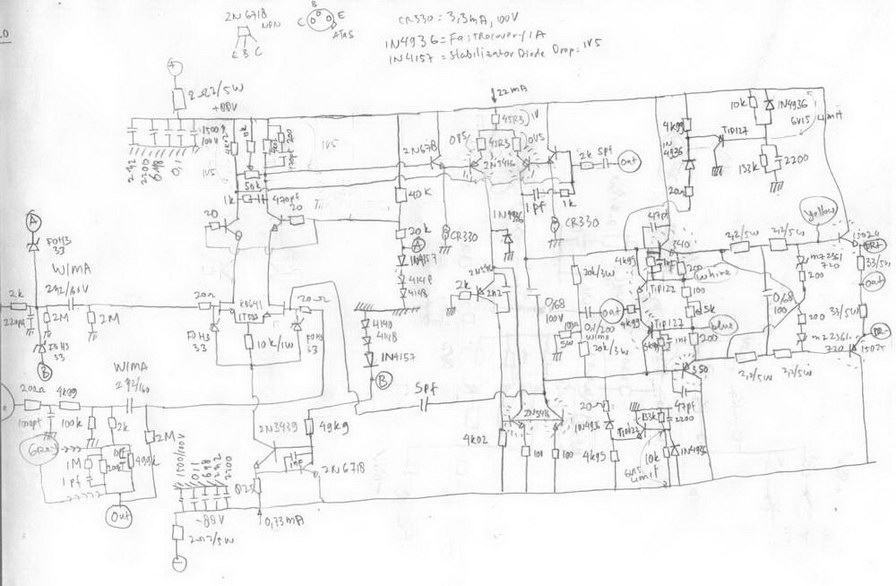

I have a Cello Duet-350 power amplifier. It is about 10 years old. It now generates its own gratuitous, random, static-sounding noise. Input level has no effect on the level of this noise. It is not objectionable with listening to Eric Clapton, but it is quite annoying when listening to Chopin Nocturnes. I have disassembled it as far as I could without resorting to a soldering iron; disconnected, cleaned and reconnected every removable contact I could find. I can find no parts inside that are obviously scorched. Does anyone, please, have any ideas about what I might try?
Cello uses Jfet for input. Could it be the Jfet?

Try some diagnostics to narrow down where it might be coming from.
First use scope to look at output - what does the unwanted signal look like - spikes? Bursts of oscillation? Bursts of white noise? Steps?
Now try looking at few points in the circuit to see if you can see the same thing.
Try the power supply rails, the input terminals (it may be being picked up in the cabling), the inputs to the JFET pair, the output of the VAS and anywhere else you can get an easy measurement.
This should at least give some evidence to build a theory from.

Something pops to mind - is the capacitors maybe shot. Could there be arc through one one of the mica washers under the power trannies
. Finally is there some corroded joints even in the output fuses?
Hi Lumanauw,
pag. 2 of the linked .pdf shows the output stage.
From the owner manual available at:
http://www.matthew-james.net/images/PDF_Manuals/encore-amplifier-owners-manual.pdf
it turns out that the Encore Amplifier is just a scaled down version of the Performance Amplifier (see pag. 4, "audio circuitry").
I might be wrong but the +/-Drive_2 signals on pag. 2 are not used in the Encore Amplifier. The only missing piece of information, beside the power supply section, is the EPB-1 board, a small board mounted across the output connector pins.
I'd be interested to hear some of the solid state gurus commenting the feedback scheme and the asymmetric input impedance of the balanced connection (330K on the + side, 5K on the -side according to the manual).
Regards
Giorgio
Page 2 on Jacco's link is not the output stage. It seems the drafter also given up like I did. Only drawing the front end.
The output stage is massive. Maybe 40-50 transistors are there, and I remember the RE degeneration is not 0.22ohm, more likely 1ohm. (+) and (-)DRIVE2 is the connection to the output board.
This output board is bigger than the driver board, and there's 2 (1 pair) of output boards for each channel.
