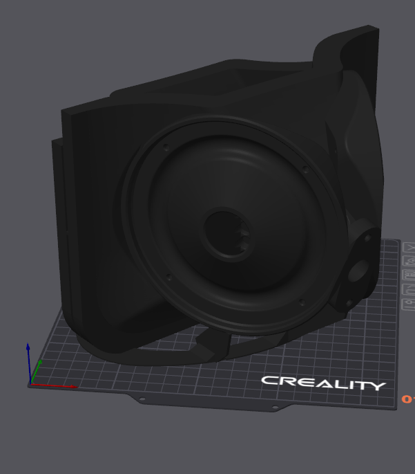

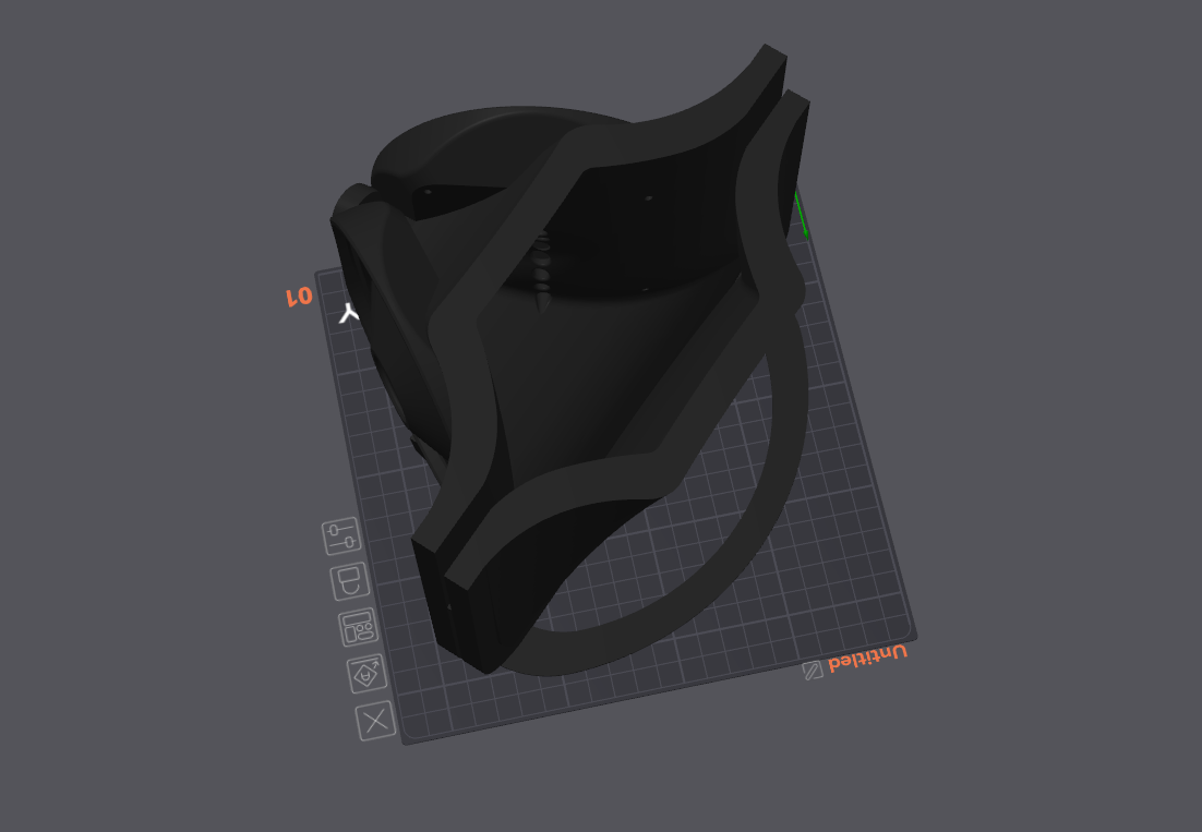

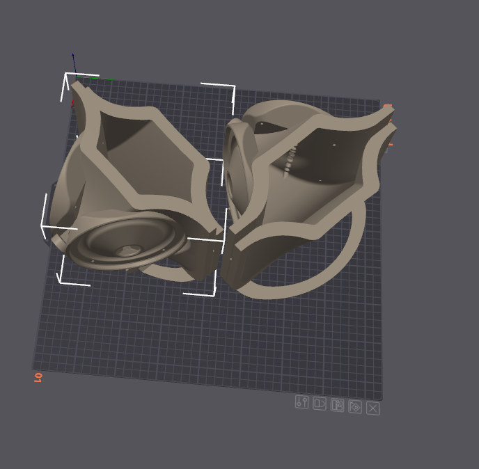

for those that are more visually inclined here is the print in slicer on an ender 3 bed
