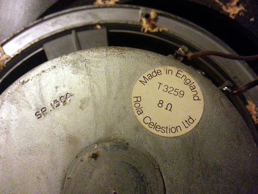

Please check attached image. Bass drivers I have had carved code SP1584 and labeled as T3259. I think we should check these codes. Also afaik, there is more than one kind of hf2001 tweeter exist.

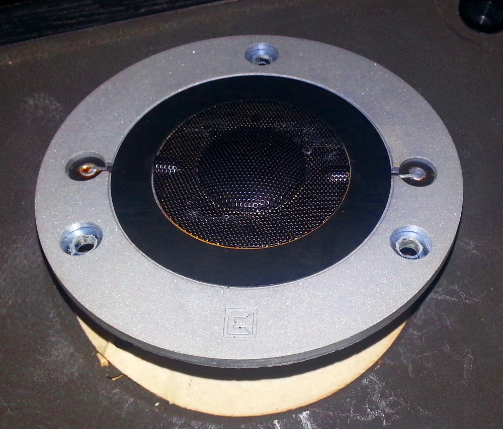

One thing still bothers me; Polarity issue is unclear for me. Still, I don't know if any driver needs reverse polarity connection. Do you have any info? Crossover driver connections are ok, but don't know if there is reverse polarity involved or not at the driver side.
Attached hf2001 pic. Any idea which side is positive?

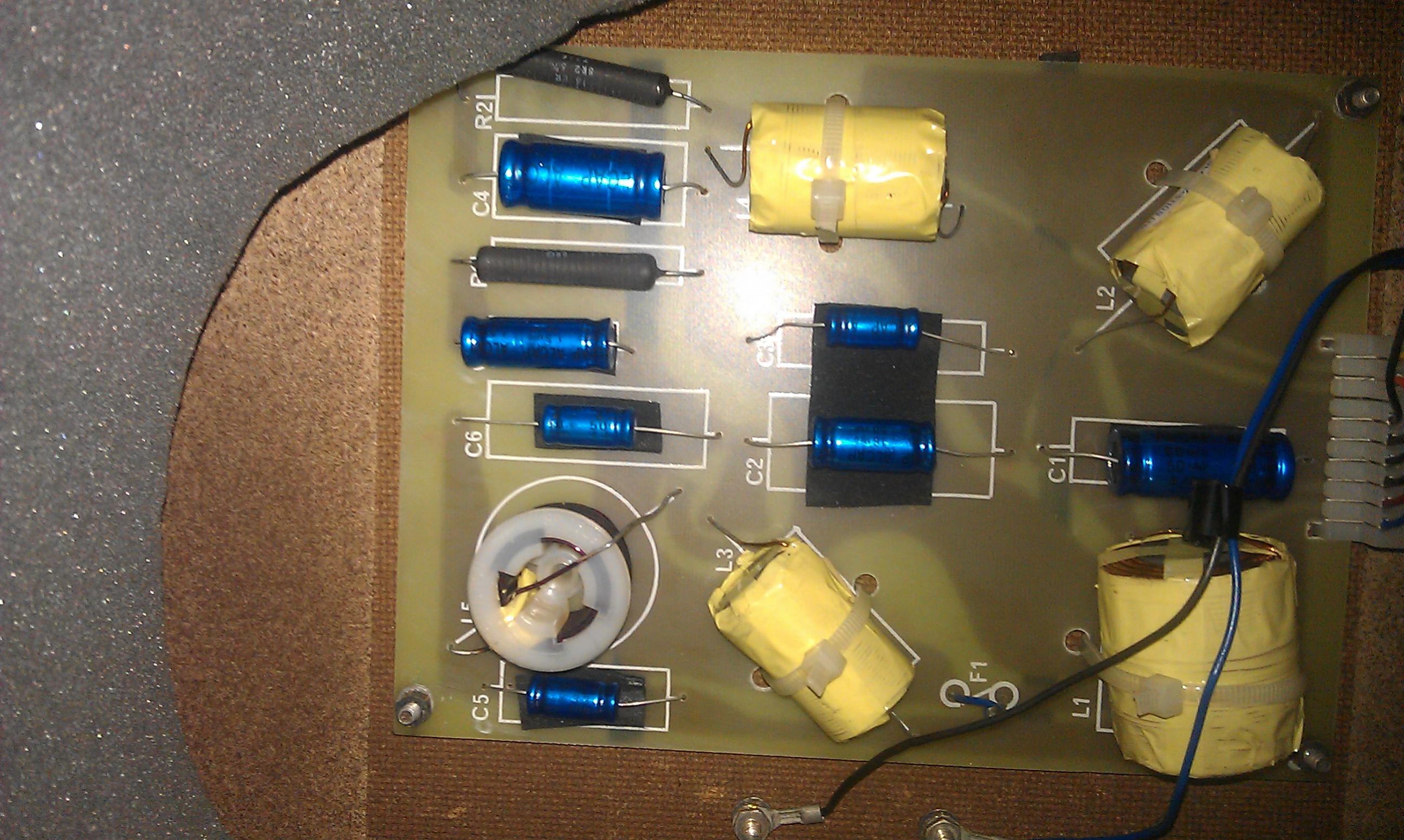

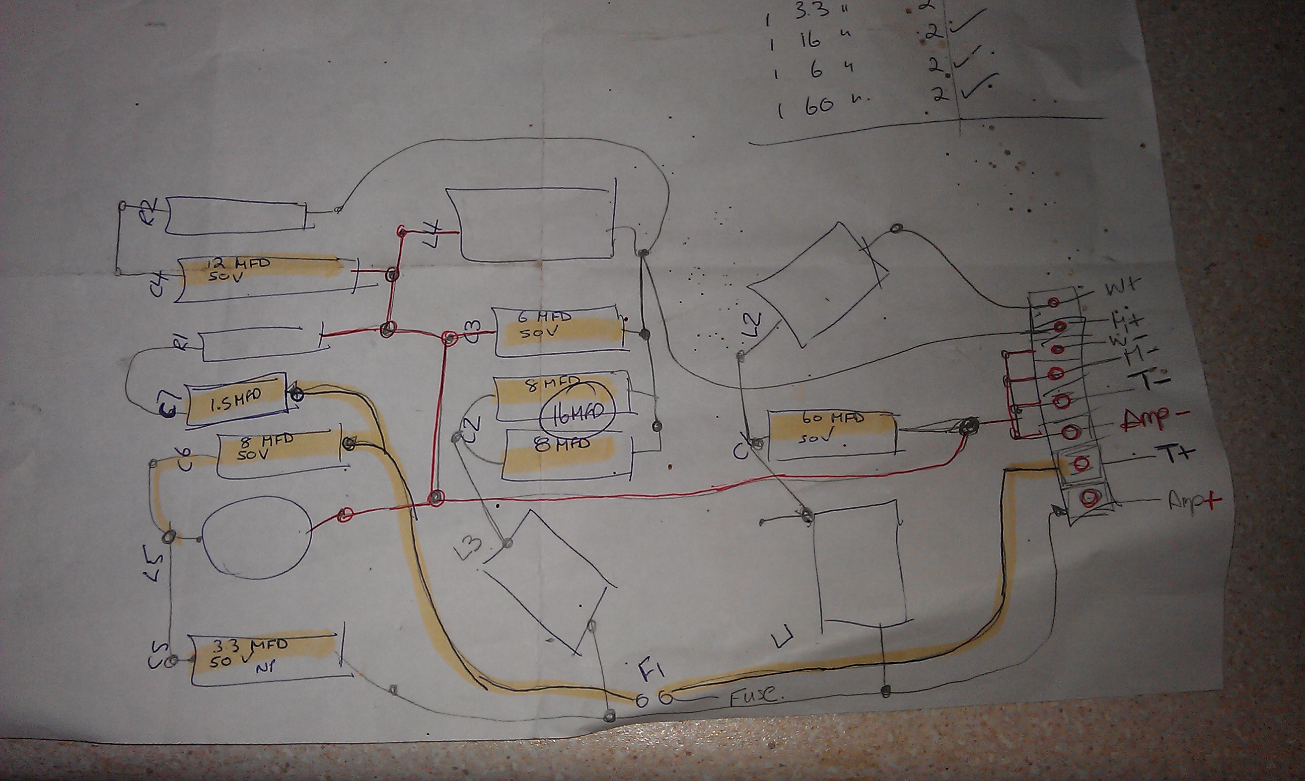

Hi , Just posting my sketch of my 332 crossover for interest of any one else. Also picture of old x-over and updated one.
Starbender do check the resistor for the tweeter as it can be adjusted for volume and may have been altered by the previous owner for a different tweeter .

Finally replacement woofers arrived (thank you so much Phil!). I also replaced tweeter caps and 60uf E.C. 8uf replaced with Mundorf EVO, 1.5uf replaced with Claritycap ESA. Removed 60uf electrolytics and soldered 30+30uf MLGO russian pio caps > bypassed with 0.1uf teflon.
Don't know which mod solved my HF output problem, but now I have beautiful and crisp highs!

Polarity of HF2001
About Post #32 :-
Thanks Phil.
See the remains of the Red paint or ink in the center of one of the connection circles -
that indicates Positive Polarity connection at that terminal.
The other side has what looks like a small amount of brown corrosion around the outer of the circular section ,
and that is the Negative Polarity side.
Use of Red paint or ink was a common way of indicating Positive Polarity , and it may still be for some Manufacturers.
Sometimes there was Black paint or ink used for the Negative Polarity connection ,
and with some of the very old drivers White was Positive and those usually had a Black for Negative also.
crossover schematic , and capacitors

The crossover schematic is interesting as it shows that Celestion have Tweeter connected in Positive Polarity
- in their previous Series of 3-way loudspeakers Celestion had Tweeters connected in Negative Polarity ,
thus there will be different overall sound characteristics with this later Series.

You didn't mention the 3.3uF cap in the Tweeter circuit. It should be replaced also.
Use ClarityCap: ESA or PX , or even PSA if you can't afford either of the others.
Russian K78 series are Polypropylene capacitors - there may be some in suitable values on ebay at prices not too expensive for the Midrange crossover.
Those old Black caps with Red ends are electrolytics and will be past the end of their safe working life now
- all should be replaced so as to not risk damage to the drivers in the 332 and to the output stage of your amplifier when those old caps develop more leakage current through.
