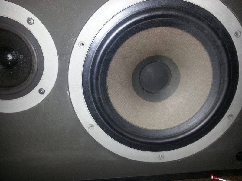

Last week I picked up busted 332's. I heard so many good reviews about these. Unfortunately one tweeter is not working and there is a burned resistor in crossover. I'm planning to make full maintenance including cabinets.
I'm searching for info since four days. Couldn't found any reliable information regarding crossover schematics. Is anyone have any schematic for 332's?
Also I want to try repairing hf2001 tweeter which is already down. So nothing to lose if I cannot find a way.
Another thing is I have a hard time to remove drivers.Looks like drivers doesn't glued, tight fitted, but i cannot remove them. I was able to remove two tweeters and one woofer. But I don't want to force the baffle. Any recommendation about this?

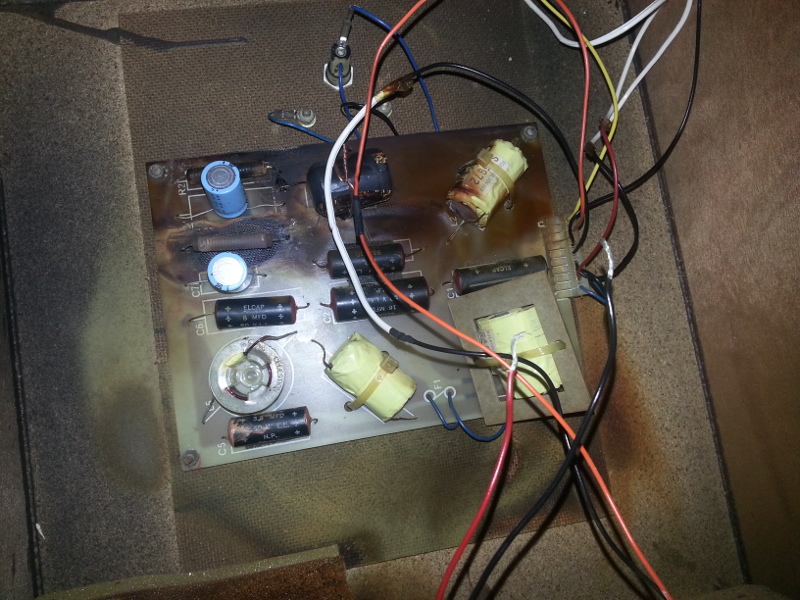

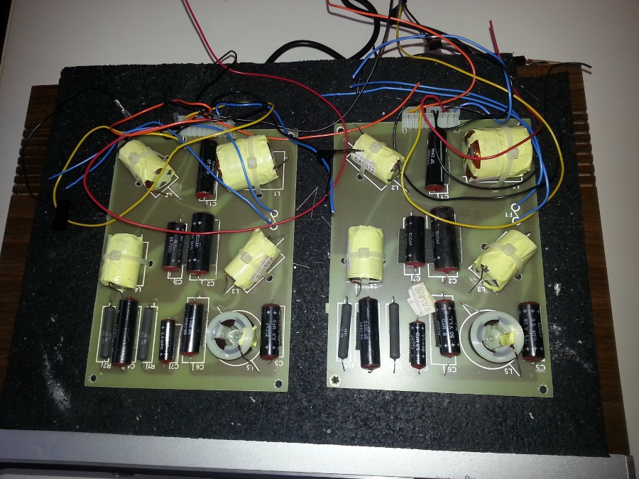

Here's damaged crossover with blown resistor. Btw, I have to find a way to remove drivers without damaging cabinet...

That's more than a blown resistor .... looks like a smoked cap and coil, or two coils. With that sort of damage, I'd suspect that more than the tweeter may be damaged. You might want to check if the midrange and/or woofer voice coils are seized (press gently inward at the junction of cone and dust cap ... if it doesn't move, then the coils are fried too)
There is no subtle way of removing the woofer. If you can reach inside the cabinet with sufficient leverage, give the back of the woofer magnet a good smack. If you can't get inside, then use something like a snap ring pliers with a substantial hook at the end that you can slip into the mounting bolt hole and give it a strong pull. No doubt you may get a bit of separation of the particle board they probably used, but it won't be catastrophic.

First I thought same as you. But other than smoked resistor all component readings more or less ok. I checked all drivers, all of them came back slowly as supposed to be. Without rubbing noise... Both speakers and all drivers are working without strange noise. Only one hf2001 defective which belong to damaged crossover..
Cabinet design is somewhat strange to me. Mid drivers have their own closed boxes inside the cabinet. There is no way in. I have to pull them straight without damage. To do this, I have to find something..
Update;
Succeeded to remove all drivers without any issue. Cabinets in sanding phase right now.

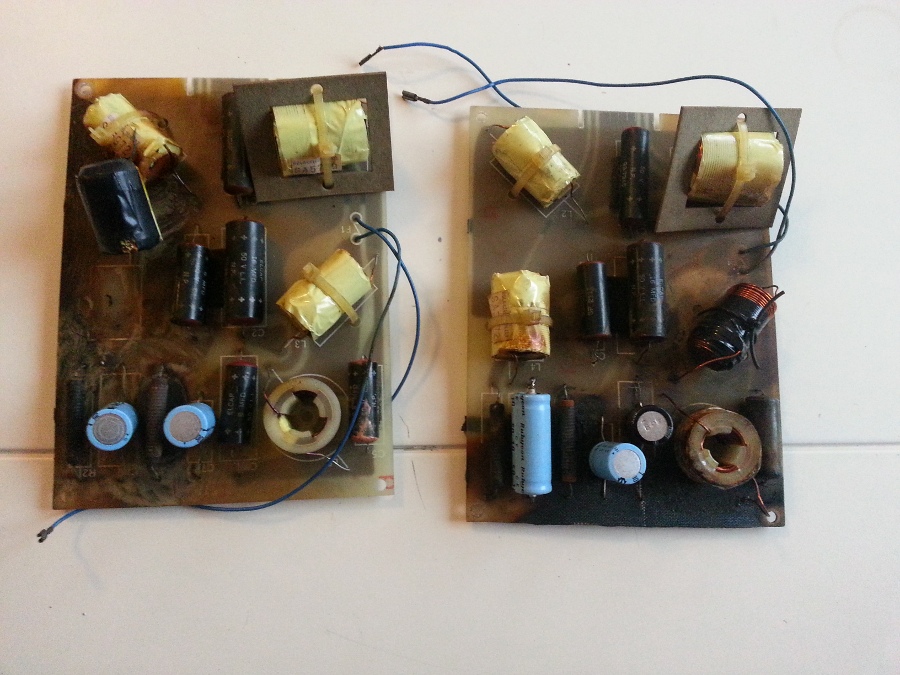

Unfortunately other crossover also in bad shape with replaced anonymous electrolytics.
Hopefully I found a pair of clean&working 332 crossovers.

I think you can work out these values with a bit of help and detective work. A diiton 332 crossover pictured here:
http://www.diyaudio.com/forums/multi-way/192202-new-seas-drivers-ditton-332-cabinets.html
That's 4 of the cap values I can see straight off. C4 is 12uF NP. Small C7 might be 1.5uF NP, not sure.
You'll need a good mutimeter with an inductance scale to measure your coils. Keep track of wiring polarity too. Here's a typical 3-way for comparison:

I think I could guess some values if you can draw up the schematic. Celestion did reuse a lot of circuits. Usually a 4th order bass and third order tweeter, but let's see. This is not an easy restore, but if you are methodical and make notes it can be done, I reckon.

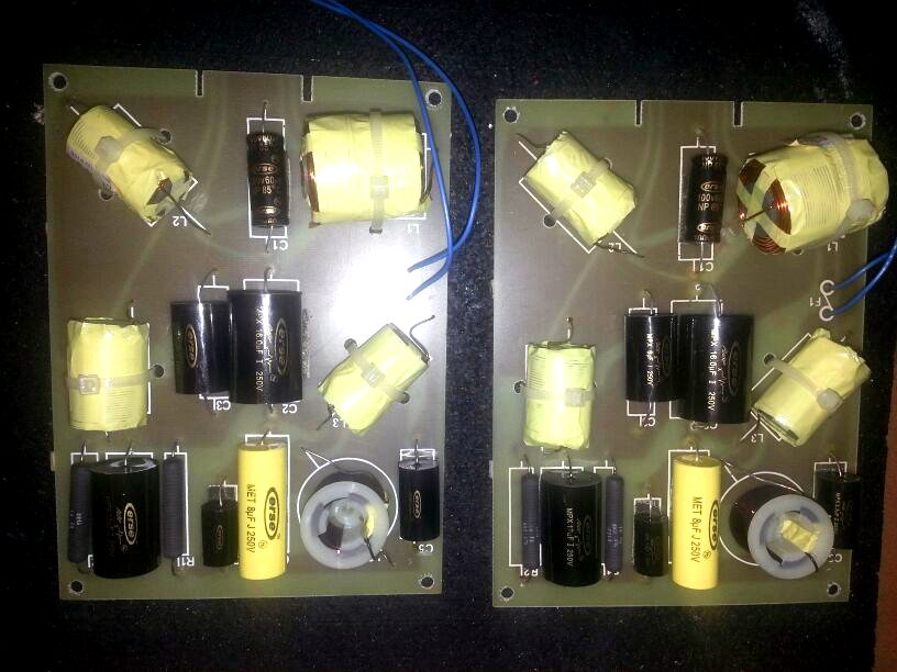

Thanks for your reply. I just received replacement crossovers for 332's yesterday. I don't have any difficulties about cap values. Problem is, i don't know which wire goes to which driver, or any out of phase connection involved or not. Check pics ;)

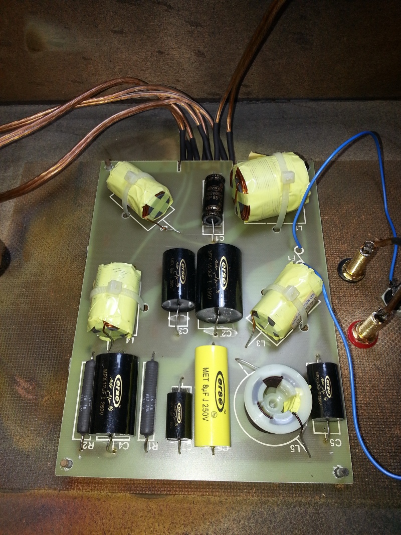

And total of 14 caps will be expensive. Especially with 60uf ones. Do you have any brand recommendation for caps? I used Clarity Caps ESA series in sw-156's with great results.
Note: If you check old crossover, someone replaced bipolar paper caps with electrolytic polar caps. Pity!

Last week replacement crossovers recapped. Replacement HF2001 is on the way.

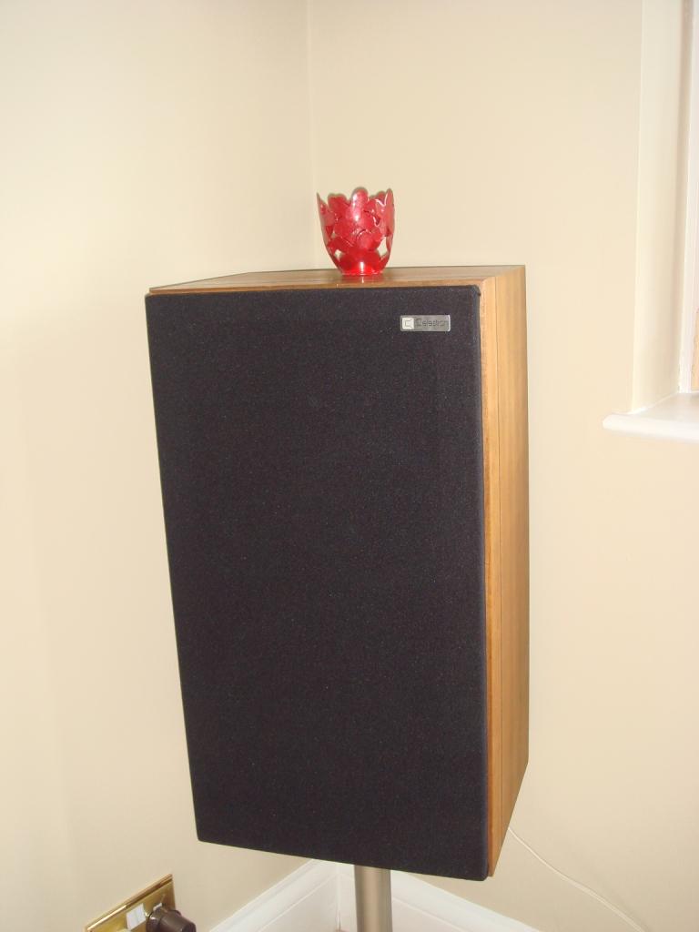

Ditton 332s - an unusual choice but strangely enough one I did myself a year or so ago . Replaced tweeters with SEAS , replaced caps and fully re-wired. Then rubbed down cases with wire wool and re-oiled - look like new now . Replaced the grille fabric with nice modern black. Also then built solid Oak stand at the specified height .
Unfortunately they were too big for the house (according to the missus) so now reside in the Garage ,so I have to listen to music through the TV surround sound :mad:
My Dad has 33s he's had from new and they sound great in his large'ish living room.
Attached a pic of them before case re-furb and new stands . Also have 2 dead HF2001s , 2 spare cases + 2 bass units .
