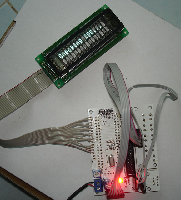

How do you connect the cable you show in picture? Looks like it's soldered...

Hi lestertrad
Yes,It's a separate PCB.Will together with the kit if someone need .
It's soldered.And I will go to find something for without soldered.

In this picture (attached) you show a cable. You say, "make a cable like this." Okay, but it looks like the cable is soldered. I'm asking, can't you use a connector on those pins?
I'm making a distinction between this cable

Hi lestertrad
Yes,the cable is soldered.On the picture,
It's the one I made before.Now I get the separate PCB for Double 7PIN to Single 14PIN.The separate PCB is the connector~

Can I just make a cable with 7-pin connector on one end and 14-pin connector on the other?

Can I make a cable with Double 7PIN on one end
and Single 14PIN on other end
to go from VFD display to 14-pin connector on kit board?

Hi lestertrad
Yes,have the numbers print on the LCD&Controller PCB.You just make 1 to 1,2 to 2,3 to 3,.....14 to 14 is Okay.
