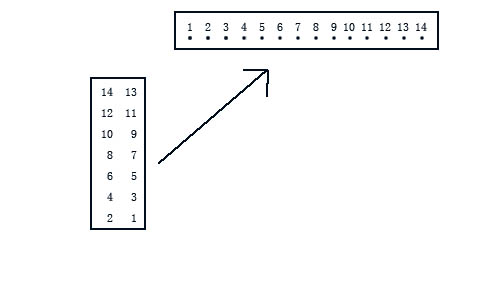

Hi Huang,
Like Lestertrad, I am also interested in a cable. It is a 14-pin IDC type connector, is that right? The problem is that when I search for this type of cable, the normal type is 2 rows of 7 Pins, like this:
And we need like this, in one row:
It is needed if we are able to place the display where we want it. Do you know where to obtain? I can't find it on Digi-Key. Is this a part you might be able to source and put in your eBay store? I think many people would be interested.

Yeah, Buck, I sure would like to find a connector like that, but slowgay seems to think the only way is to solder the 14 wires to the pins. But then he has a little PCB with the proper connectors on it... Seems like you ought to be able to get board-type connectors and solder onto the pins using shrink tube to cover the connections...
Our stereo is in an ancient carved cabinet. The wife hates for the door to be left open. But it has a large crack in a door panel. What I wanted to do was put the IR receiver in the crack in the door and put the display up on top of the cabinet so we can operate it with the door closed.
If you could get your hands on a single-ended cable with the right male (pin) connector end, you could desolder the pins from the board and solder the wires in there directly. A little bit of a pain, but at least that would get it to work.
I spent a few minutes on Digi-key and like I said, all the IDC type connectors seemed to be two rows of pins. I'll go back and take another whack when I have more time. It's easy to miss stuff in that giant book. One would think they would have what we need.

Hi lestertrad & Buckapound
Yes,I think the best way is one end of the cable is a connector,and the other side of the cable soldered.
But anyway I'll go to the electronic market to find a connector tomorrow.
