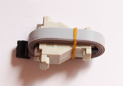

Forgive me for bothering you again, but about upgrading the firmware: Do we download the firmware update and flash the controller via a cable by running an .exe? Is the cable shown in the picture all that's needed? What interface does it use? My computer has only USB, SATA, and FireWire.

Hi Lestertrad
If you need to change the remote to the big one.
these software is good for download the fireware.
Ponyprog2000 , DownS52 , Atmel ISP-3.0
