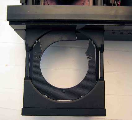

Lead sheets on transport
If you make it heavier, the resonance frequenty will drop.
The lower the resonance frequenty the better.
You get better bass with an heavy transport. And that's what we want. I did glue it with 'Bison Montagekit'.
I removed the small inside of the loader (See photo)
Look at the photo's of Mark Levinson 31 and 31.5
Huhh? If you do that, you'll definitely influence the resonance behavior of the sub chassis, don't you? How did you cope with that?

Thanks for your reply, PAM, and the instructive pictures. I will certainly give it a try.
What is you opinion on a possible disbalance in the way the 4 springs will react?
Perhaps a bit bold to compare, but if look at my spring suspendes Thorens TD-160, any change in weight division means careful retuning of the 3 springs... Or will everything be corrected by the servo?
Tell me when I talking nonsense, please😕
I cannot find inside pictures of those players, any suggestions?
TIA
Lourens

I don't see much advantage in damping tray, as it's not a part of a mechanism.
Re: Re: Lead sheets on transport
Peter,
A "loose" tray still can affect measured jitter from the disc. Depending on the CD player quality, that jitter may ripple through......
regards
Peter,
regards
