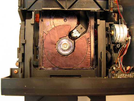

fezz said:
dampening the case (adding weight and cutting down noise) is one of the best mods that can be done to a player - i have doen that to a relitivly cheap CD play and it sounds completly different
totally agree - I have taken a used Cambridge Audio D500 ($250 on ebay) and have taken damping and isolation to the max. Recently I compared it to a relatively new Wadia 301 a friend brought over, and, well, I prefer mine...
It took just a few bucks in materials to convert this relatively average single disk player to a pretty awesome sounding unit:
http://didnt.doit.wisc.edu/audio/cdp/cdp.html

I work at Philips. My colleague was at a congress with the transport designers. They all agreed that the CDM 1 was the best transport Philips ever made.
So if you cab find a Philips CD 960 or Marantz CD95, 80, 12
you have definitely a very good transport.
I did a test with a Wadia 16 (TEAC ). With my CD 80 as transport it is better.
I made it heavier with sheets of lead.
