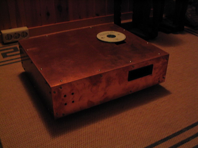

Well I have finally made it to the point where the housing is -almost- finished! All I need to do is polish it and put a laquer coating on it, and replace the scews with ones like torx or something.
I do have some questions about getting some parts in my housing:
how do I secure the cd pro mechanism to the top plate without the scews comming through the material?
My top lid -or upper caseplate- will hold the cd pro, My upper plate is about 4 mm thick, I don`t think I can cut a thread in there can I?
what about drilling holes with tread in the bottom to hold the transformes and prints etc. Will this effect the shielding? My housing is entirely of massive thick copper, will I spoil its charastaristics ?
How about rubber hinges for the prints? is it a good idea to have all the prints on rubbers or is it better to solidly attatch them to the bottem?
about the connectorsAnyone got advise on what cable to use for the connectors that are attatched to the cd pro? I use flatcable but that is not very good I think, Would silver wire be better? Or would that be nonsense and would normal awg 26 wire do just fine?
I have attached the old situation :whazzat: , and the new housing .
Well usually you could use a bottom Tap to thread some blind holes, but 4 MM is no where near enought material for that.
I suggest you make a frame that fastens to the bottom plate and secure the drive to that. I would be concerened about the vibration a 4 MM plate that large would tramsmit to the drive anyway.
Regards
Anthony
I would use shielded cables where possible, and remember if you are using the I2s connection the cable length should be less than 20 CM total.
Regards
Anthony
Tnx for the replies. Although the cabinet seems quite sturdy, u might have a point about vibrations to the cd-pro, caused by the lenght of my top plate.. I could use maybe a middle strut of something, that should make it a lill` better. Maybe even isolating the whole cd pro might be an option, by building a box around it`s underside connected to the bottem of the player...
The frame is a good idea, and I`m glad to hear that the bottom isn`t a concern with holes in it.
I will try to post some better pictures of the housing... 😉

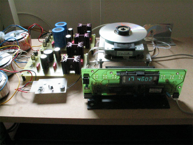

Here are my experiences with the CD PRO (with a few other persons we evaluated different mechanisms for developing a transport):
The mechanism of de CD PRO is very good, altough not as perfect as the VRDS NEO, but you can't buy these for a sensible price (and the electronics of the VRDS probably limits it's capabilities).
The laser is ok, but unfortunately not balanced, which means that focus- and tracking corrections influence each other more than neccesary. The corrections introduce jitter that can't be removed. A cheap Sanyo laser does this better.
The weakest link is the circuit board, and I guess it's almost impossible to modify properly. The clock can be improved but there are far worse problems on this board: the 4-layer layout and it's components.
Btw: I notice many people focus on the clock, but usually there's more to gain elsewhere (solving hf problems, power supply, layout etc.). Besides that: most clocks we've evaluated introduced new hf-problems, new jitter in other parts of the spectrum. I think "Plug-and-play" clocks are a gamble, proper implementation is critical.
