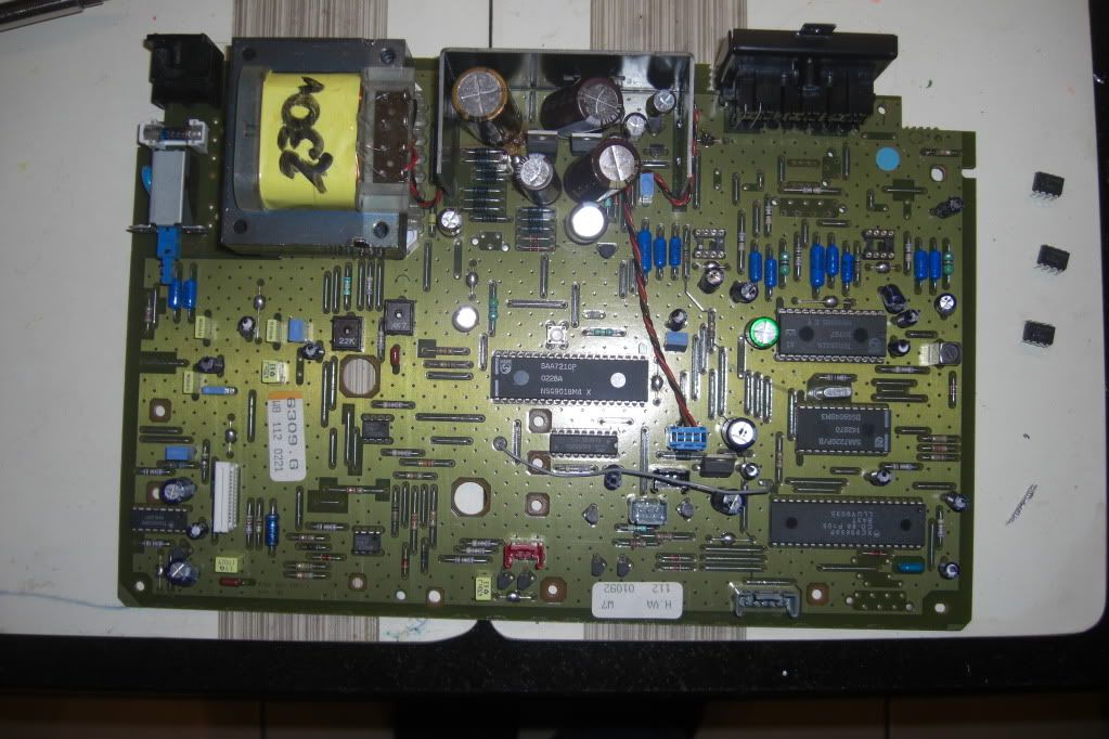

got one of the 2604s in (on the small pcb) and has really breathed fresh air into the vocals, and even better 3d imaging, loving this, just waiting for the other chips, for the two below the small pcb, then its time to do all the caps (electro only obviously)

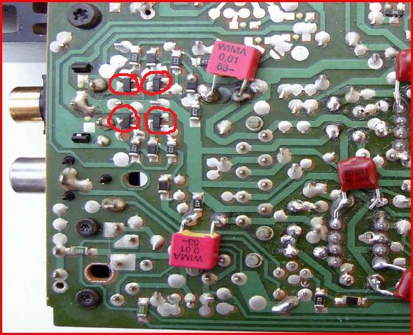

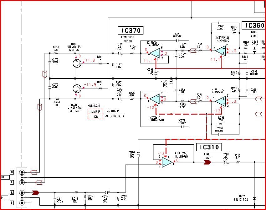

Something else occured to me on this player. How does it mute ? If there are no physical relays in it, then it will almost certainly use transistors to mute the audio by shorting the outputs to ground. It's common practice, but there's a lot of controversy as too whether this method creates problems sonically. It's something I've never investigated, my Micromega uses a relay, and my amp uses FET's for analogue switching.
The point is that there was a thread where this got mentioned, the player had an audio fault, and I suspected the mute transistors, which in the end were the fault, however stephensank recommended replacing them with FET's... and you could do the same if yours is similar.
http://www.diyaudio.com/forums/digi...sa8001-modification-eliminate-distortion.html
The best thing is to remove them altogether and see if you hear any difference bearing in mind you will get clicks at the start of discs etc without them.

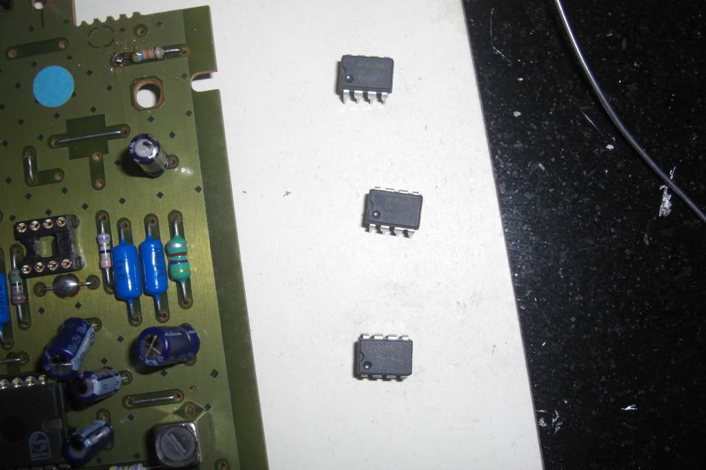

yea got the IC sockets and the caps neatly soldered on pins 4 and 8. When the other chips arrive, I will take some pics.

I'm guessing that it follows Philips practice of using bjts (ordinary 🙂) transistors and not FET's.
A close up of the underside of the PCB might help. The transistors may be surface mount types, but they will short the output to ground.
If in doubt don't touch 🙂
This is from a Sony Minidisc recorder... note the similarity to a CD player output stage. See the mute transistors at the left... when they turn on they just short the audio to ground... problem is it's not a "good" way to use a transistor... but it's cheap and it works. A FET is far better as it works entirely differently.
So if you can identify that area of the circuit by tracing the audio back from the outputs then you should see how the Orelle achieve it's muting. The transistors may be very tiny and soldered to the underside of the PCB and they could even be FET's anyway as it's an upmarket machine. A voltage chaeck on the base of the transistor in use would confirm yay or nay for that.
Fit your opamps first and think about this later... Just look and investigate for now I would say.

You can't tell by looking.
And I'm wrong there saying a quick voltage check would confirm. Some transistors have in built bias resistor networks so you can't get at the "base" to read the voltage on there directly... always ways and means though. And it's a Philips PCB, it's going to be "ordinary" transistors I bet.
It's just something to think on as I say... you mod the player with the opamps first 🙂
From the link in post#15
Philips PCB I have highlighted the mute transistors... all players follow a similar pattern... it's either transistors like this or a mechanical relay to short the signal.

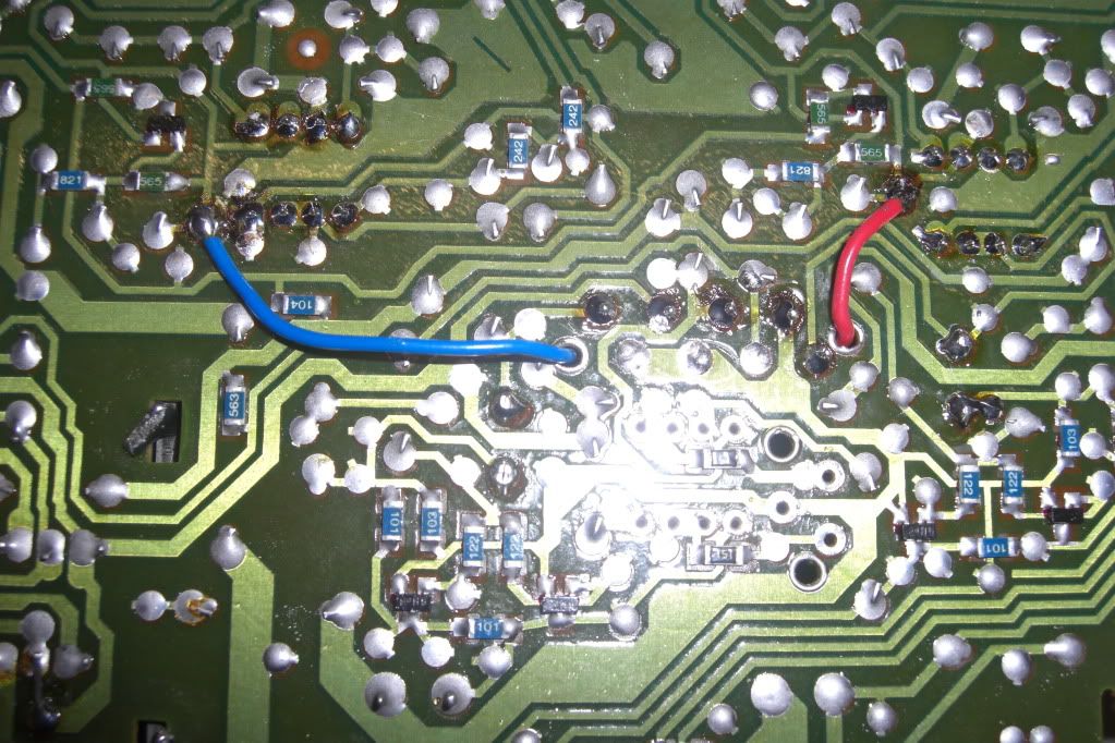

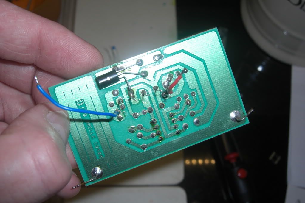

Think that I found the tiny mute transistors. Some pics below, what do you think?

All the Opamps are 4562s at the moment, but going to swap around the top opamp.

last pic, lot of flash, but can you see the small transistors (think that they are the mute ones) to the left and the right
It's looking good... see you have the small decoupling caps fitted on the IC's.
Be interesting to know your impressions of the LM4562 vs the OPA2604. The two on the main PCB have to be kept the same of course (left and right)

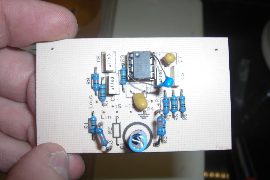

That add on PCB looks like it's used to replace an opamp that's not fitted on the main board.
Without seeing the whole thing it's a bit more difficult putting it all together. The four transistors at the bottom in your piccy (one off the right edge) are the mute transistors. They actually go to pin 1 ? (that I can see) on the unused chip and pin 7 ?
So does the output of that add on board feed into those points ?
The four resistors marked 122. It looks like the "top" of all those four join together... that's the mute on/off logic line for the left and right channel if so.
If you can identify on the top of the PCB the connection or link etc that goes to those resistors, then when the player is working you can measure the voltage on that line and see what happens and what voltage it goes to in mute and play etc.

I might try the 2604 tonight on the top PCB. The only trouble is, changing the lower chips, under the PCB means that I have to remove that PCB everytime, which is a little awkward.
