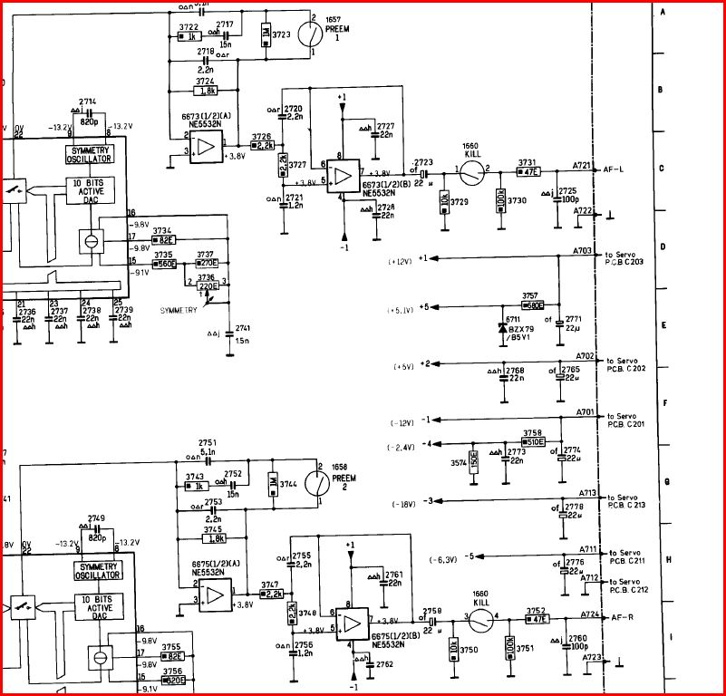

Here's the circuit of a Philips CD303 showing 4 opamps used in the analogue stages, these are NE5532 by the way. All the opamps are in use. Your player will be very very similar.
So four opamps are needed here for this design. They could have used four single opamps such as the NE5534 (look up the data sheet for pin outs) or 2 NE5532's which contain 2 opamps each.
You can also get packages with four opamps in each. so they could have used just one of those, but the choices are limited... not very good audio ones available in those.
So far so good... now, you can use any of those four opamps contained in the two IC's for any of the ones in that circuit... but it's logical when designing the thing to use one IC for one channel and one for the other. It's cheaper also to use dual IC's than singles, and it also takes up less space on the PCB. Remember each opamp (the individual one in the IC) is totally independant of the other. They only share the power pins.
It would be interesting on your player to see just how that extra PCB is wired. Does the output from that board, that's pins 1 and 7 of the IC go somehow to the output sockets ? Might go through a cap or two and a resistor etc on the way.

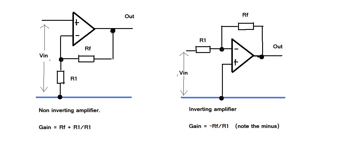

Opamps... crash course
Just the very basics, but it covers 99% of applications.
The opamp has 3 main terminals, two inputs and an output. The two inputs are labelled - and + or inverting and non inverting.
Do you understand resistors, and how to make up a simple divider using them ?
For example, two equal value resistors in series connected across a 12 volt battery would each drop (or have across) them 6 volts. If you made one resistor 11R and the other 1R then there would be 11 volts across one and 1 volt across the other.
It's just ohms law.
So have a look at the two opamps here.
The golden rule... an opamp with feedback (which is 99.9999% of applications in other words) will always try and make the difference between the two inputs equal zero.
Thats not the same as "making the inputs zero"... it's the "difference between" that is zero.
So the first opamp is connected as a non inverting stage. The input is applied to the + input.
The - input is connected to a resistive divider so it take a portion of the output voltage.
So if we put some numbers in, and lets say Rf =9R and R1 =1R.
That could be 9000 ohm and 1000 ohm or 9 million ohm and 1 million ohm... we are looking at the ratio of the two rather than the absolute values.
Remembering the golden rule, "keeping the difference between the inputs zero" can you see that if we apply 1 volt to the + input, then the output has to rise to 10 volts to bring the - input the same as the + thus maintaining the "zero difference.
If we applied -1 volt to the input then the output would have to go to -10 volts.
So with just one opamp and two resistors we have made an amp with a gain of 10... it really is that easy.
By varying the feedback factor which is the ratio of those two resistors we can make an amp with any gain we choose.
The inverting amp works in a similar way. Lets say R1 is 1R and RF is 10R.
If we apply 1 volt to the input, then the output has to go to -10 to keep the difference between the inputs zero. The output is inverted (-) Apply -1 volt to the input and we would get 10 volts out.

That is brilliant, you have explained that perfectly, I understand. Thanks Mooly.
I like to know what bits do what, rather than just changing them hearing a difference, and thats that. I think its almost rude not to know, even the basics, you guys have been so helpfuly, that I at least want to respect and understand what I am doing, otherwise what have I learnt, nothing, only to pick someone elses brain for nothing, if that makes sense.
