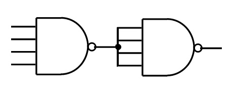

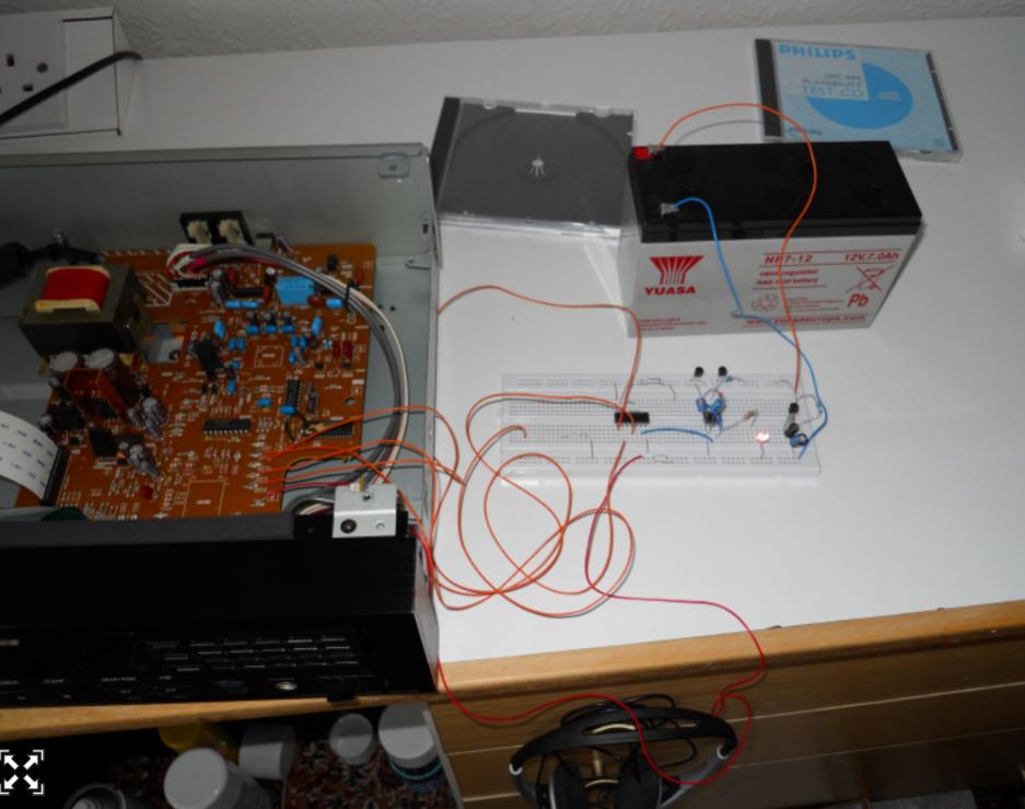

Been having another look at this and its quite interesting. I knocked up a pulse stretcher and this confirms that the data lines that appear to have no activity viewed on a scope actually do have occasional data present, and of extremely short duration.
I can reliably detect when errors are occurring but I need a true AND function to check against the data sheet truth table. A couple of things are bugging me at the moment with this so it needs a bit of thinking through. I could only lay hands on a NAND 4 input gate... I know I can make a AND from NANDS... but something isn't quite right as it stands.

Edit : - ooops just found it in post #21, kindly ignore my Q. You prob know this but MNT0-3 are only valid on the falling edge of C4M, so need to use a register clocked by C4M neg edge to sample your AND circuit and arrange to latch and hold its output if MNT0-3 are ever all 1. I get what you say about MNT0-3 apparently never being all 1, but those states are transitory and not easy to see, hence the latch........?

I've had chance to have more of a look today... it all makes more sense when its in front of you and you can get a feel for what is happening however there is a puzzle.

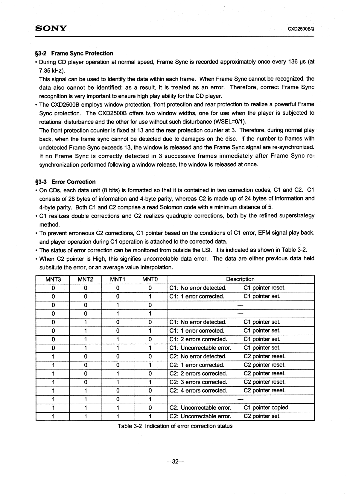

Looking at the truth table and taking the data at face value we should see all error flags at logic 1 when a non correctable error is present. This is the last entry on the table. Using a four input NAND to detect this and feeding the output to a monostable shows this situation never occurs under any possible condition.
Also, I wondered at the meaning of the phrase 'uncorrectable error'. The first entry for this refers to the C1 data. So does that mean it is simply a non correctable C1 error that may be corrected by applying the C2 data and thus outputting a correct sample ? When we get to the last two entries in the table (both classed as uncorrectable) are we into the realm of substituting previous data samples and then moving toward average values of data for the final most severe uncorrectable sample/s.
Even with all this doubt there is still much that can learned from looking at the behaviour of the flags. One useful tool in addition to the monostable is a high brightness LED, a Cree device of the kind that burns your eyes out at 50 paces when fed from a couple of milliamps. The monostable shows the presence of a pulse or change of data but gives no clue as to how often this occurs. The LED comes into its own here. For example playing a 'perfect' disc it flickers very very dimly at around (guestimate) 5 to 10 random pulses a second. This is only present on the MNT0 line for 99% of the time, however monitoring the MN2 line shows a very occasional one off pulse. These must be true random errors form whatever reason.
I'm going to look at more detail at what happens when playing known defects (it all seems to behave as you would expect with the exception of the MNT3 flag)
Just need to take care that the min pulse width nec to trigger the monostable is met, because strictly the condition is perhaps only valid for a very short time synchronous with C4M a 4MHz clock. Might only be valid to meet setup and hold of one c4M edge.........it's worth using a D-ff or J-K ff clocked from neg edge of C4M to either extend the condition to be at least one C4M period long (250nS), or some other arrangement to latch it. Sure you know but at 4MHz need to take a bit of care with layout and transmission of sigs, of course.
I think there is a 'pointer' or flag for C1 and C2 errors, and a status flag for successful correction. The final two states represent pointers and flags for uncorrectable errors, the pointer happening first - but both will happen in sequence (being uncorrectable).
