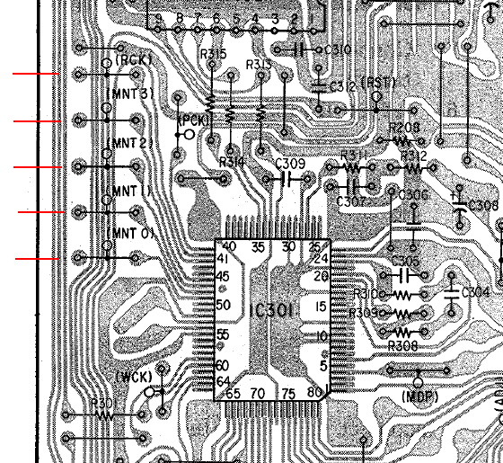

BTW, Moooly, your CD player is perfect candidate to become a CD quality control machine - it has C1 and C2 error monitoring test points on PCB!
See PDF p.32 for description

I looked yesterday at the CXD2500 pinouts but couldn;t see anything useful. The main micro does have a 'defect' output, but that is only used to alter the servo gain.

Mooly, you will need some glue logic to monitor for specific conditions (see table in CXD2500 datasheet).
Four input AND gate will do to see when all four pins MNT0 to MNT3 are high (uncorrectable C2 error).

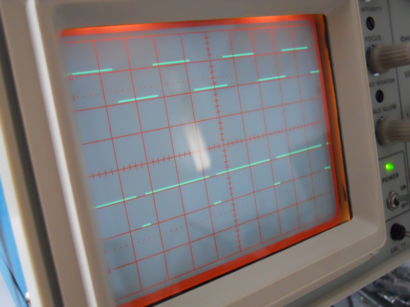

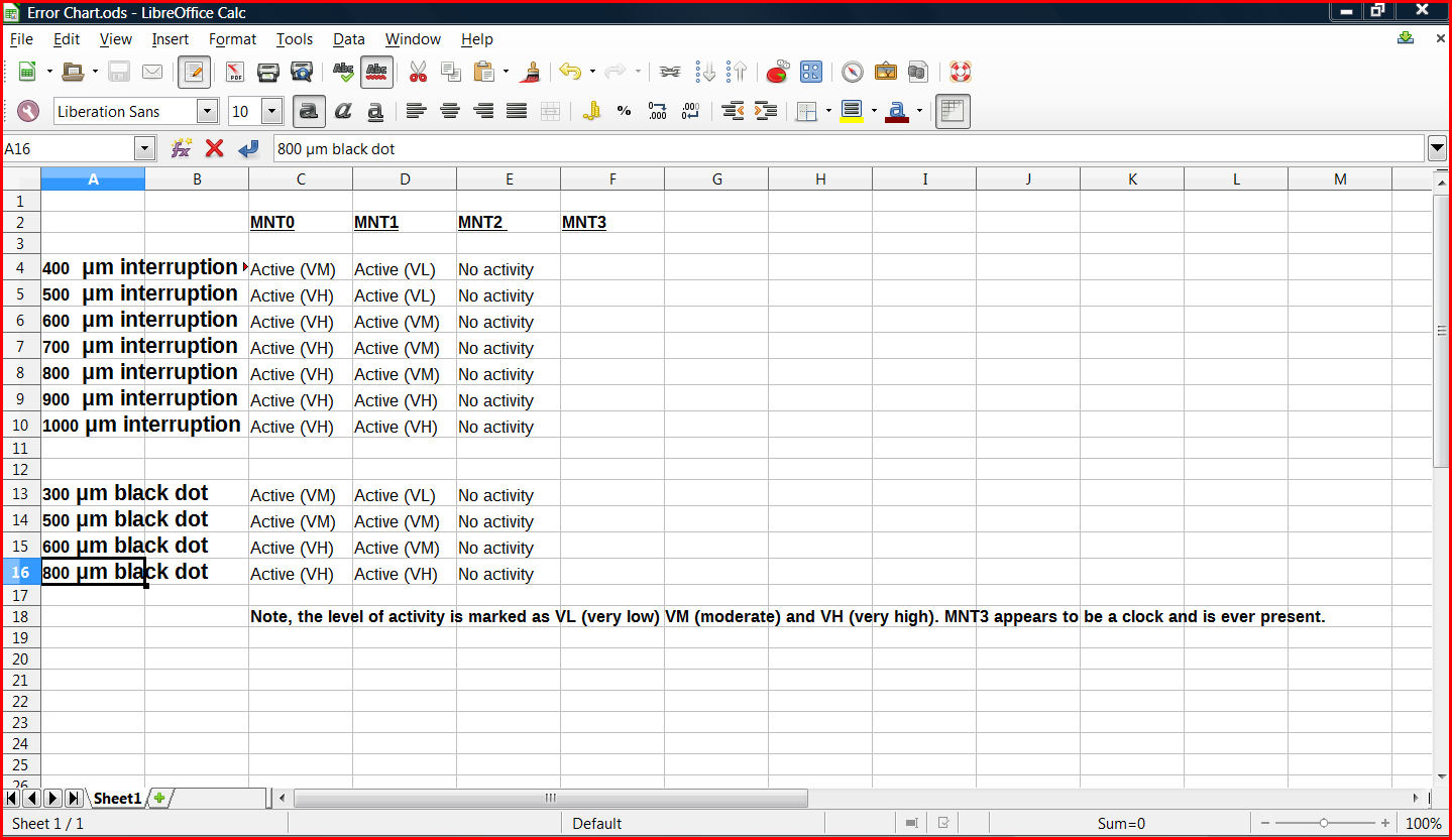

I thought of knocking some monostables together to stretch the pulses but I've come up with a modified disc that sends the MNT2 flag crazy when viewed on a scope. MNT3 flag is an ever present clock signal, its there even in stop mode.

Are you sure you're monitoring the correct test points? There are 5 that are close to the PCB edge and parallel to each other (marked red in my attachment). One of them is RCK 😉
All clearly marked. RCK is the top trace here and MNT3 the lower. They are unvarying whether a disc is inserted or not, or playing or not.
Edit, they are 7350Hz... frame sync.

New Files, Real Time Playback, these should be uncorrected errors
This folder contains two tracks, one made with the large sticker in the pictures above obliterating part of the disc. This sent the monitoring flags crazy. The other file is with the sticker removed and the disc cleaned.
I've called these uncorrected errors beause I'm pretty certain they must be being interpolated at this level of missing data. Constant activity on the MNT3 flag points to that.

You seem surprised that the correlation was so good with X and Y. As I have found out today, these errors on the test disc appear to be fully correctable by the error correction system, in other words bit perfect just as the original.
So at that point we seem to be saying that the error correction is having no audible effect even down to the servo not showing its hand by modulating supplies or injecting anything into the signal grounds.
The two additional files in post #34 (UC1 and UC2) have what must be interpolated data present. The player is masking the defects well audibly but I suspect those files should show a difference.
