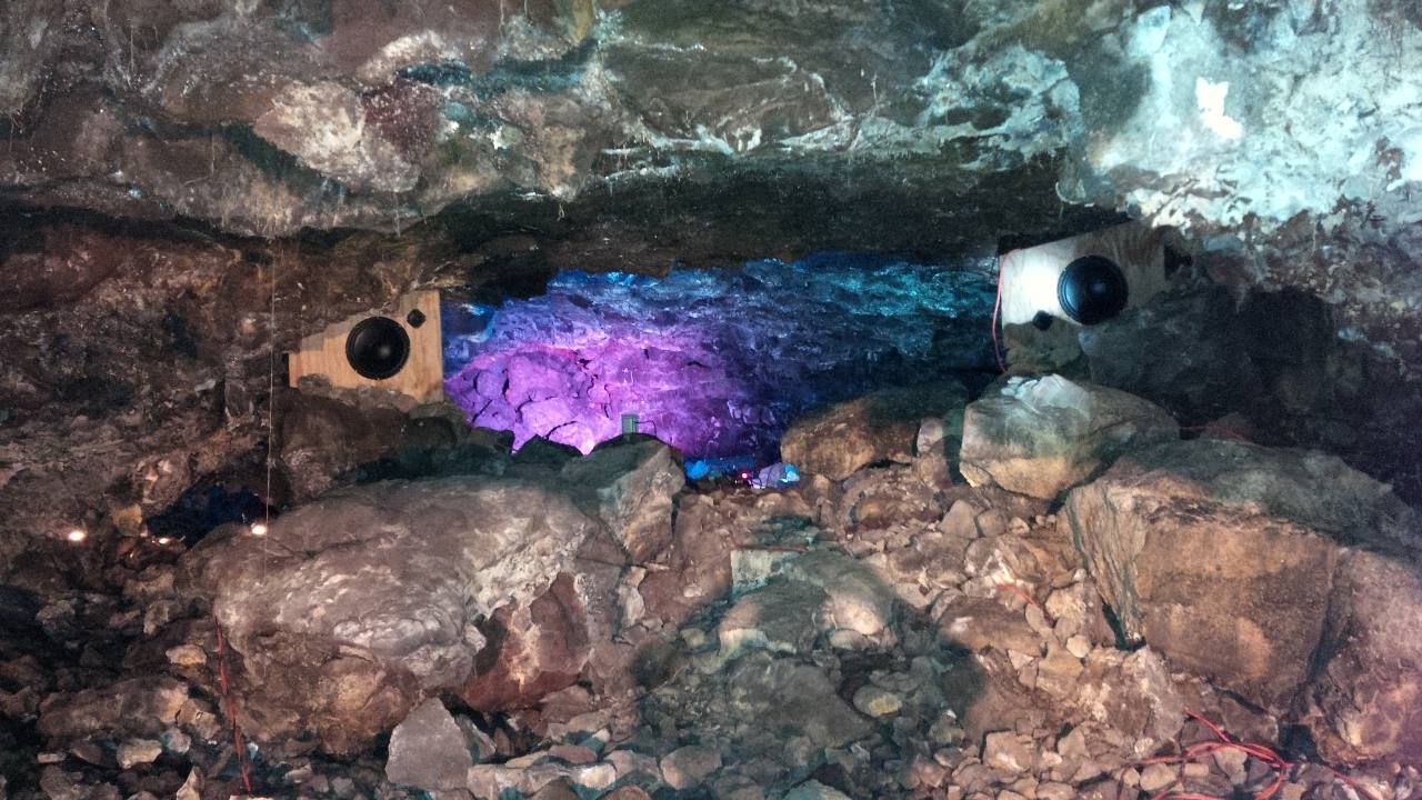

The wall behind the speakers is approximately 35' (10m) distant. It's hard to photograph, but I'll give it another try. It's all basalt lava stone and very irregular. It reflects, but in a highly chaotic manner. I've looked for the reflection signature in my measurements, but have not yet found it. If it's there (it should be) it's chaotic.Pano, is the front wall absorptive? If so, strange indeed. If not, its the doubling of distance of that reflection.

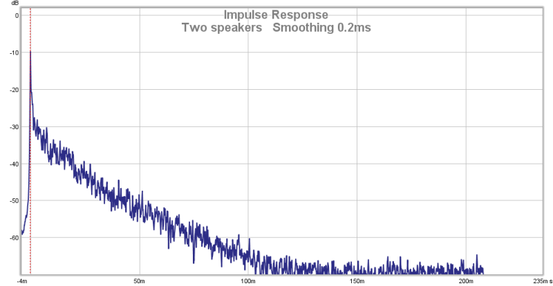

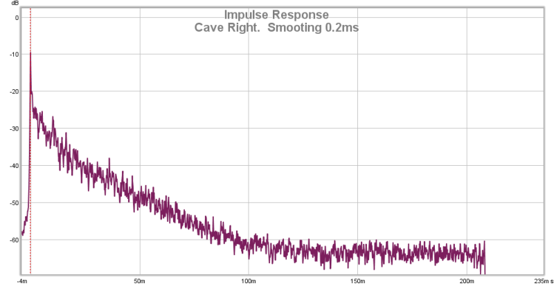

Can you post an ETC plot of the room? I expect it to act a bit like an ambechoic room from what you describe. I'd love to see that ETC.
Ambechoic would look like this:
Just saw your response in the other thread. Hypo echoic 🙂.

Shape looks about the same, but it is down almost 20 dB after the main pulse this time.
It is a very gradual decline after that, so it does look like ambechoic with the only difference being the level. True ambechoic would ideally be down 30-35 dB. The most striking thing is there is no flat ridge after the pulse, Only a steady decline.

Nice cave you have there! I'm officially jealous!

Hey thanks. 🙂 It is a dark, dirty, damp hole in the ground, but it has great acoustics. It was darker and drier when I first moved in, but recent rains and the irrigation of the new grass above have made it much wetter. I've been adding lights to it bit by bit. And it is soooo quiet down there. I love the pure silence.Nice cave you have there! I'm officially jealous!

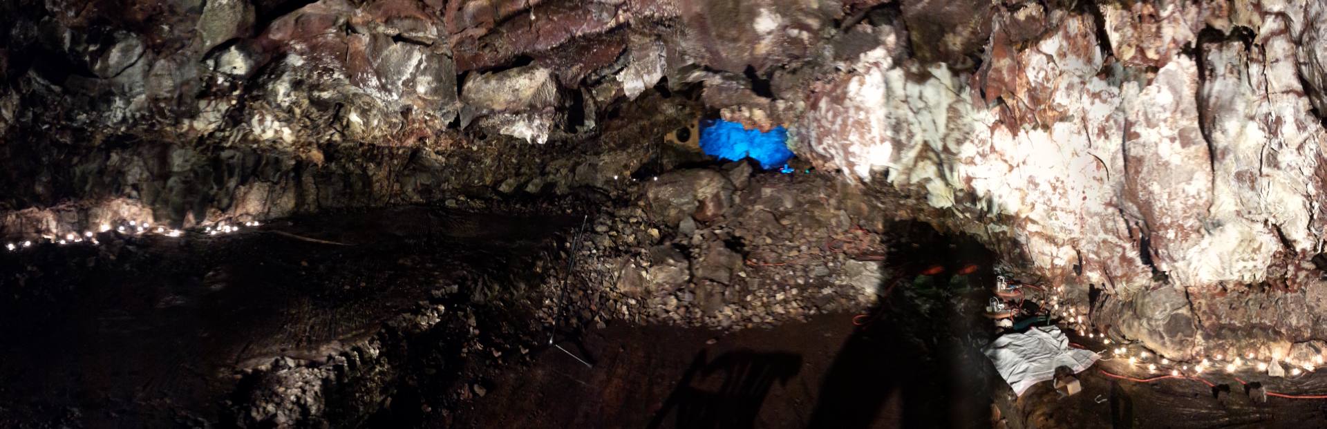

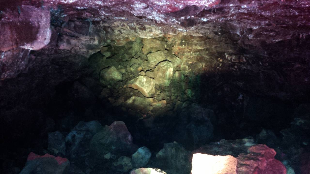

Here are some photos I took tonight. The cave is hard to photograph, but I'm learning how.
You can see a wide panoramic mode, then a photo of the puka (hole) where the speakers reside, behind that hole with the colored lights is the rear chamber. The rear chamber looks flat in the photo, but it's actually sort of oval shaped, about 35 feet (10m) to the back wall. You might see the shadow of the chair at the LP. It's 26' back from the speakers with another 20 feet of space behind that.
What you should be able to see well is how rugged and uneven it all is. Reflections die very quickly in there. It's possible that some of the lava rock in absorptive, but mostly is the jumbled, chaotic nature of the space that gives it the interesting hypo-echoic acoustics.
