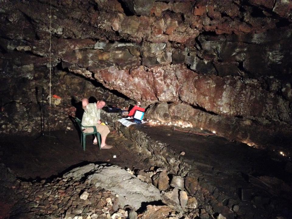

Back in the Caverna Magica
We had a LOT of water this summer and the cave became much too wet to use.
It's finally dried out enough to put the speakers and electronics back in. Same old goofy stuff as before. Need to work on my crossovers. At the moment it's just a cap on the tweeter and a coil on the woofer, and that's not working right.
And although the cave itself is very humid, the sound is very dry. RT60 is about 130mS across the whole spectrum. That's very short for a room this size. It's approximately 70'x22'x8' divided into two chambers. As you can see, there are some flat surfaces, but no parallel surfaces. The rough, chaotic nature of the walls does a great job breaking up the sound. Although it's all hard surfaces, the reflections are highly uncorrelated. Makes for interesting acoustics. Quiet down there, too.
Can't see the speakers in this photo, they are on the half wall beyond me, where my shadow falls.
