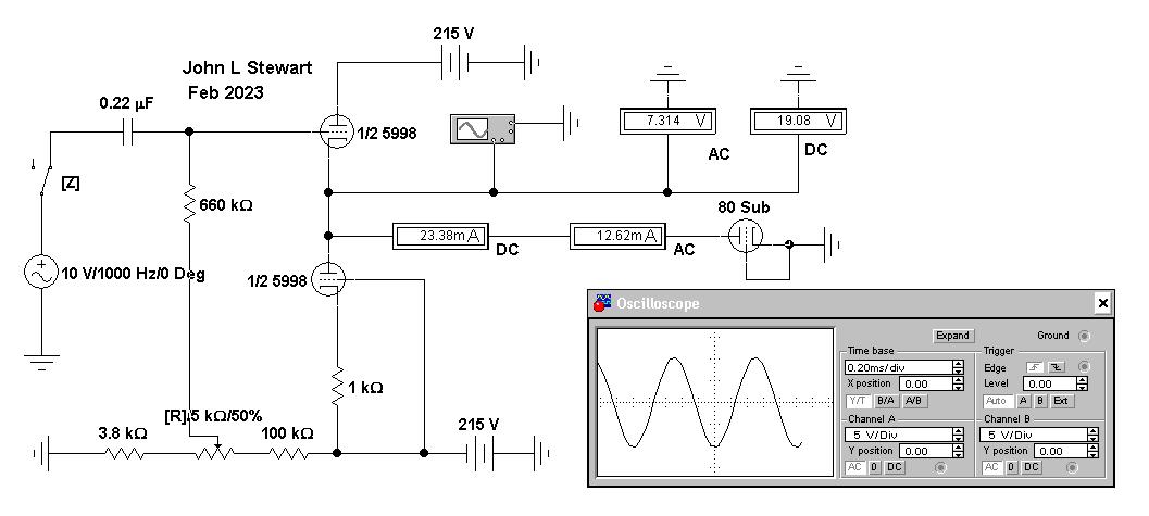

Note the peak grid current runs 50mA+/-. Can the dual-triode pass that much?
Here is what looks like a good start on that, Doesn't need to be 50 mA all the time, just on peaks,
I'll try a larger signal later.
The EWB simulator was developed long after toobz were out of style. So no vacuum diodes.
But the workaround is no problem, simply cause a triode to think it is a diode.
Stuff in the required parameters & a good diode with 3/2 halves curve results,
This one looks like one plate of an 80, 125 mA at 60V.
In the sim the voltage on the diode has settled very close to the required on the 811 schematic.
EWB has problems with positive voltages on the grid with respect to the cathode.
See if I can come up with a work around later. 😀

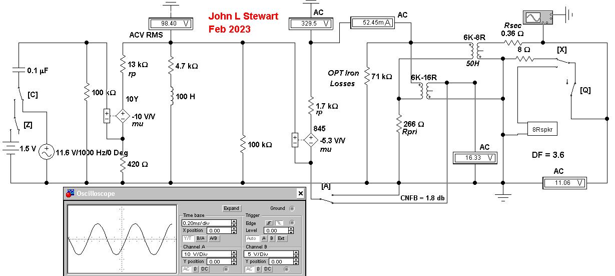

For the fans of the 845 & 10Y here is just that. I've assumed an efficiency of 85% for the OPT,
split between the iron & copper losses. All stuffed into the Sim. About 15,5 Watts of the signal get to the load in these conditions.
For the SE 845 in Class A all of the conditions listed on the data sheet shew efficiency of ~25%.
