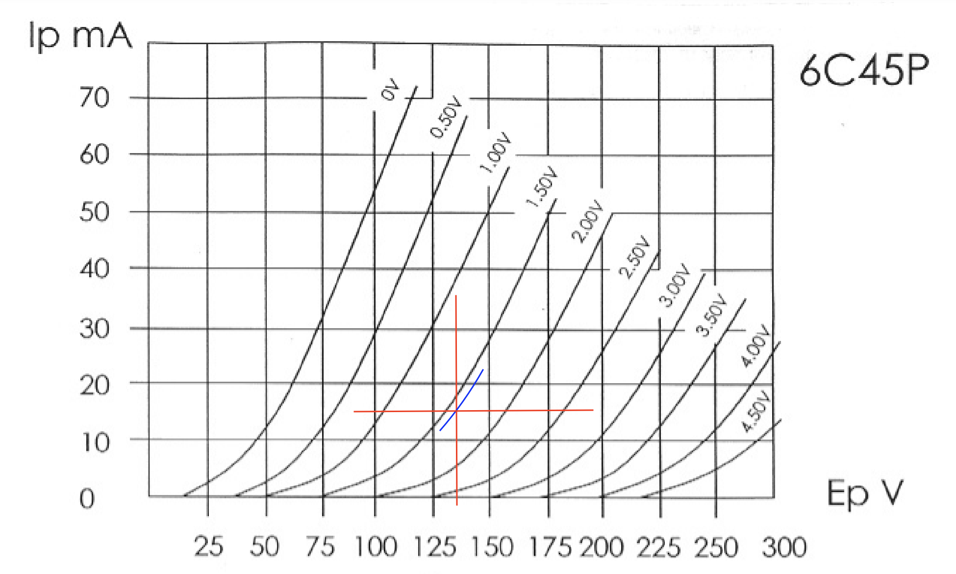

from recollection I measured it at 100R in the board, but I suppose my memory could be flakey!
I have measured the resistance from 1>3 and 1>6, 1>9 etc and the resistance is in the region of 51-58R
All measurements are at the valve base with the valve removed.
by my logic this looks like the 24R are in the region of 25-28R (they are currently 1/4W Allen Bradley that do wander...
As these are all with the valve removed then with the Valve back in place its 107R Cathode to earth.
I guess this means I am running at 15mA Bias

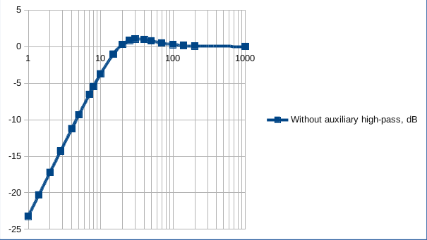

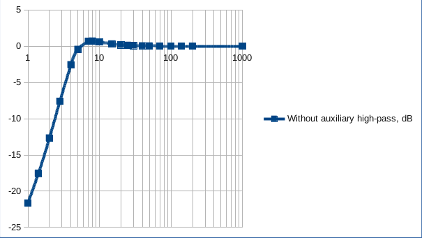

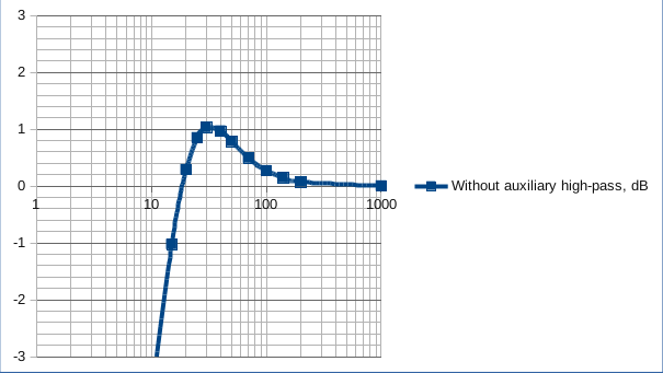

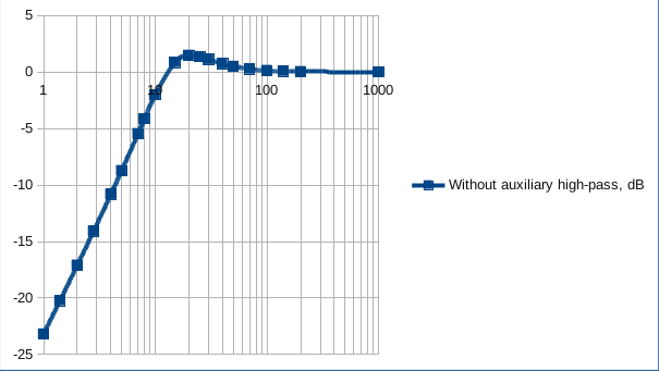

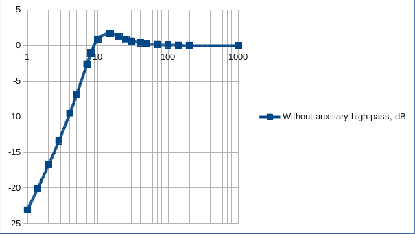

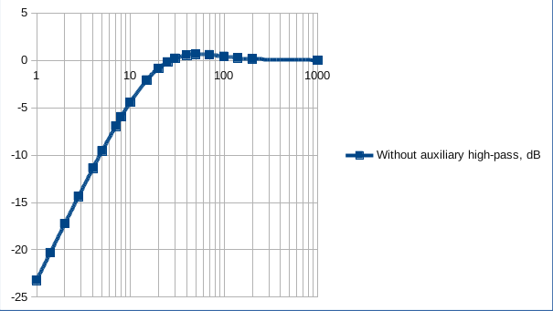

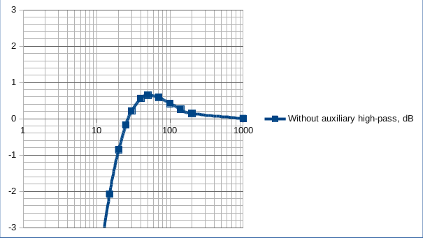

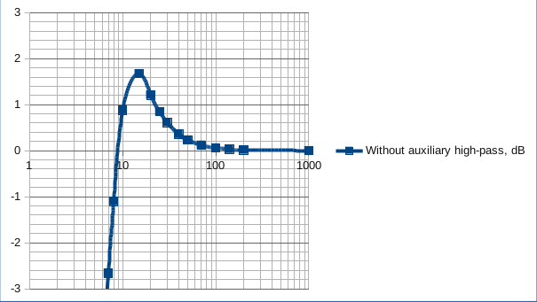

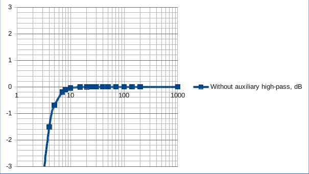

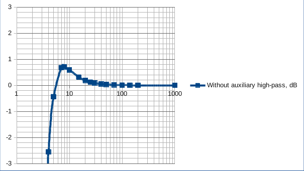

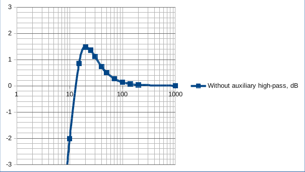

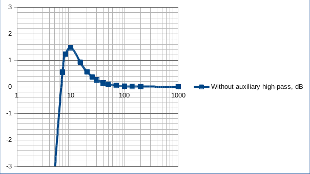

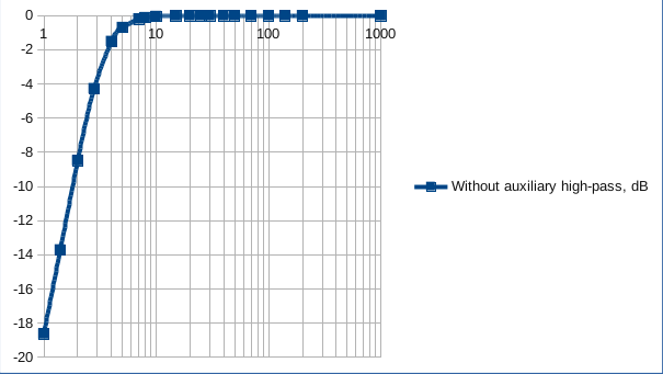

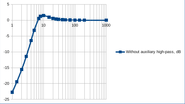

Recalculating the transfer, without auxiliary first-order high-pass filter:
Assuming that the transformer is indeed an LL1660/18 mA connected according to Alt S, the inductance is theoretically 79 H. I will round that to 80 H because the DC current is a little below the specified value.
The capacitor appears to be across the 100 Ω, and there is about 7 Ω undecoupled between the capacitor and the cathode. The valve is biased at 15 mA. Its transconductance is specified as 45 mS typical at 40 mA.
If the valve follows Child's law, its transconductance increases with the third power root of the current. Reducing the current from 40 mA to 15 mA then reduces the transconductance from 45 mS to 32.45 mS. The undecoupled part of the cathode resistor gives some series feedback that effectively reduces the transconductance to 1/(7 Ω + 1/32.45 mS) ≈ 26.44 mS.
Filling in the updated cathode resistor value (100 Ω, the part that gets decoupled), the updated inductance and the updated transconductance and trying all E3 values from 22 μF to 2200 μF for the decoupling capacitor, my spreadsheet gives these plots:
22 μF:
47 μF:
100 μF:
220 μF:
470 μF:
1000 μF:
2200 μF:
Take your pick...
22 μF:
47 μF:
100 μF:
220 μF:
470 μF:
1000 μF:
2200 μF:
Take your pick...

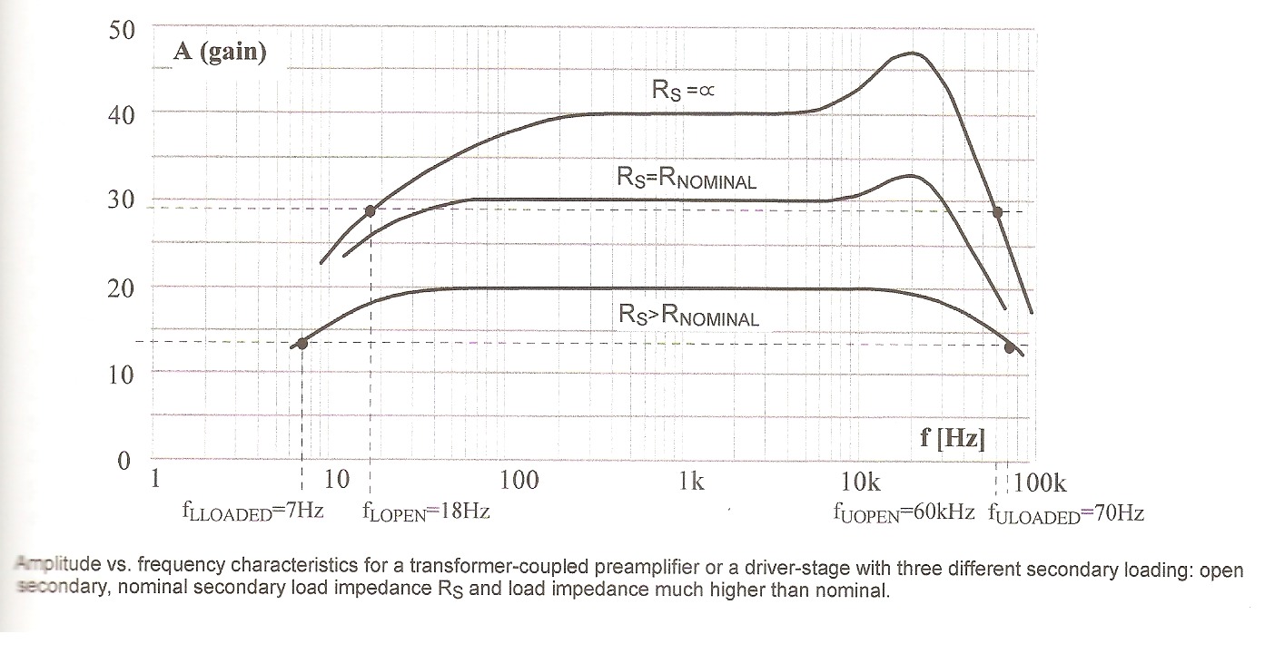

Try to recalculate it with loaded secondary (as about 20k secondary load transferring to primary side).
LL1660 has -enough large- bump at HF without Zobel, or appropriate load.
In these case even few hundred uF may "enough".

There is some information about high-frequency peaking in the datasheet tonescout linked to, https://www.lundahltransformers.com/wp-content/uploads/datasheets/1660.pdf , but it is very incomplete and unclear. Jensen usually specifies some RC network that prevents peaking, but this Lundahl datasheet only says:
"The source impedances used in
the tables indicates a recommended
upper limit, unless freq. response can
be compromised.
At lower source impedance resonance
peaking will occure. It can be
reduced using secondary load resistors."
