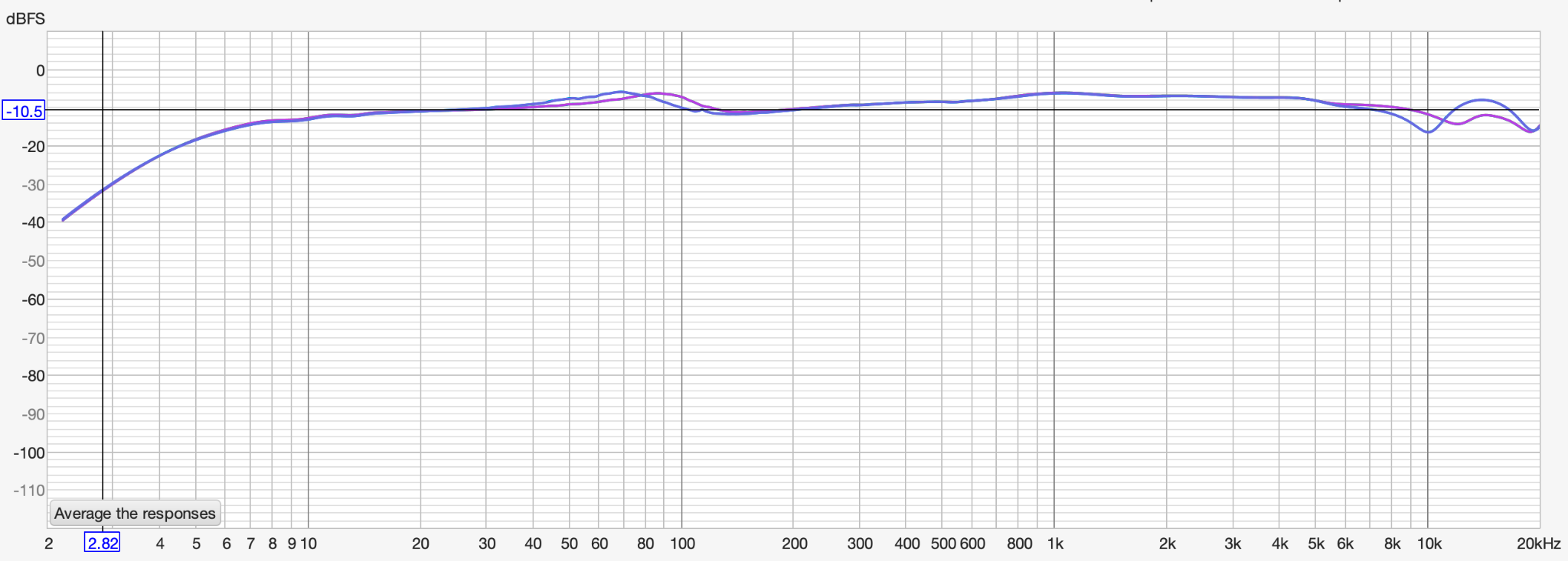

I have measured the existing 211 using REW. Here are the results, so it seems a reasonable frequency response overall in the bass, considering this is for music listening.
Both channels L+R shown.

yeah it does look a little, I will try with an 8R load resistor and see how this looks, not sure of the impact of the speakers. I was really only looking at the roll off at low frequencies. There is also somethign strange going on at higher freuencies.

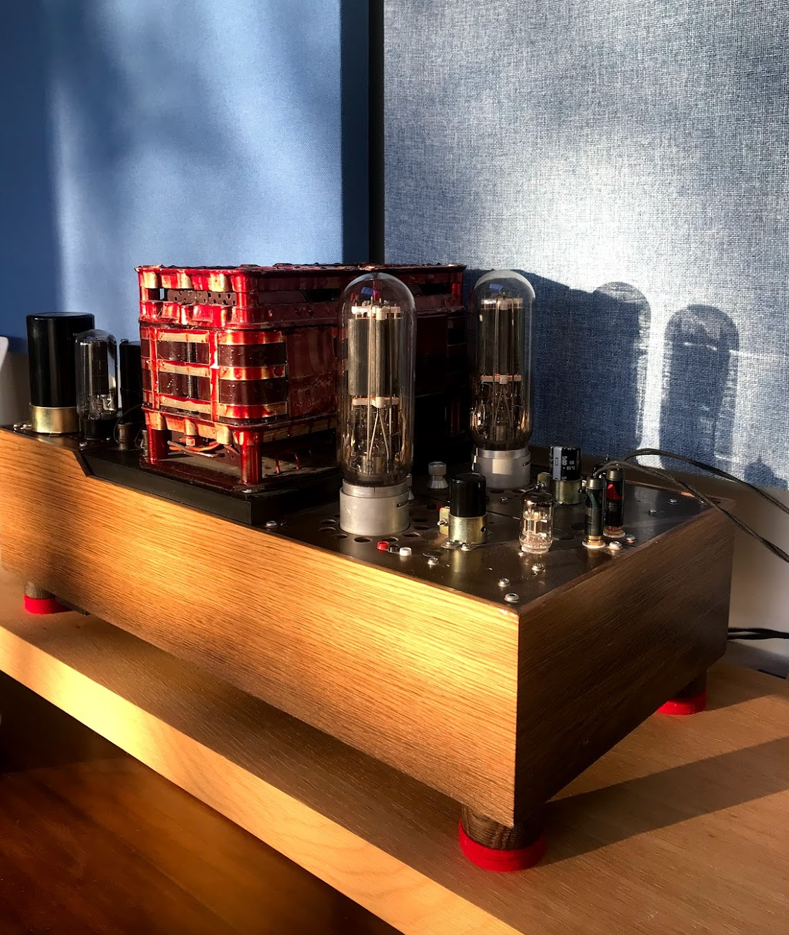

The design was made for me by a friend who 'finished' my part build Ongaku copy, by completely changing the design to mimic/echo one of his commercial units. The circuit and choice of components were all his 30 years ago, with the use of my originally sourced Oil filled chokes. I had a busy life at that time and was studying at the Royal College of Art and my brother sympathised with my lack of time, and lack of cash and paid our friend to finally finish the build. It has stayed like this ever since and I am looking to change the component choices and quality but not to redesign the whole thing.
