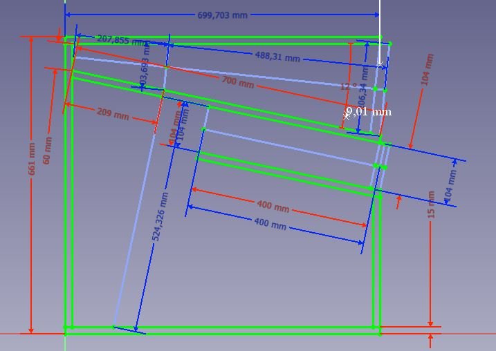

Here is the sketchup plan and cutsheet:
https://app.sketchup.com/share/tc/n...DLD8LDyiNw7KDszycRMhEXp2KghdNamZKP&source=web
I chose 15mm ply, because that's what I have, but 18mm might work better.
If you are not constricted to size and one sheet of ply, and you are not into v-plating, making the box deeper will lower the kick bump, due to the horn being longer, and will lower F3, due to the increase in rear chamber volume.

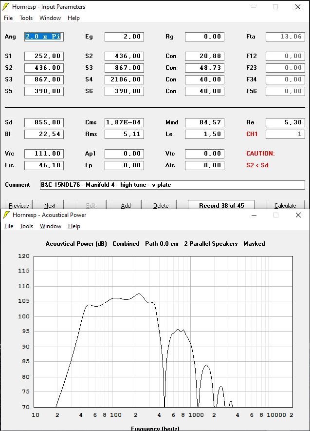

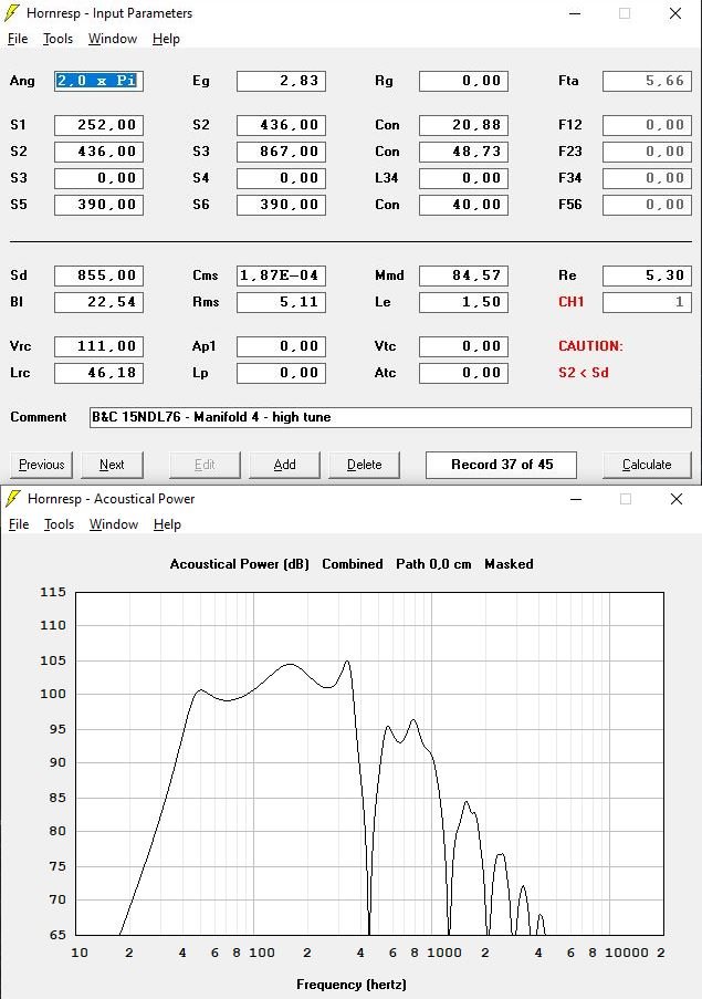

I tuned mine to work best with four cabs v-plated.
You didn't show the 4 speaker response. You showed the 2 speaker response.
Yes, maybe that was not so clever of me. I have posted the 4 cab response in post #84 and didn't want to re post.You didn't show the 4 speaker response. You showed the 2 speaker response.
