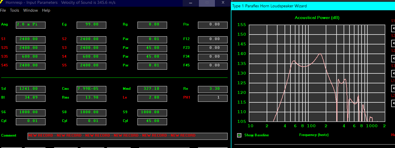

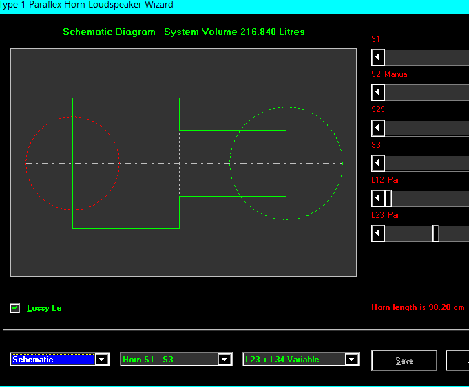

Any ideas how to sim this? as the ports feed into the horn like a paraflex, but unlike a paraflex, it has a rear chamber.
Here a picture of i kick bin idea. I just simmed it as a stepped horn, with a rear chamber port. Sims
Super obnoxious do to the large high tuned resonator?
poor choice of driver(18ds115-4), though it sometimes sims nicely with the ‘fake’ red LE engaged?
Yes haha. It’s quite hard to keep the hfr under control, but I think it is possible. I have some ideas involving a mouth adapter/port and a box that is bigger than the tube. Thanks for posting the PH1 sim. That is very useful 🙂Super obnoxious do to the large high tuned resonator?
