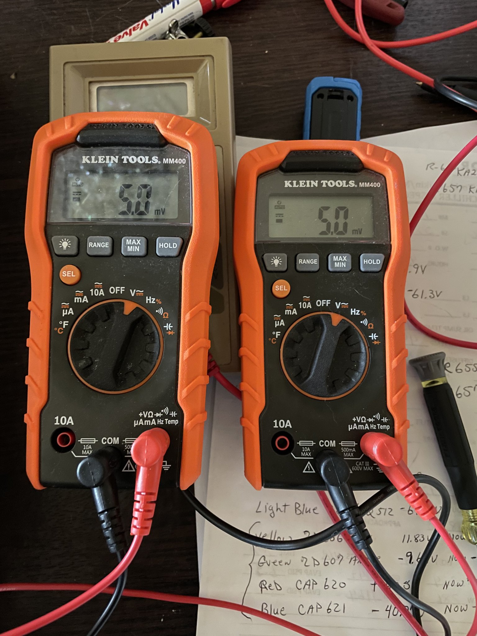

I’ve attached a picture of my left and right bias settings without FEQ508 in the circuit

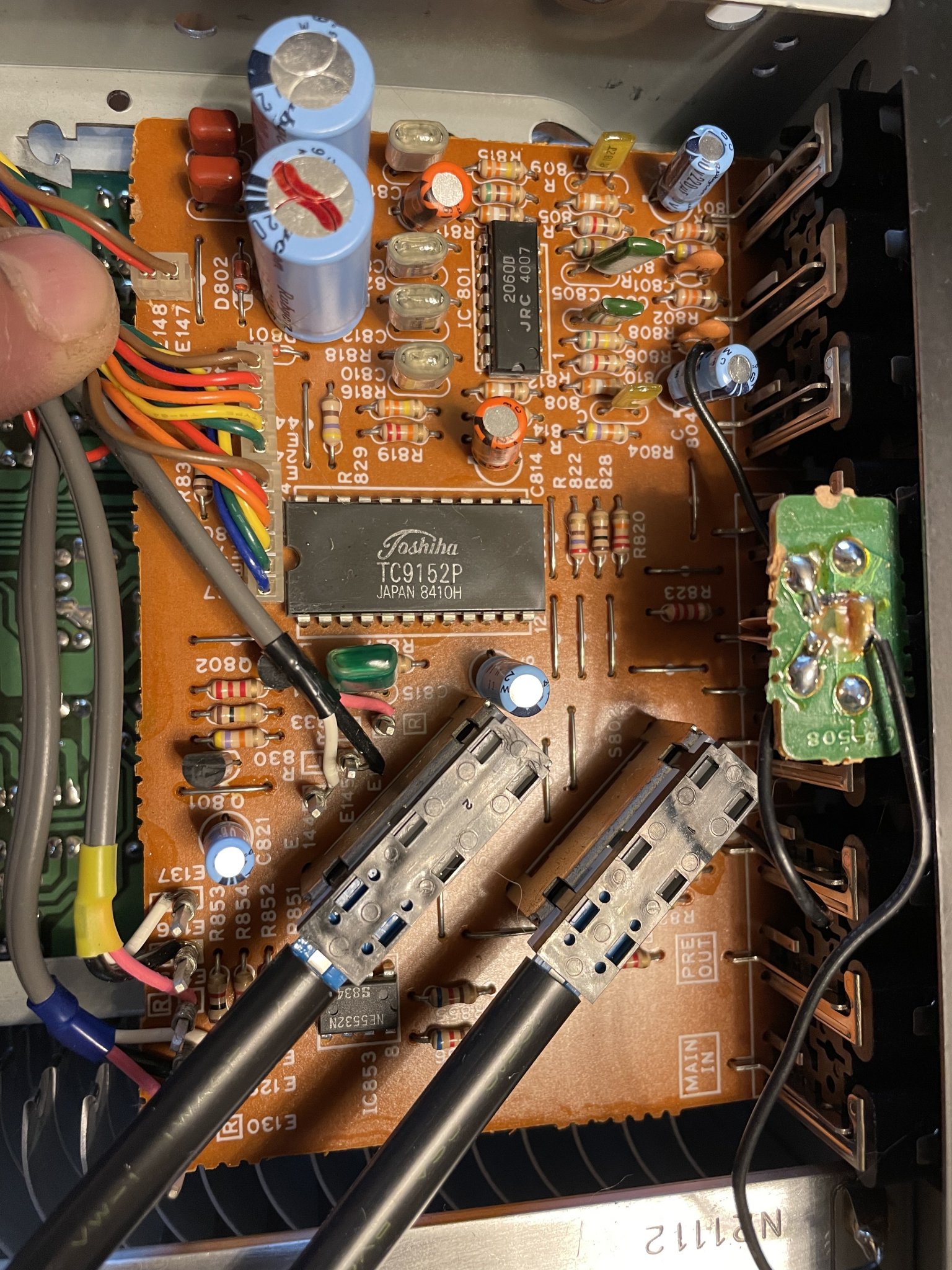

Also traced the wires to the trouble board and included s as picture of it as well

Ok, big progress.
I would plug the FEQ board back in and look for the hot or atypically warm IC. It looks like there is one dual and one quad op amp package. In addition to those there is IC802. That is an analog switch / multiplexer in a 24 pin package. Unfortunately my blind guess is that is likely the culprit. The rationale for that is that it has direct exposure to the receiver RCA inputs. Just guessing that there was an ESD hit when plugging unplugging cables. Its unfortunate as being a 24 pin package it would be the most difficult to replace and may be difficult to source.
IF my suspicion is correct, we could hope to see an out of place voltage on one of those RCA jacks. I would probe them as an additional debug step that is simple and could help zero in on which IC (or other component) is at fault.
Report back with your observations and we can formulate what's next.
