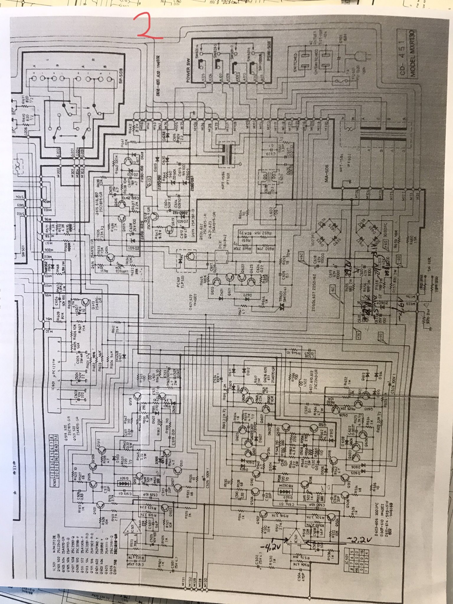

The way it went for me is 0 steps forward and 4 steps backwards. I removed the old op amp, installed a socket and installed the new. Soldered in a new capacitor in spot C22 since I had one on hand and soldered in resistors R65g & R657. Double checked all and then powered up. Wahlah! Nothing lol! 0 millivolts on either of the test pins and it is not adjustable at all. I started backtracking some of the voltages we’ve already checked and those seem to have gone south. Zeners ZD606 had +11.83v and now is +4.71v. ZD607 had -9.69 v now reads -1.06v. Cap 620 had +40.5V and reads +26.7. Cap 621 as at -40.77 and now is at -26.26v. I powered the unit down and installed the old op amp figuring that is really the only thing that has changed. I have the same results. Should I pull one side of R655 & R657 again to see if voltage jumps back up? Any thoughts?
Let me add to this by saying I developed another issue as well. My display doesn’t seem to be lighting up and I am locked into video/dad mode. I can’t change it at all. When I press any other button, that led comes on for a second while video/dad is still lit, but it won’t change. I’m assuming whatever is causing my +/-40vdc to drop to +/-26v could be affecting the operation of other boards. Any and all help is greatly appreciated and thank you guys in advance. Joe

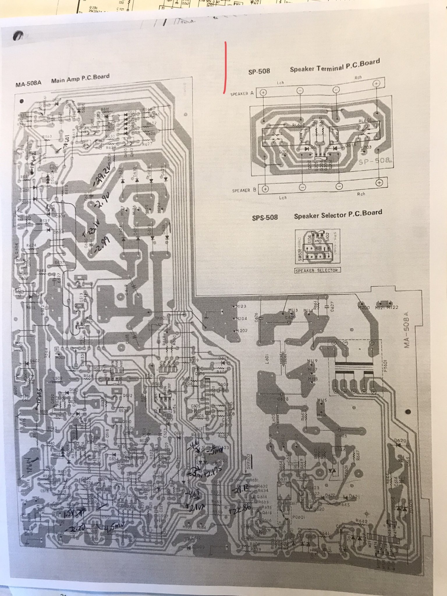

Ok, things went south. For us to help we need to get the big picture. Can you annotate the schematic with as many of these voltages as you can. When something like this happens to me, I find that I did the dumbshit move of plugging the opamp in backward or something equally as embarrassing!
Ok, will do. Oh, I’ve done plenty of stupid **** myself ie reading those resistors incorrectly in the 2 manuals lol. I wish it was something simple as putting the op amp in backwards, even if it would’ve gone bad. I bought 5 just in case but that is 100% correct. I will try to take a picture, hopefully it’ll be clear and I’ll write the voltage at points I checked. I believe that’s what you’re looking for?
I have a couple pics of the amp portion with some of the voltage and where I checked them. I hope these are what your looking for. Please advise if not and thank you. Joe
