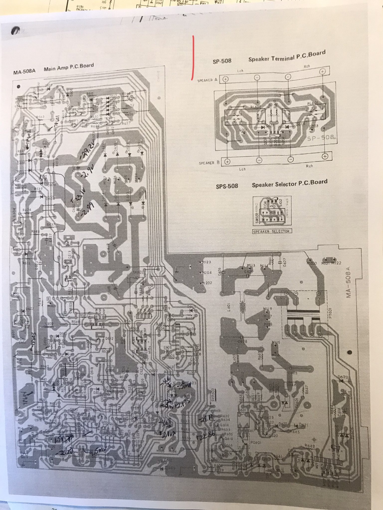

@Potentiallyincorrect @genrose I have a couple pics of the amp portion with some of the voltage and where I checked them. I hope these are what your looking for. Please advise if not and thank you. Joe
Sorry about the slow response. It's very hard to read what's what and make sense of things from that markup. Let's pull the opamp and inspect for solder shorts. Leave the opamp out and measure voltages. We need to find a format to communicate them that works better. Send the part number of the opamp you ordered. Need to verify pin out is correct.
Thank you for getting back to me. I didn’t know if you guys get alerts on the thread, that was why I tagged you. I snapped a picture of the op amps labeled new and old. We’re heading to my sons, I’ll grab them voltages most likely tomorrow evening.

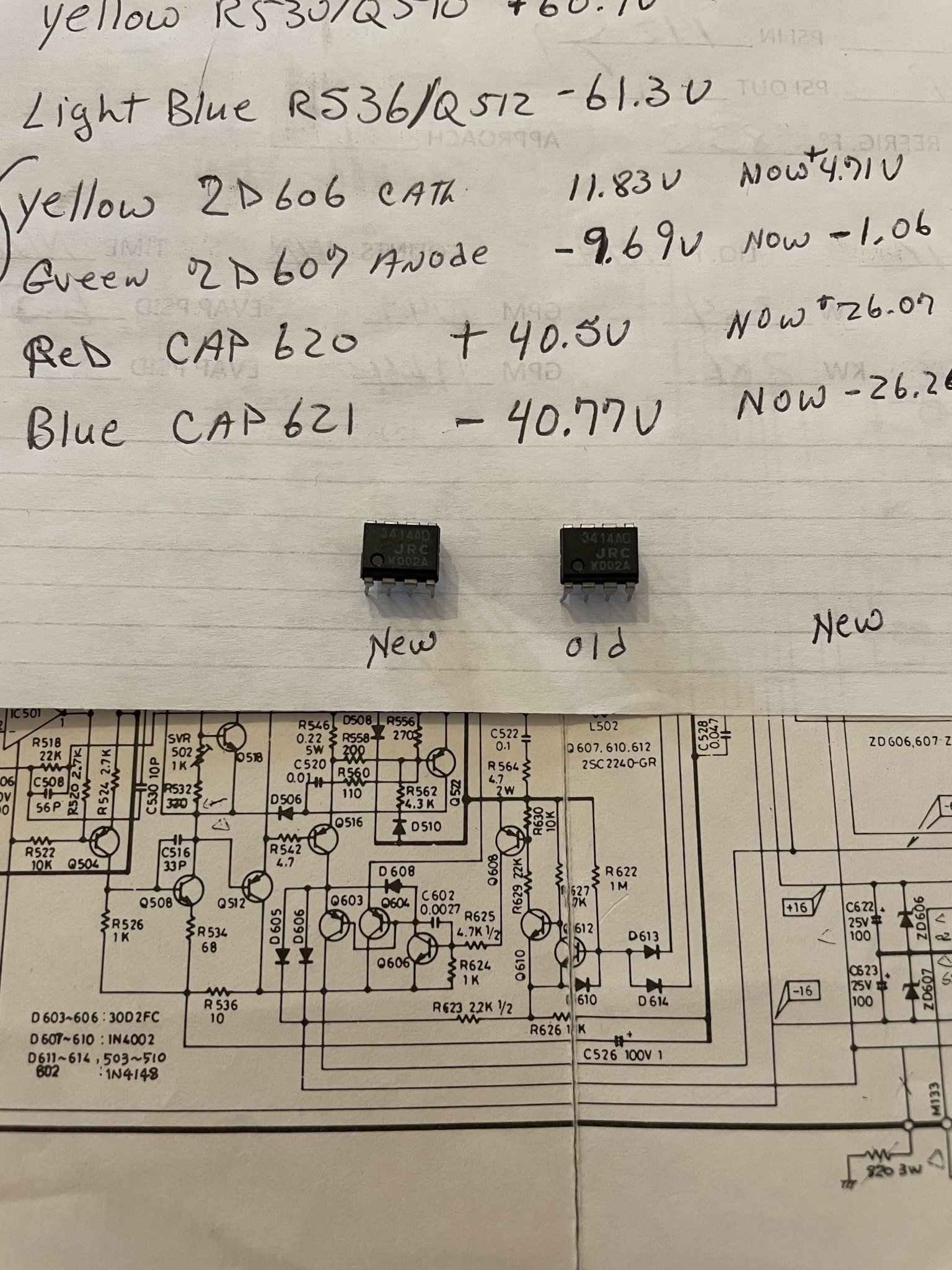

is there any relevance that my +/-40v rails dropped to approx+/-26volts?
In short yes. Too much current is being drawn from the +/- 16 v supplies, or the supplies are bad. Likely the first, now possibly both.

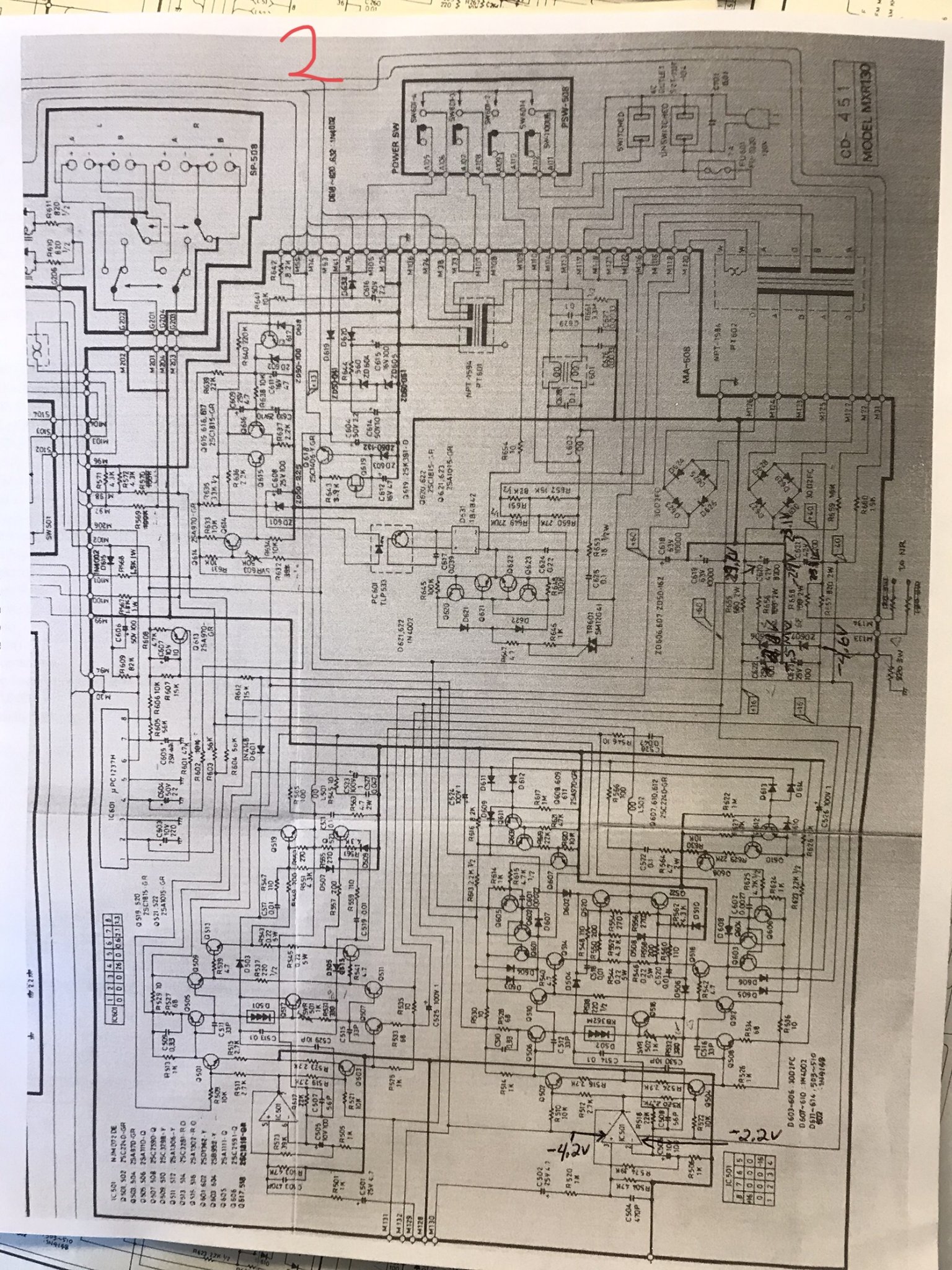

Just dawned on me that the problem might be where I can see! It looks like the +/- supplies get routed to another board (PA509) via connection pins M331 and M332.
Can you provide the circuit schematic for the PA509 board?
My bad for not noticing this earlier.
I found the schematic and downloaded it. It looks like the +/-16 V supplies get routed to 3 boards besides the origin board on the main board.
Power flow is as follows. Origin main board > PA509 > (TON509 and FEQ508).
We need to isolate which board(S) are drawing too much power. I would proceed as follows:
1) Disconnect wires at E147 and E148 on board FEQ508, see if +/- 16 V supplies recover. If so, there is a problem in this board, IF not go step 2.
2) Disconnect wires at G152 and G155 on board TON509, see if +/- 16 V supplies recover. If so, there is a problem in this board, IF not go step 3.
3) Disconnect wires at B131 and B132 on board PA509, see if +/- 16 V supplies recover. If so, there is a problem in this board, IF not go step 4.
4) Problem is on main board. (Where we started.)
Do not reconnect any wires / connectors until. we determine which board is at fault. Be careful to not let any of the loose wires too short to anything. Put tape on the ends if possible. If the wires connect via plug in connectors, just unplug entire connector involved. No need to only disconnect wires identified.
Let me know if you understand instructions completely before moving ahead with this debug.
Good luck.
