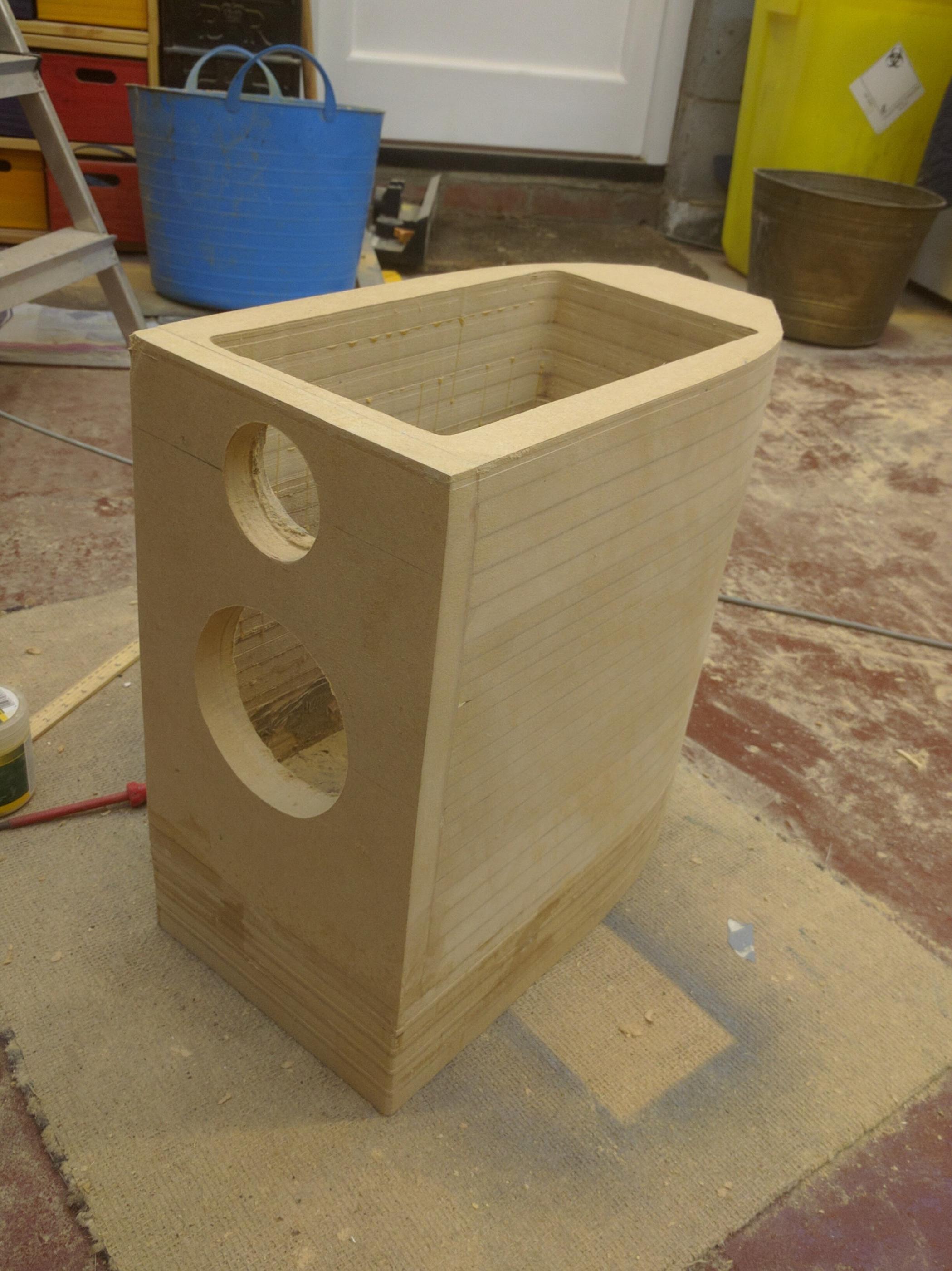

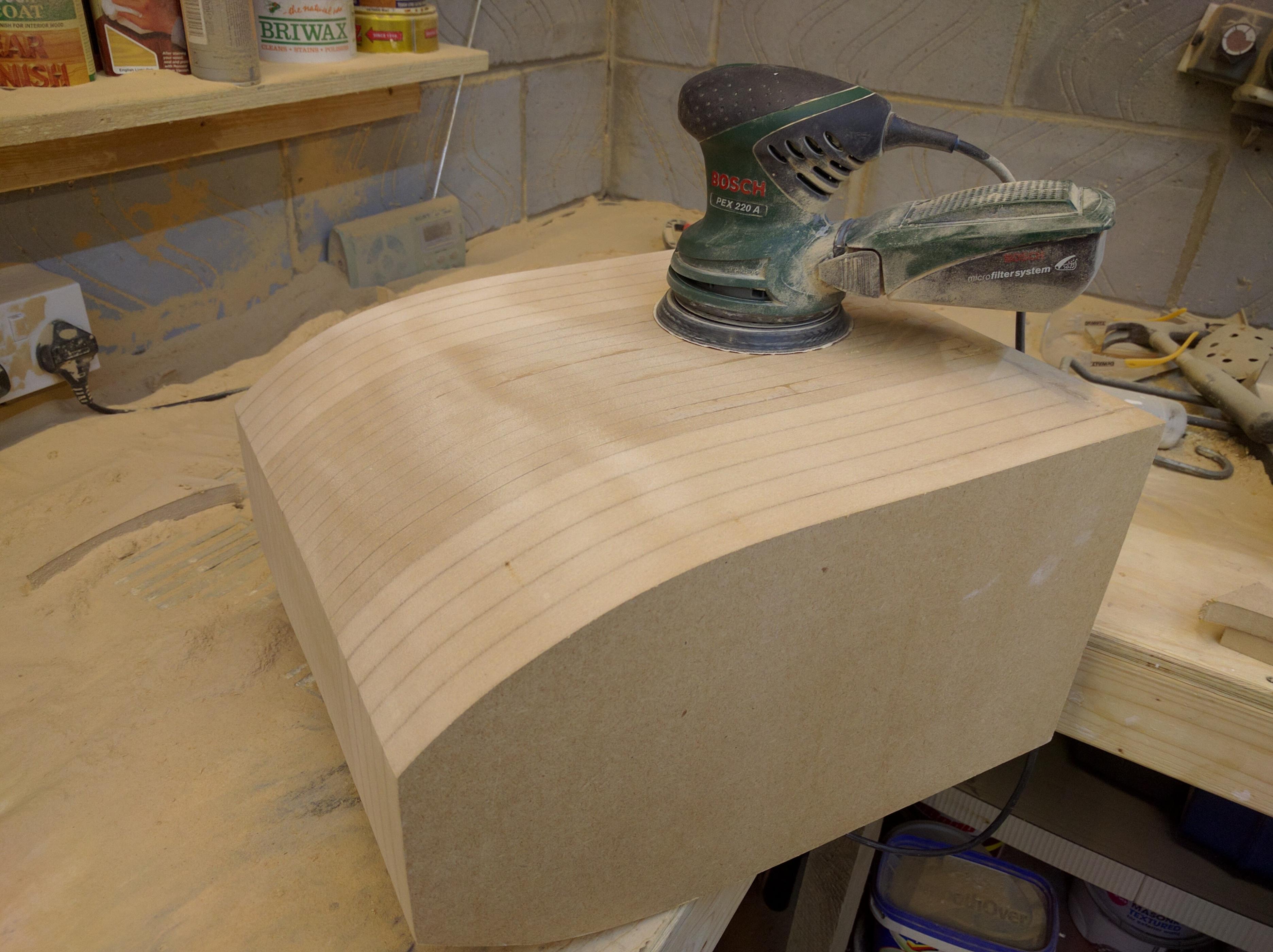

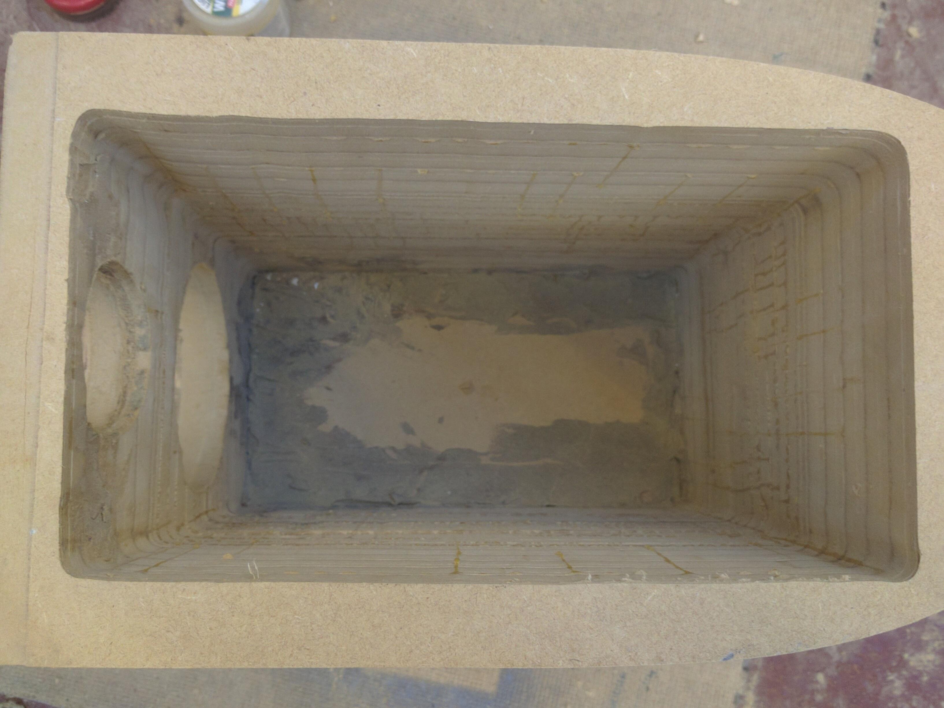

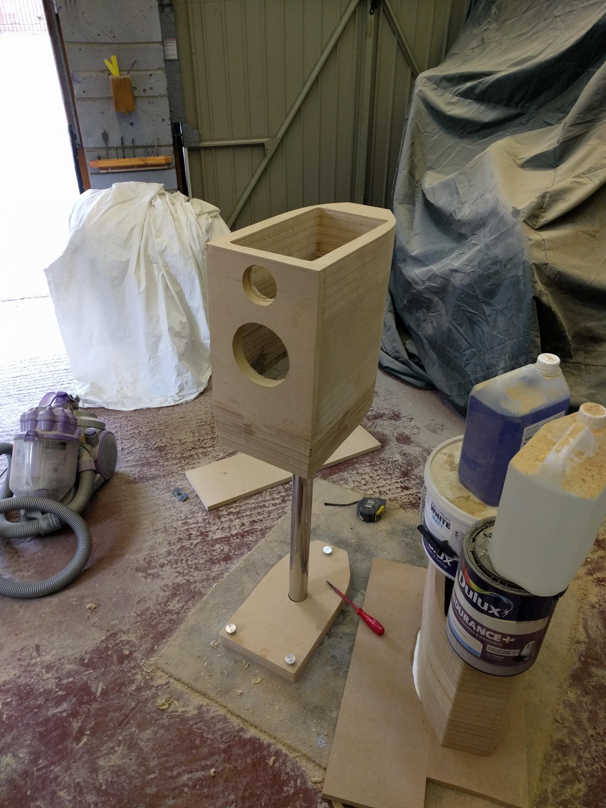

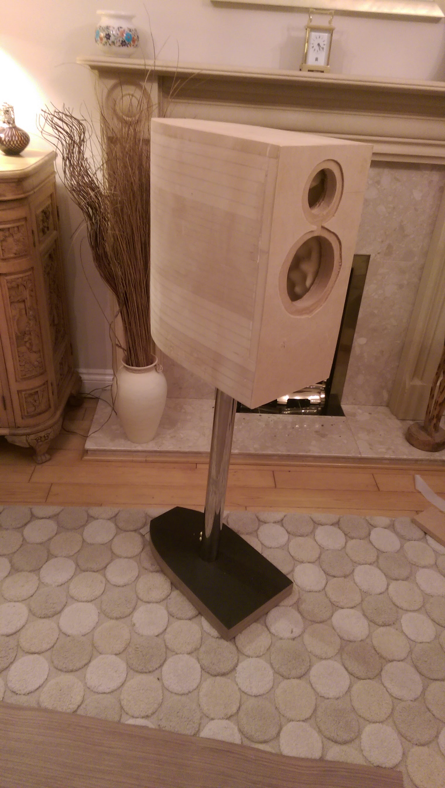

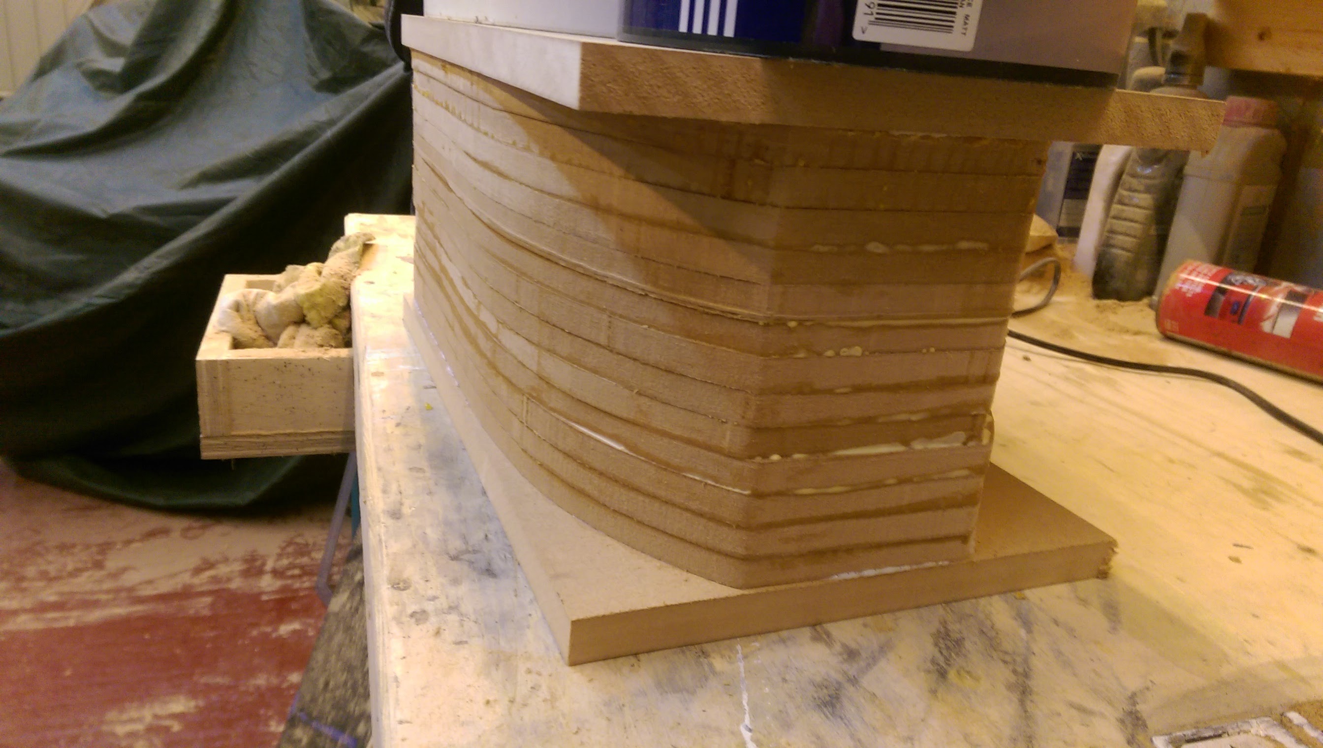

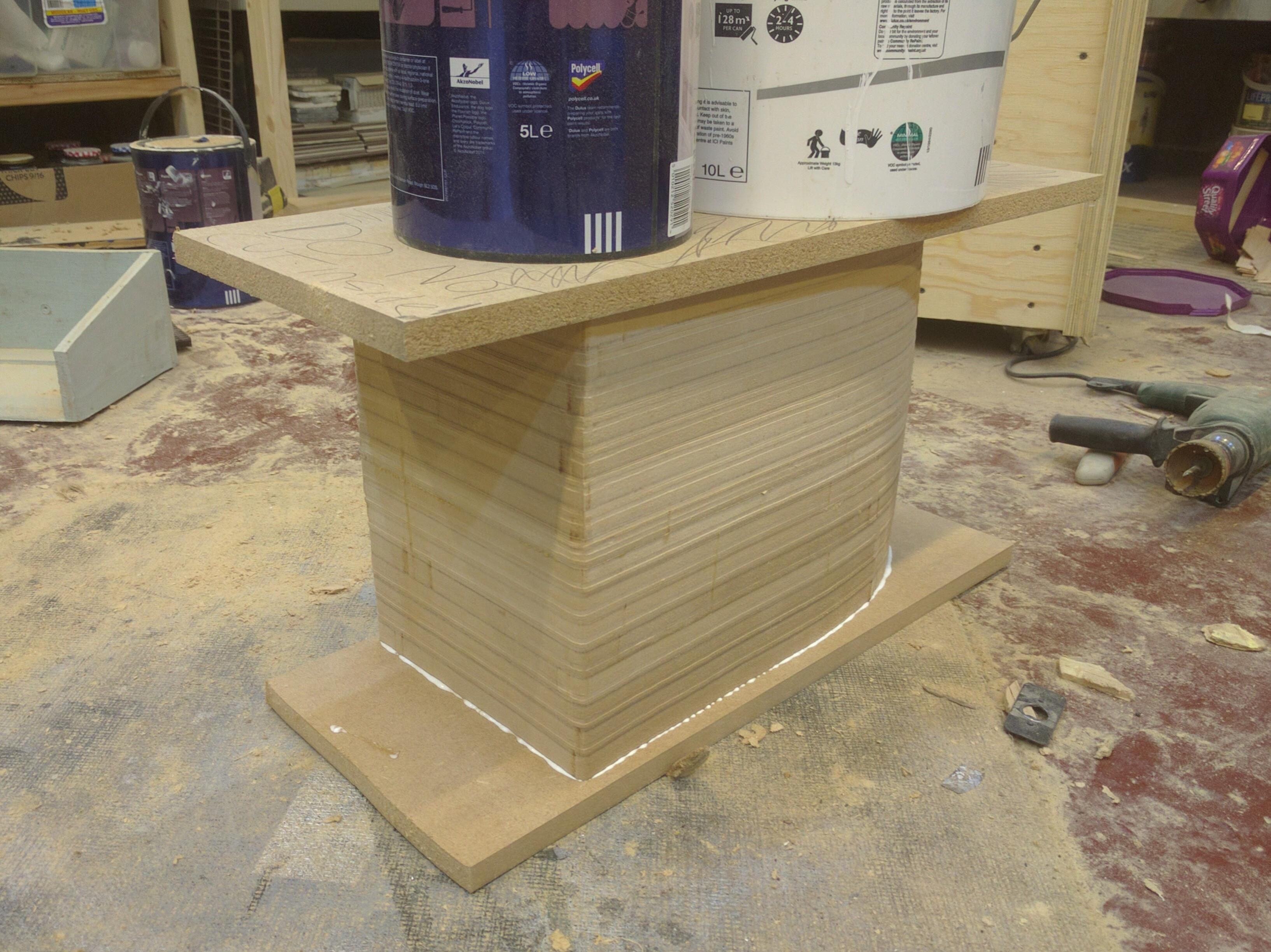

I decided to have a curved cabinet, which took a hell of a lot more time than if I'd have just gone with a regular cabinet, but I think it was worth it in the end. I built the speaker up layer by layer using a flush trim router bit, and have just started applying the veneer. My design has an integrated stand, which I made with some stainless steel tubing, and a matching base. I am using black anodised aluminium for the top of the bases as well as the front baffle. The rest will be finished in walnut veneer. Here's the progress so far...

I'm a big fan of zebra wood. I think it will look really good when you are done. I know someone finished a set of speedsters in a zebra wood veneer and it came out great.

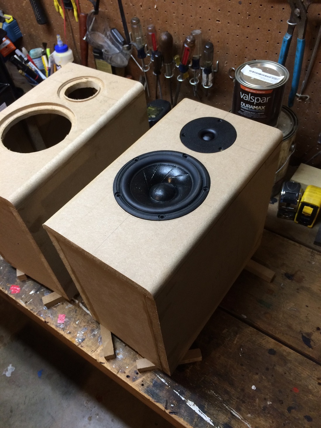

In this case, standard screws should be fine if screwed into the face of the MDF. It is a good idea to drill a pilot hole, making sure that is no wider than the width of the screw shaft to maximise the strength.
I have been thinking about t-nuts, as the drivers are recessed and only 1/2" of MDF is left.
Personally, I would think 1/2" of MDF would be fine, however as long as you can find machine screws which will match the drivers, t nuts would work, although I'm not sure if they would be stronger, if even as strong as standard screws.
I would think something like the #8 coarse thread screws that Parts Express has would work well. T-nuts are a tricky thing, and you run the risk of not being able to remove your driver because the t-nut shredded the MDF. Just be sure to not tighten the screw too much, and like aidenfward said, drill a good pilot hole. It also helps to thread the screws before attaching the driver to 'pre thread' the hole. I'd try a few different drill bit sizes on a piece of scrap to get the right one.
T-nuts works (just)fine

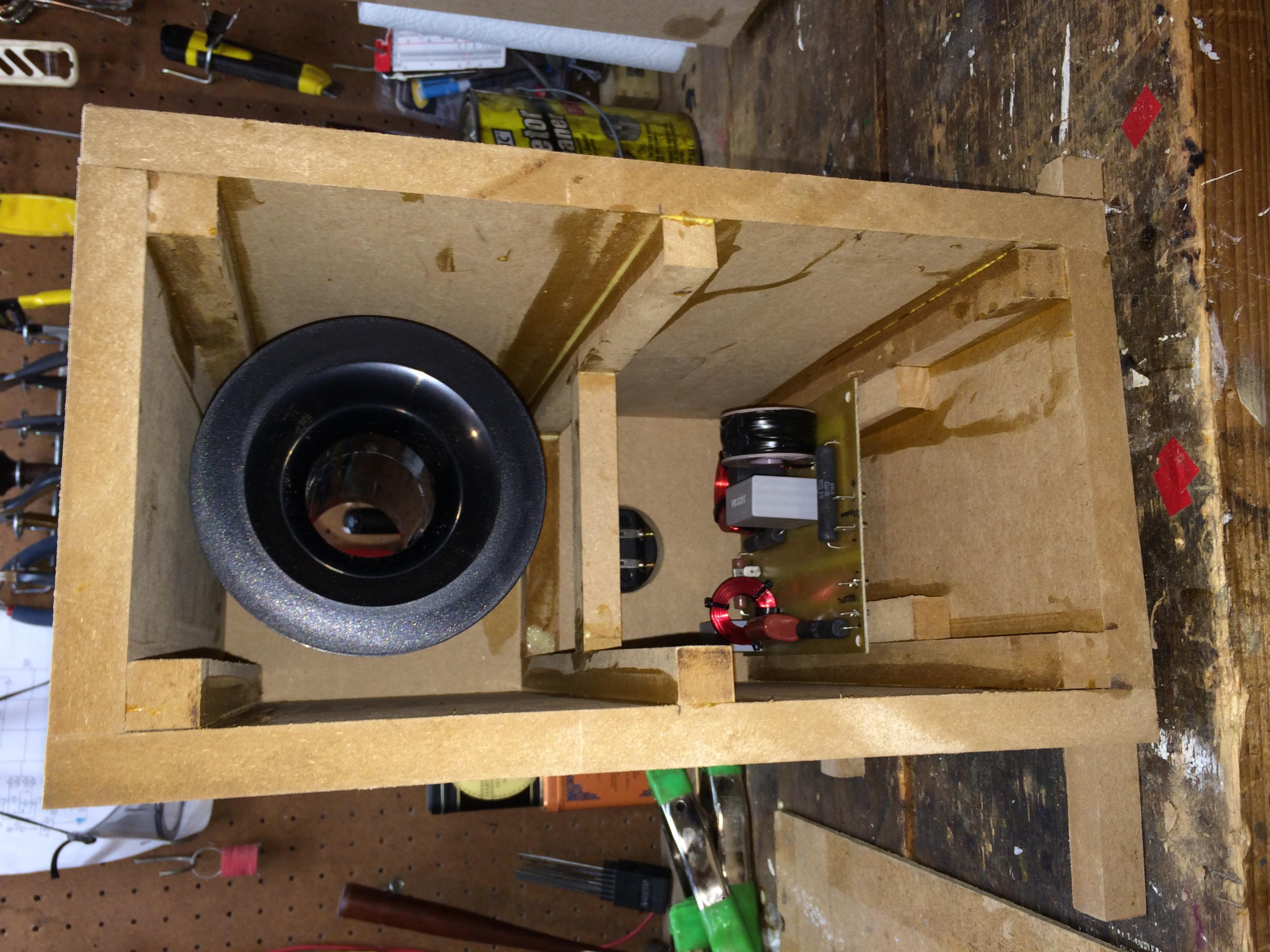

What I don't see doin' its job is the crossover placed that way: better outside of the box.
Far better...than attaching it to the enclosure walls

Why is that?
I would like to know exactly what t he issue with the xovers is too ?

Just stick inside everything
You can't just make a statement like that then walk away. Why?
