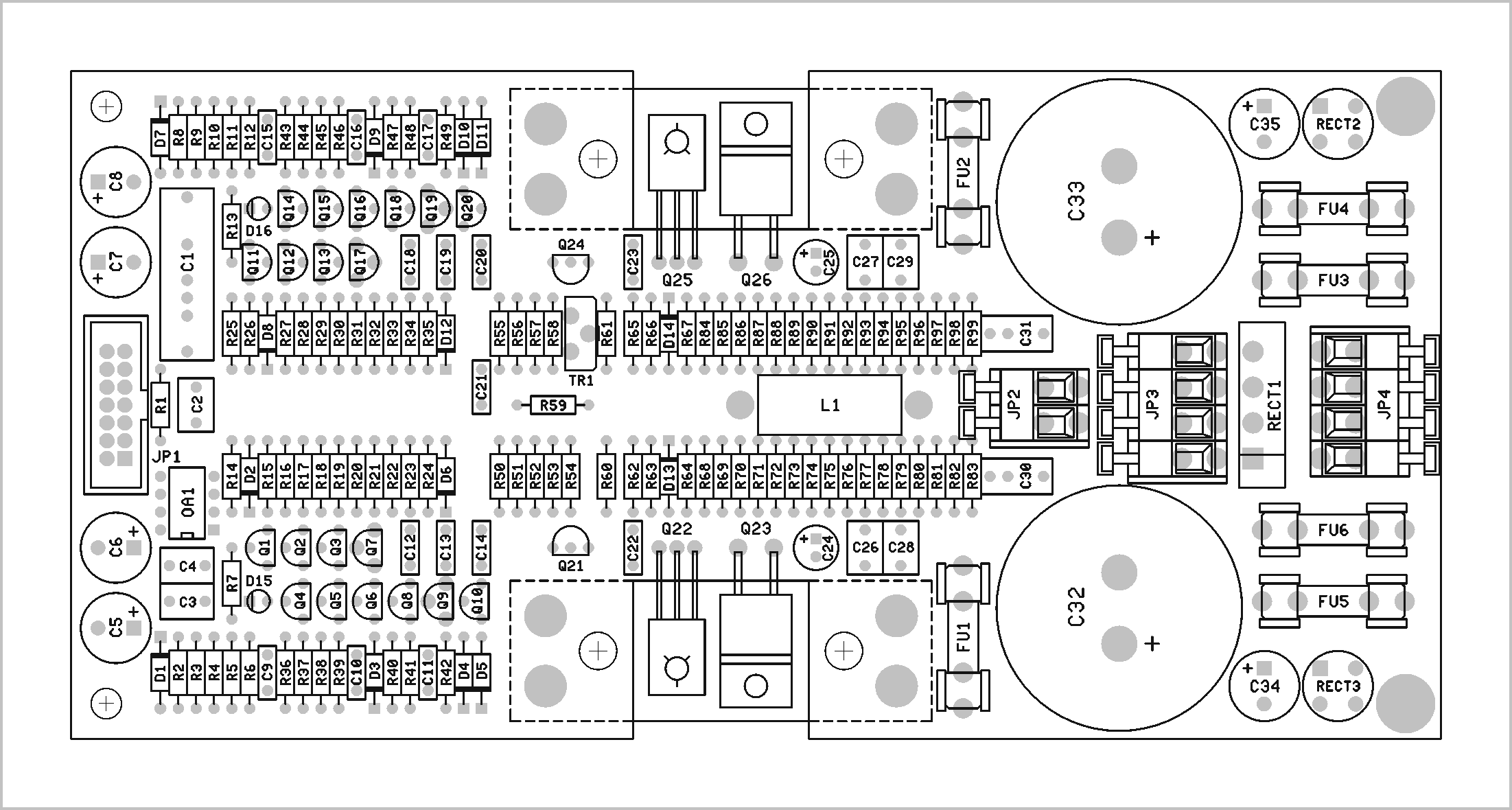

Key to the good results is maximaly short supply traces. Look at attach, there is an example of shortest traces which you can make. Supply rail is made by copper prism, which is also " subheatsink " ( insulated from " main " heatsink ). I am using this configuration in all my amps and I have never problems, 'cos supply trace have only a few cm and rail impedance is brutal low ( prism have diameter two cm sqr ).
Carlo, as you certainly know, my chip amp is made by the same principle : PS at the same PCB like PA, shortest supply traces etc. . Results are by my opinion good enough and I mean that upgradind by snubber will be ( in this concrete case ) very slight. At this time I can't try it, 'cos I have any module 😉 .
Carlos, do you mean seriously, that this stupidity is long time searched " Holy Grail ", which is healed all amps and shot them to the " listening heaven " ?
