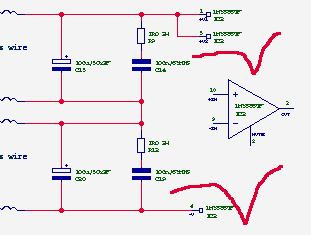

I'm claiming that this snubberization isn't done all the way.
Purpose: Bringing down resonance peak which the LM3886 sees, not far away. There the important thing to remove resonances' at the supply pins as the most important task, the second importrant is to remove the resoance further away.
Anybody who agrees with me?
Check carefully the pictures below. The original picture can be found in the first post.
Below we have a locally snubberized decoupling.

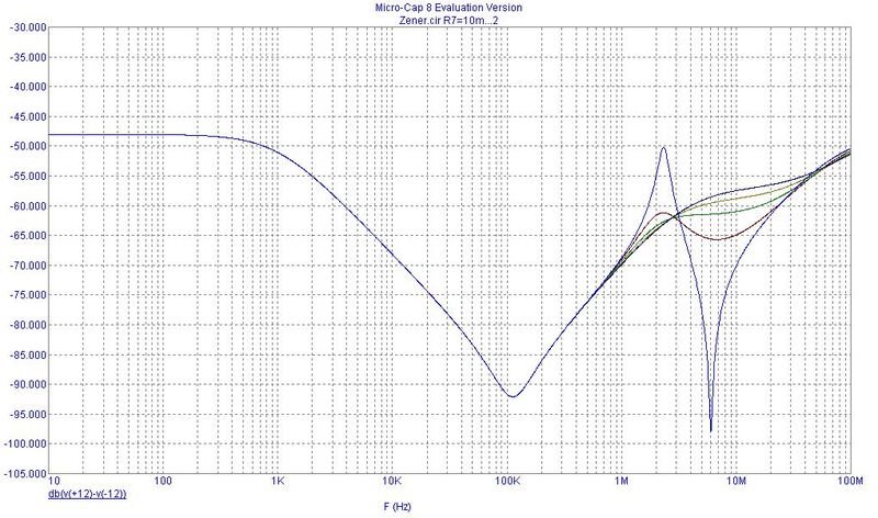

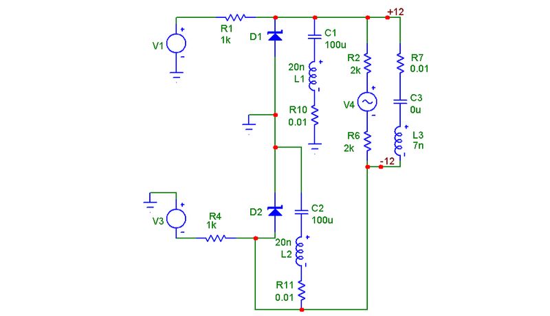

This is a simulation for various value of " R snubber".
The main impedance down curve (100Khz low peak) it is caused to 100uF caps, and for my opinions it's the only element of tecnical discussion...
the peak at 2 Mhz it's the "normal" 100nF resonance value, following of a bot peak at 8 Mhz...
The intermediate curve: brown =0.5ohm, geeen 1ohm, etc...
The most "linear" curve, dark blue = 2ohm.
The problem: The RC value absorb (-13dB) the "bad" high impedance value at 2Mhz, but all the "good low impedance" at 3 to 20Mhz it is very increase...
