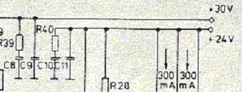

peranders said:... so I'll doubt that you will need several watts in the resistors.
EC-Otala amp
R39,40=1ohm/1W
C8,10=680nF, C9,11=100nF MKT
Don't forget that you don't know really why Mr. Otala has chosen the parts that he has done. Just becuase he has 1 W doesn't imply that it's really needed.
I have attached my snubber simulation which maybe has simplifications. You can see for yourself how small the current is through the snubber.
To P-A : It's amazing, how big is inertia in thinking 😎 . Otala use it probably because it was fitted directly on elyts without any PCB and with bigger type is in this case more easy manipulation. That's easy explanation, but only for somebody 😉 .

My first claim is that this rather small peak in the impedance curve is of minor importance.
My second claim is that this alone C2, C7 should be removed.
So anybody who agrees with me? At the moment we are not talking about how the parts should be chosen when it comes to values and ratings.
It looks like this snubber resistor could be rather small in wattage rating.
