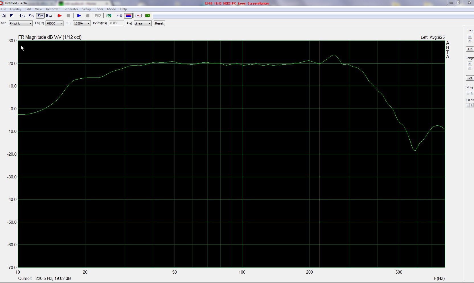

I did some measurement on the linkwitz w dipole, here are the results of a shelf filter in the amp and 120 hz low pass, on 260 Hz you see a rest of the dipole peak plus 4 dB so we need a notch here, I think make the box bigger, or longer bigger baffle when not folded we get a peak lower then the 260 Hz, I think the notch technic can alowed for a bigger folded open baffle W frame, even one with a slot two woofers and folding with notch give a higher efficienty what is oke. Even we go to 50 Hz or lower but it get a pipe and need maybe even more notch, I don,t now or notching wil have effect on the sound, never tryed.

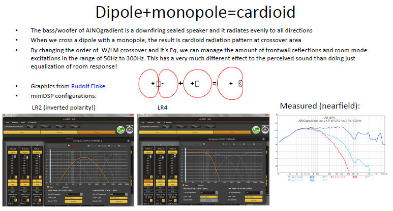

I caught myself -saying that above in Feb '12 and right after that I started the AINOgradient project! My lowest bass is omnipole crossed LR2 to dipole at 130Hz (about, varies). I have just done a seris of measurement with convntional monopoles to see the effect of different radiation patterns, and they are dramatic! I will post them later in my own thread.
There are many ways to create cardioid response and shifting it to dipole or monopole. Kimmosto is an expert o cardioid bass, see his projects eg. KS-1804 DIY archive of Kimmo Saunisto
