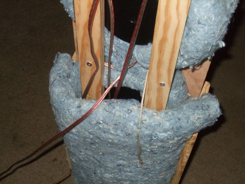

I'm using the rolls and they are 2 inch thick.
16 in. x 48 in. UltraTouch Denim Insulation Multi-Purpose Roll-60301-16482 at The Home Depot
I wrap a double layer around the driver basket, and then I use a double sheet on top of it. So it's actually 4 layers but there's some empty space inbetween. My measurements show a cardioid behavior to around 250Hz and it turns dipole below that.
Ah yes, I thought what you were using looked thin compared to mine. I'm using the R13 rated stuff, so it is closer to 3.5" thick and rated for excellent acoustical absorption to below 100Hz. Doubling or tripling up should get me where I wanna be. I've even got some of the R19 at the studio if I need it.

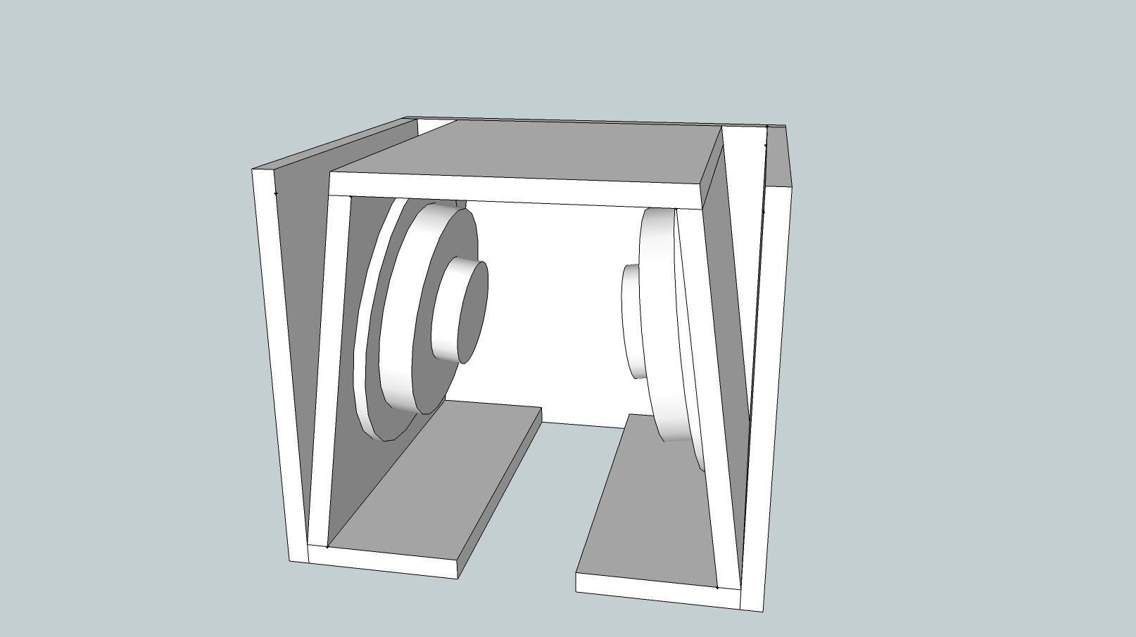

Do you now this? I did found it just whem googling.
http://www.kirchner-elektronik.de/~kirchner/DIPOL-CARDIOIDeng.pdf

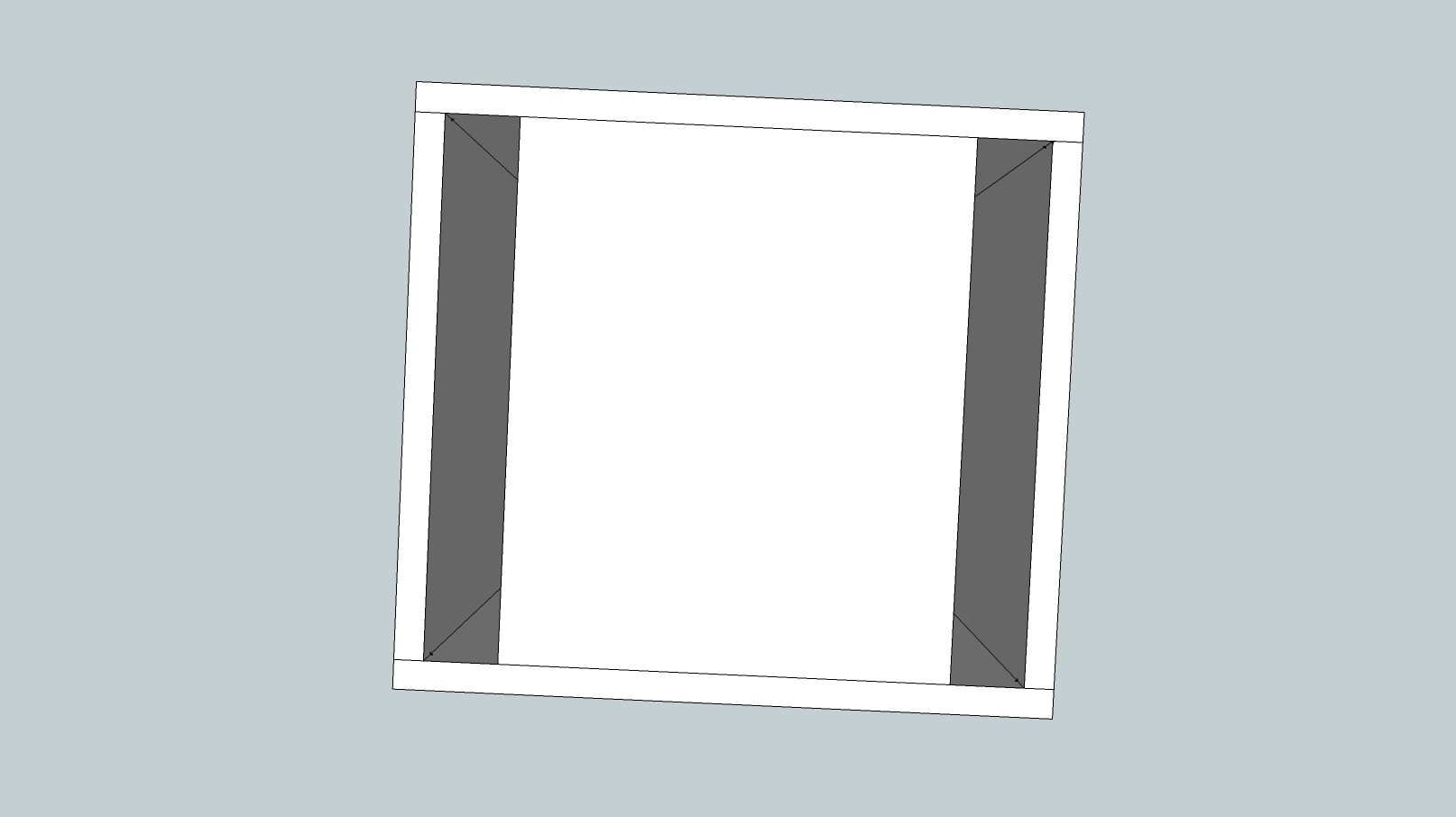

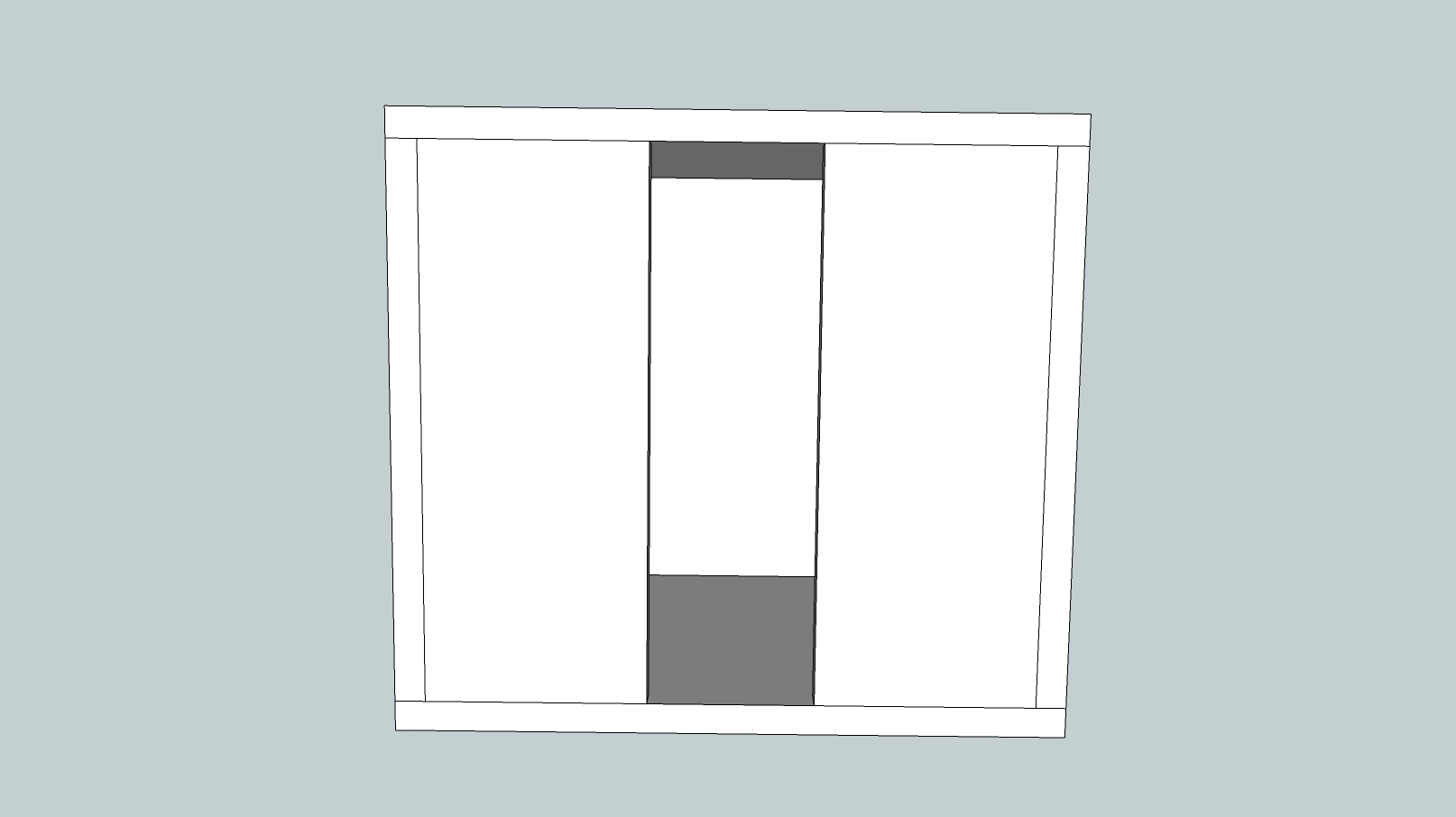

The article in pdf the inventers give as idea that the efficientie is a lot better with this kind of box, I do not now afcourse I have never test it, os as I did read it is a problem to get the back and front of the speaker isolated,, so a wave can not traffel there and cancel low frequenties, oke, these guys say why not mass load the conus and give sound velocity a push and the wave need more time to get to the front of the speaker.
Did you build the one on your picture? not the double one I did drawn.
The wheel, wel no need for re-invention, but maybe I can let it better rolling.
I do always re-invent te wheel with the audio amps, old idea,s are populair these days, like single ended, and such.
thanks for your link, I go read it. Maybe a better way for cardioid is the use of a delay line (bessel allpass will do perfectly) and a extra speaker..

Thanks very interesting article, I try some thi some time, I make a electronic (bessel alpass with opamps) and a 180 degree fase shifter, this is not difficult, and try with two closed boxes back to back, I only need twice as much bass amps, or only one for mono, but music is also stereo in the low tones I have heard?
I want try first the box I drawn, this is from a german guy but it is not really further developed? it is not for the cardioid wich is difficult in normal room but efficienty of this box is higher says the developer that is interesting.
regards

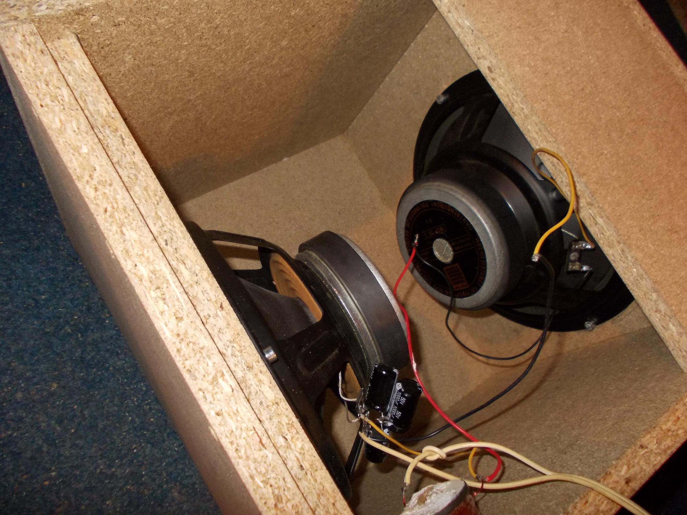

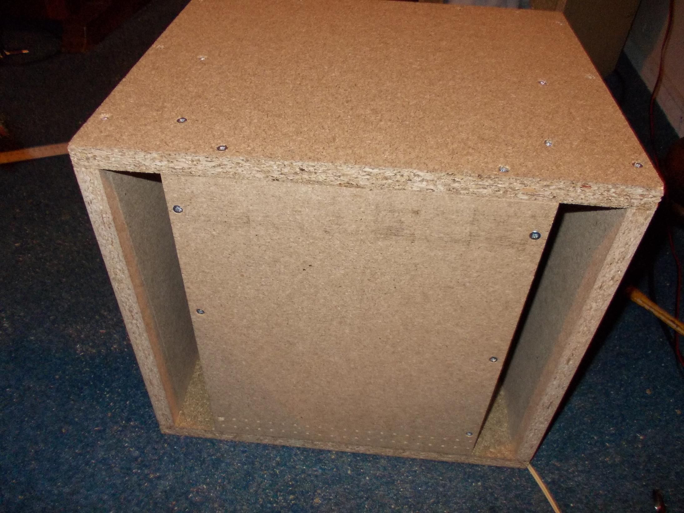

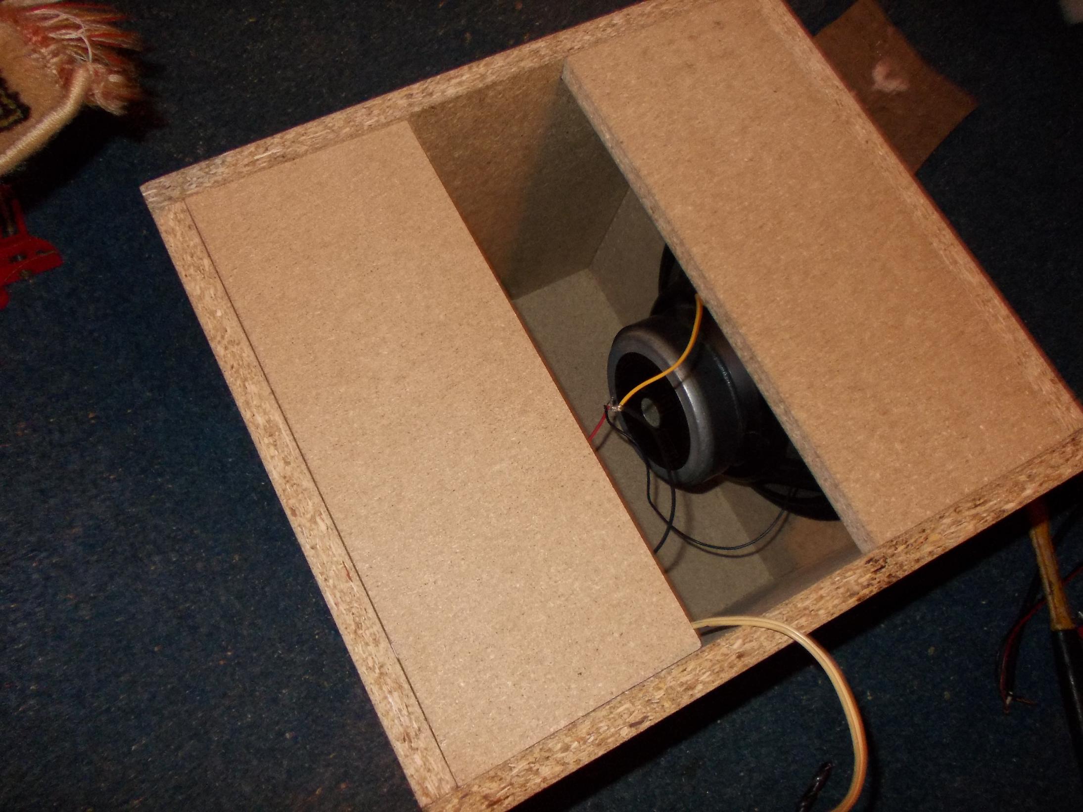

Hi All
I have made the box, I have still need measurements and I let now, for the sound, it give pretty good bass, also low end, and it is louder then the dipole/ripole.
here some pics.
here some pics.

For me cardioid is not my search, but more efficienty, and near field, tja, in a home it is not a theatre, only big audient places needs cardioid because it give more efficienty because it is more directed to the front..
If i want cardioid then I put me head in the box, then I have a true cardioid, or I make a horn, the best cardioid ever.
But serieus, this thing here sound very well, I go make a bigger one where the part of the box where the magnets are has a volume who is also needed when I have a closed one, or a basreflex one and front of speakers still mass loaded.
I have need a shelf filter for the dipoles, for this one I have more bass, it is punchy and no need for the shelf filter anymore, or maybe very little correction nut first measurements.
If bass is "punchy" or not is usually a midrange property. That darn Fourier stuff again. You of course have selected superb mid-range armament. My experience is bass is a matter of managing the peaks and distortion. Are you expecting some sort of un-equal phase cancellation front to back modifying the radiation pattern? Please enlighten me here.
