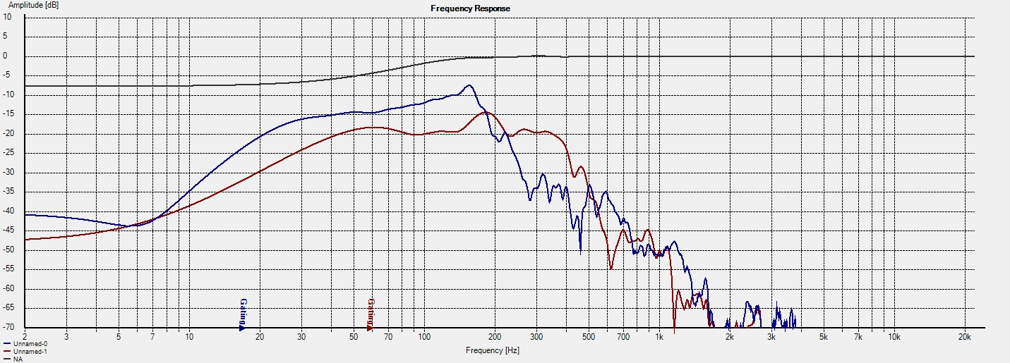

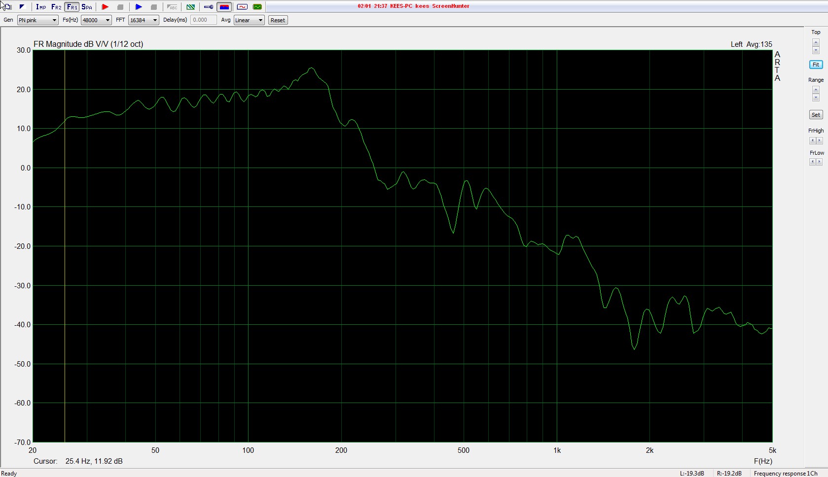

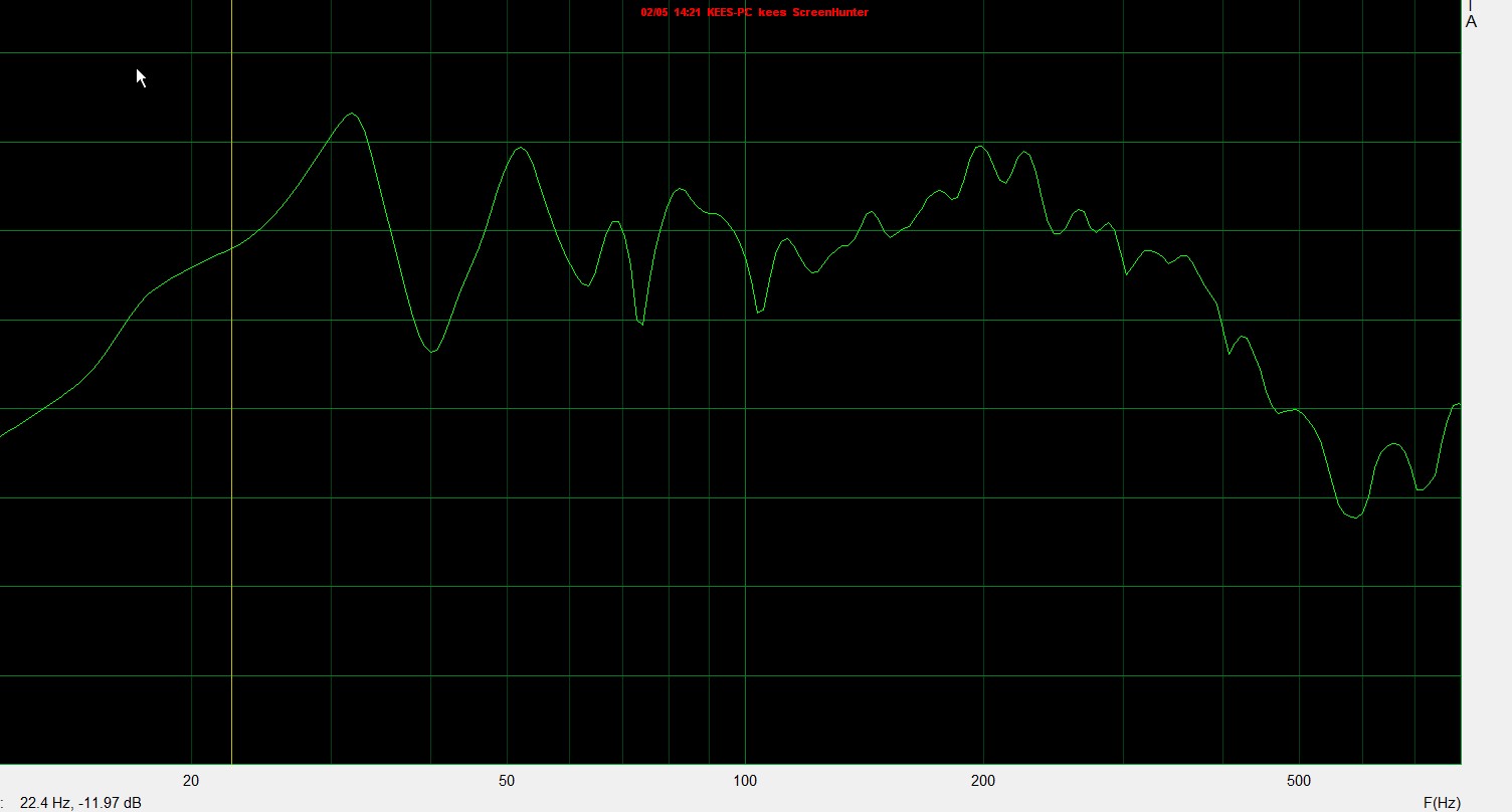

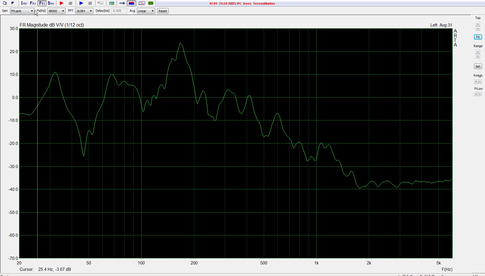

Oke I have did measurements here there are.
1, resonance, 2, sweep 2 meter distance, 3, sweep 1 meter distance, 4, sweep near distance, 5, sweep 1 meter distance with shelf filter on, 5, sweep with holm impulse red is back and blue is front.
Some tips about the measurement welcome, and it is done inside my living room, so not ideal but measure in the rain outside is even more severe.
The next I will make the box bigger, see what this brings, like the inside closed box properties for this drivers. As you see the plots are looking like the dipoles, but I have more spl watt, even without shelf filters I have really good bass, there is some ripple in the plot like we have with transmission lines, but it is very small and can come from the shelf filter ripple because it is a very simple one for testing.
While measurement with holm impulse, things did shake in the room, so it looks good.
thanks

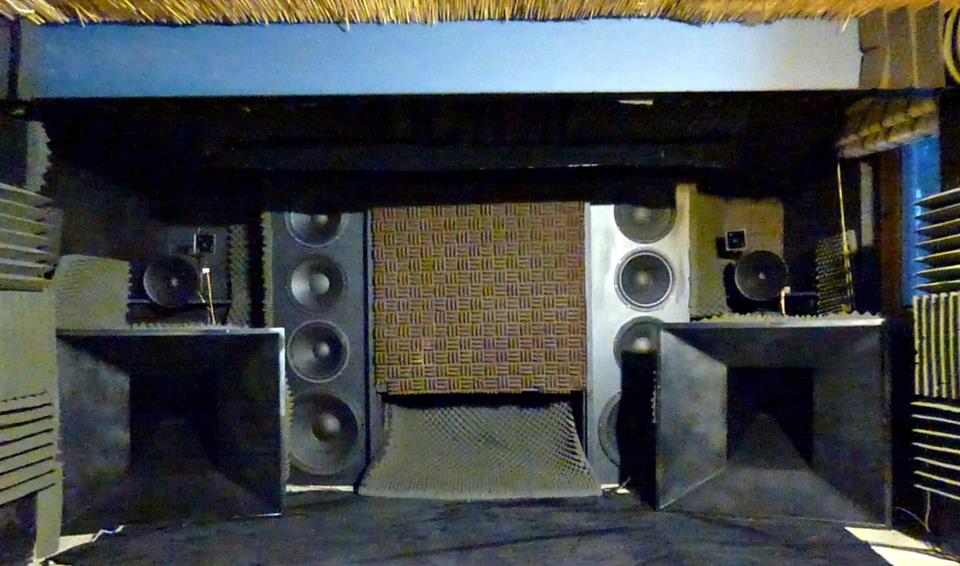

The upper bass here, the lines next to the bass horns, is cardiod. It sounds very good.
I think still that there is not a better sound then with horns, I want some time test that also, a tapped horn, then a basmid horn with the small fostex 8 inch speaker, not to big and big deep bass, only a tapped horn, I don,t now that sounds so good, much different outcomes here.

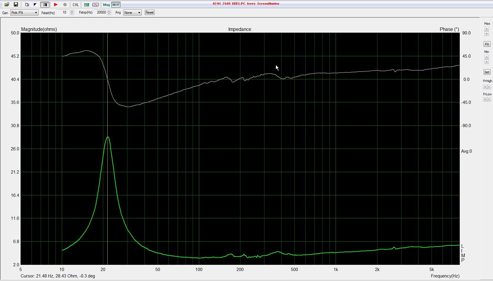

Oke, a serieus quest i did, for the dipoles and the new dipole-cardiod, I have did qts meaurements with the speakers in the box, it is not possibly to get more then 0.45 for a 0.33 speaker, so I did discover and you al ready that for this ripole/dipole/cardioid a woofer of Fs 30 hz has need also a qtis of 0.50 or 0.60 for a little bump in the low end what is not bad, 0.6 or 0.5 for better impulse behavior what is also importand, so i gess a qts of 0.50 0.55 is ideal.
I did get with the visatons not higher then 0.45 what is 0.15 higher then in open air, the Fs did drop to 15 Hz.
very interesting, open baffles likes high qts but above 1 it is flossy bass bad impulse behavior. dipoles are really interesting when using big speakers.

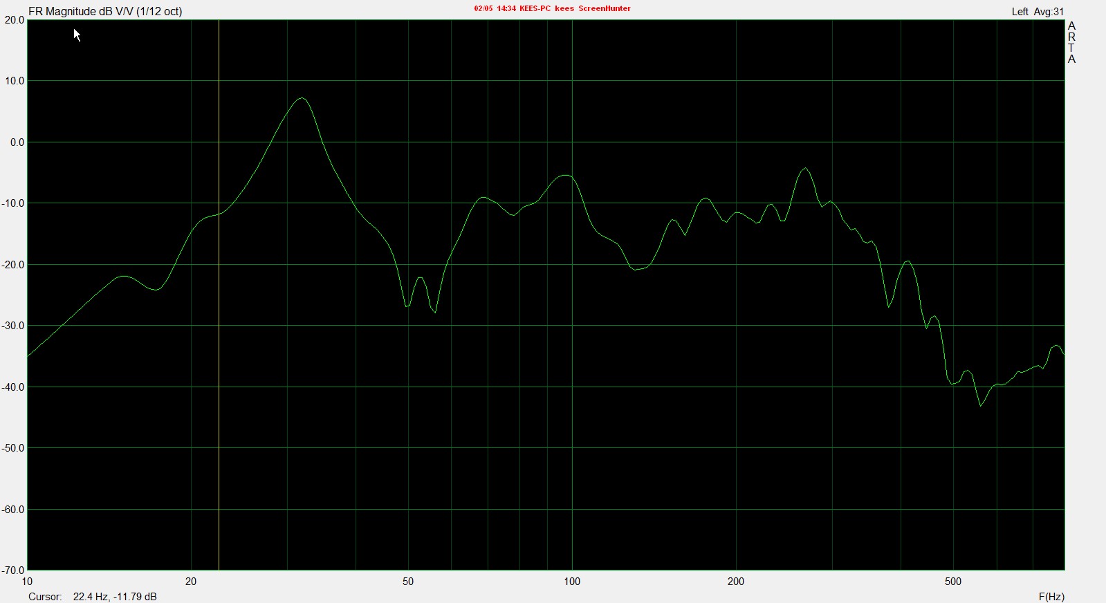

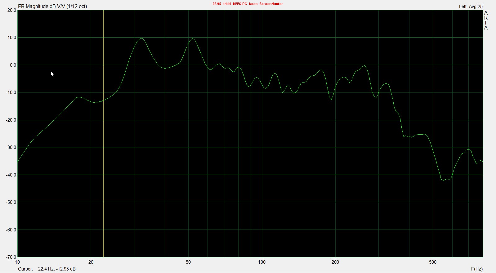

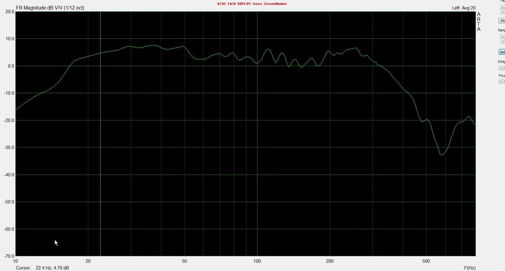

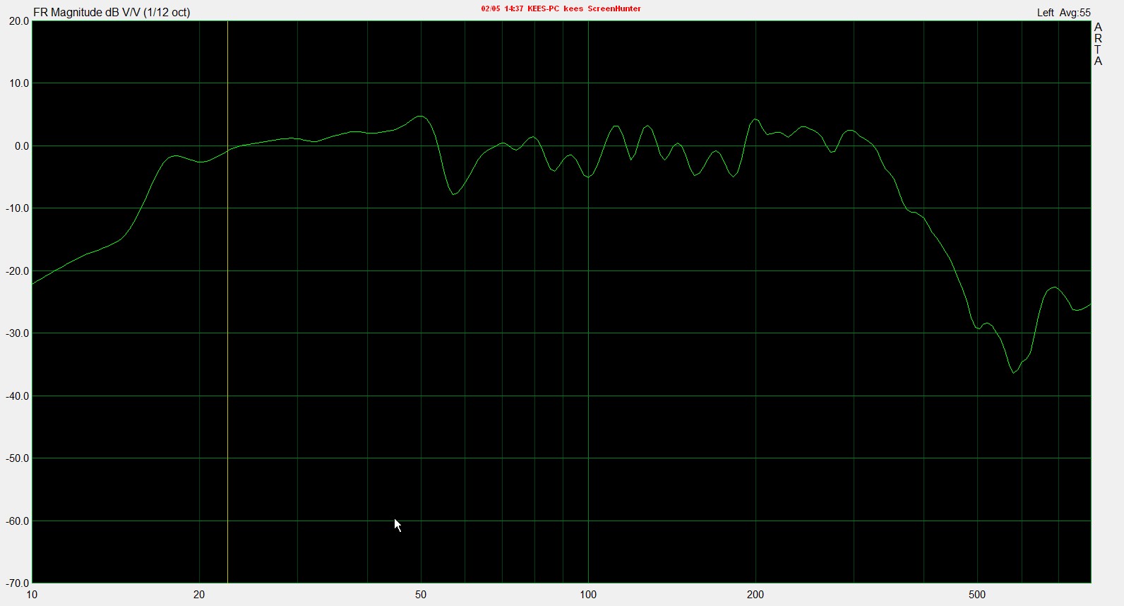

Oke, I did drop the german dipole-cardioid for now and busy with the dipole again, I did see that I have a lot of room influence when measuring, can somewone tell me how to cope with rooms, this for me not something I have experience of.

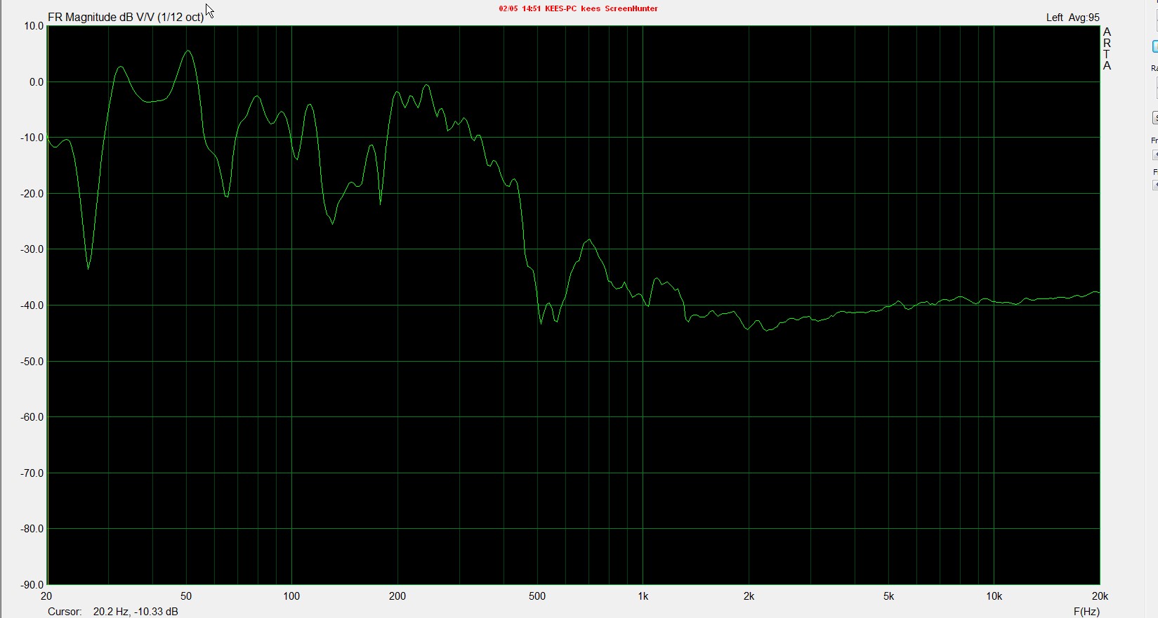

I did have thin sound but if there are sub tones then it gets serieus spl here, so I did measurements and saw a lot of dips and peaks in the place of where it thin sound exists there are dips of 10 dB ore even more, and yes then I do mis body in the music.

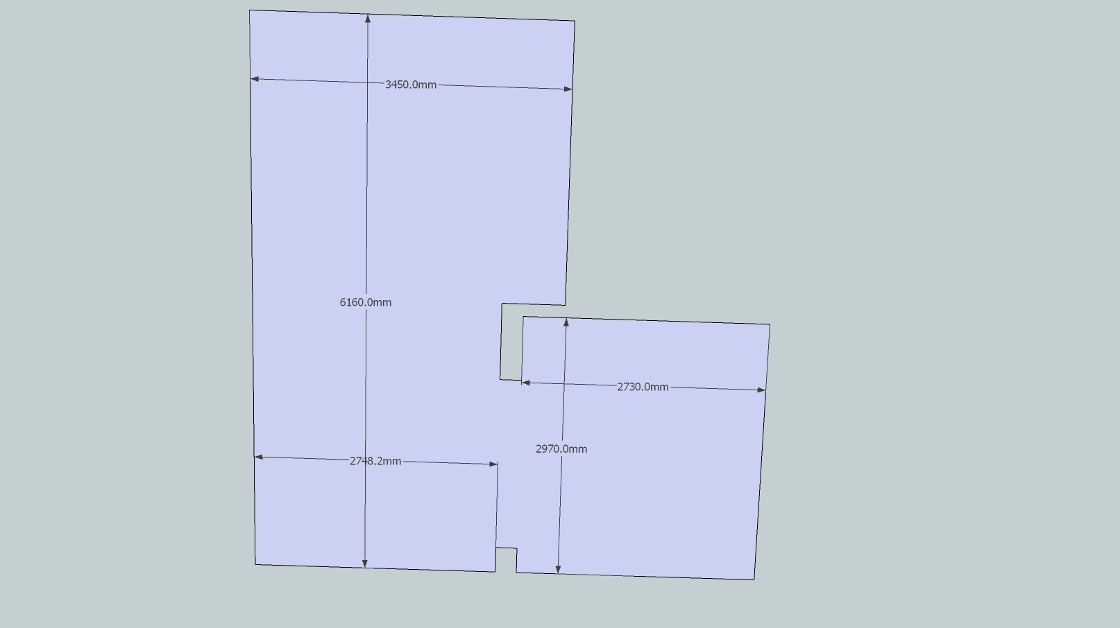

I have put in a drawn how my room is. Some tips where to place the bas box i do like, included measurement of my room the L form is not so good I think..
I get good graph if I do measure close to the dipole box, like max 50 cm, longer then I have a lot of cancelations and peaks special around 40 to 80 hz and here I get the music body, and so it is thin, very low bass is more then enough, very nice and clean also.

I have found the dip reason for mid, the mid speaker I have change to 6 dB and reverse the polarity, now it sounds very well, so just only the bass is needed to get best as can, I do need two stacked dipoles with high xmax 12 inch and I have enough sound, the visatons do very well al do these have a low qts of 0.34..
thanks for your input and pps.

I haven't read Earl's PPT presentation but we have communicated in the past and discussed this on the net as well. I think I am pretty much in agreement with Earl's basic ideas, though system designed to be dipoles or cardioids in the free field do have some differences from just using distributed monopole sources do to phase differences, delays and the equalization.
The thing that really pushed me in this direction is that when I took some measurements in a room with a monopole source and moved the source only about 18" the response at the listening position changed significantly. Since this is about the same separation as my dipole sand cardioids I realized that the two sources of the dipole or cardioid must also be radiating significantly different SPL relative to the listening position and the summation would not be anything like free field.
With regard the the experiments with the so called cardioid-dipole and an H frame dipole I would still expect the H frame to perform better because the front and rear response will be the same. In the cardioid-dipole the asymmetry between front and rear results is different resonances. Of course, if the response is low passed below the point where the resonances contribute to the response it's just a dipole anyway.
I would say that a system with dipole or cardioid bass typically has better in room response but I thing the main reason for that is because of the multiple source arrangement.

the dipole-cardioid did act as a normal dipole indeed, only with more noise from the small output side, not a succes i did discover, so I have now back the normal linkwitz dipoles who give nice bass, the lower octaves are mucho present like the 30 hz is loud, higher it did cancel out, all the measurements in post 53 was with two dipoles, I had a bad coil so I did wind myself a better one of 15 mH for the low pass.
I agree with the H frames, i had these before the dipoles and did give more bas and better distributed in the room, it did not go as low as dipoles do, the dipoles are very nice little boxes who do good but H frame have more spl per watt.
I go build two extra dipoles and testing the room, I have used now a 6 dB dipole filter for the baffle fall off and it do wonders.
the polarity shift of the bas mid speakers did make the thinny sound disapair, a 6 dB filter for the bas mid did even better, so much different when play with components, incredible.
