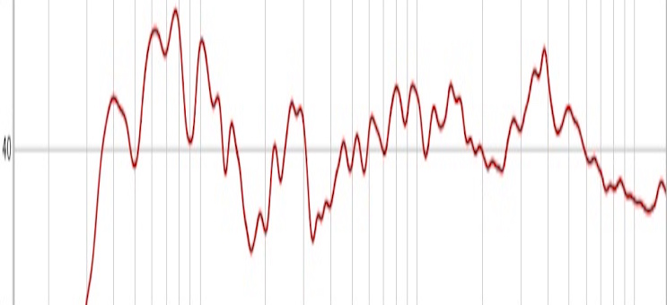

For comparison on the previous graph, 223Hz was 2.78% THD, 0.943% @ 557Hz, 3.45% @ 756Hz. Maybe drive level is making some difference but is not the whole picture.

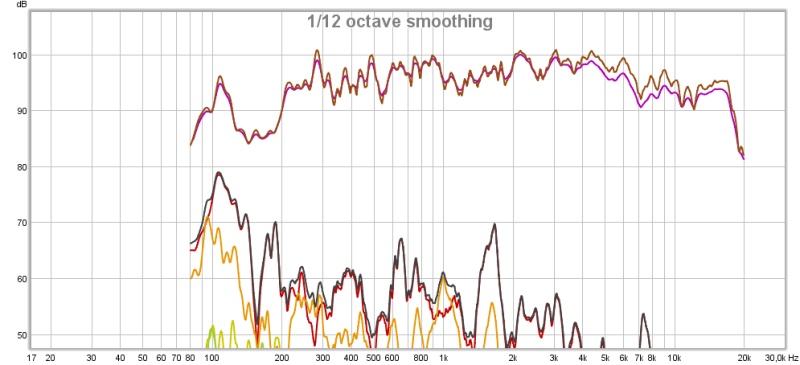

Some readers may not be used to reading these REW charts. So here I am providing an absolutely worst imaginable loudspeaker as a comparison: my elderly MacBook internal micro-speaker being picked up by the internal 25-cent mic.
The lines are 20dB apart. Not bad performance.... compared to some recent posts.

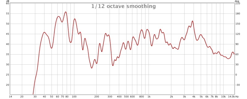

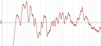

here is a distotion graph of mine, still not the best.
there is a high shelf at around 14khz
and a 4db low shelf af 400 hz
but it is not about the feq response , distortion at 1.6khz is 3.6% after that up high it is 0.6% or lower.
almost 95% of the thd is 2e order. not sure why

yeah when you use 20Db increments it looks good very fast, so thats not fair 🙂
I agree with WrineX's sound remarks, once again.but it is not about the few response...
But I would also add, if you look at the distortion curve (and together with the frequency response curve), you see the very horrible collection nasty resonances which causes the THD curve to look like the Rocky Mountains. Other systems might have some distortion, but the curve is pretty smooth (like in my MacBook traces).
Yes, the 2nd harmonic is pretty gruesome. In fact, at lower frequencies it really is the whole output. Curiously, there's good tolerance for 2nd harmonic since that is one octave and almost musical! But it certainly suggests a speaker mechanism that is grossly dysfunctional.
Ben
All the proportions are the same regardless. Would people say you are only two inches tall if they saw you down the street?yeah when you use 20Db increments it looks good very fast, so thats not fair 🙂
Need I add 🙂🙂🙂
Ben
No 20 dB makes for a smoother looking graph there is nothing you can say about that not being true.
one other thing is that, what you measure with the mac mic is not really distortion i thin form the speaker. i mean difference betweeen meaured sisnal an distortion is only 20 dB, that is rather low to draw conclusion from. or the the distortion is really that high but i can believe that. every speaker even ESL's have peaks. not as heavy as the DML of course , but i dont think this is comparable. i do agree about DIY speakers that sound good to the builders ears. although i im pretty used to failures and i dont fall for that easily. 80% of the time i am not convinced hence the amount of different project without finishing one !

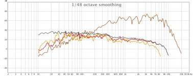

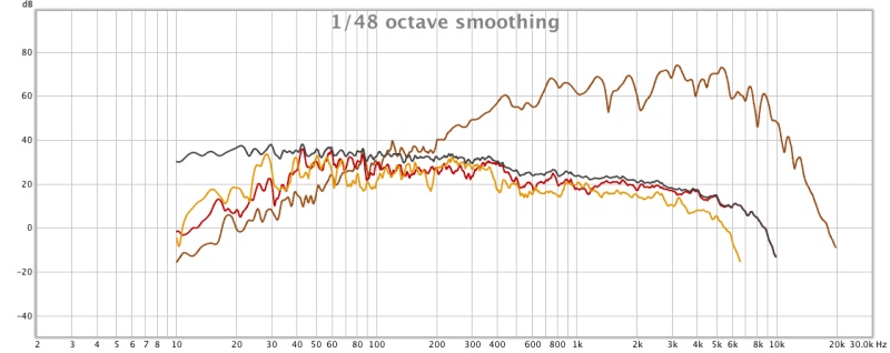

I didn't think I had a cable that would work for loopback but finally found one. The signal chain minus the speakers, mic and amp is +/- something like 0.5dB across the band, 0.1-0.2% THD, microseconds of group delay, so it doesn't seem to be a major contributor.
Yes, proper procedure to ensure test gear is working well.
I think what I'd do next is to examine speaker performance from loud to soft, step by step. You might find a knee-point below which the speaker is working notably better. that will be a hint for what to explore next.
I'd also try a 50-Ohm resistor in series with the exciter to see if impairing the amp damping influence on the exciter matters. Nice to run an impedance curve on the exciter - all you have to do is read the voltage across the exciter when the 50-Ohm resistor is in series (doesn't have to be calibrated, you just want to see where the resonance(s) show up in the electrical back EMF... make sure you know which is the ground side).
Then two exciters, push-pull to explore that 2nd harmonic issue.

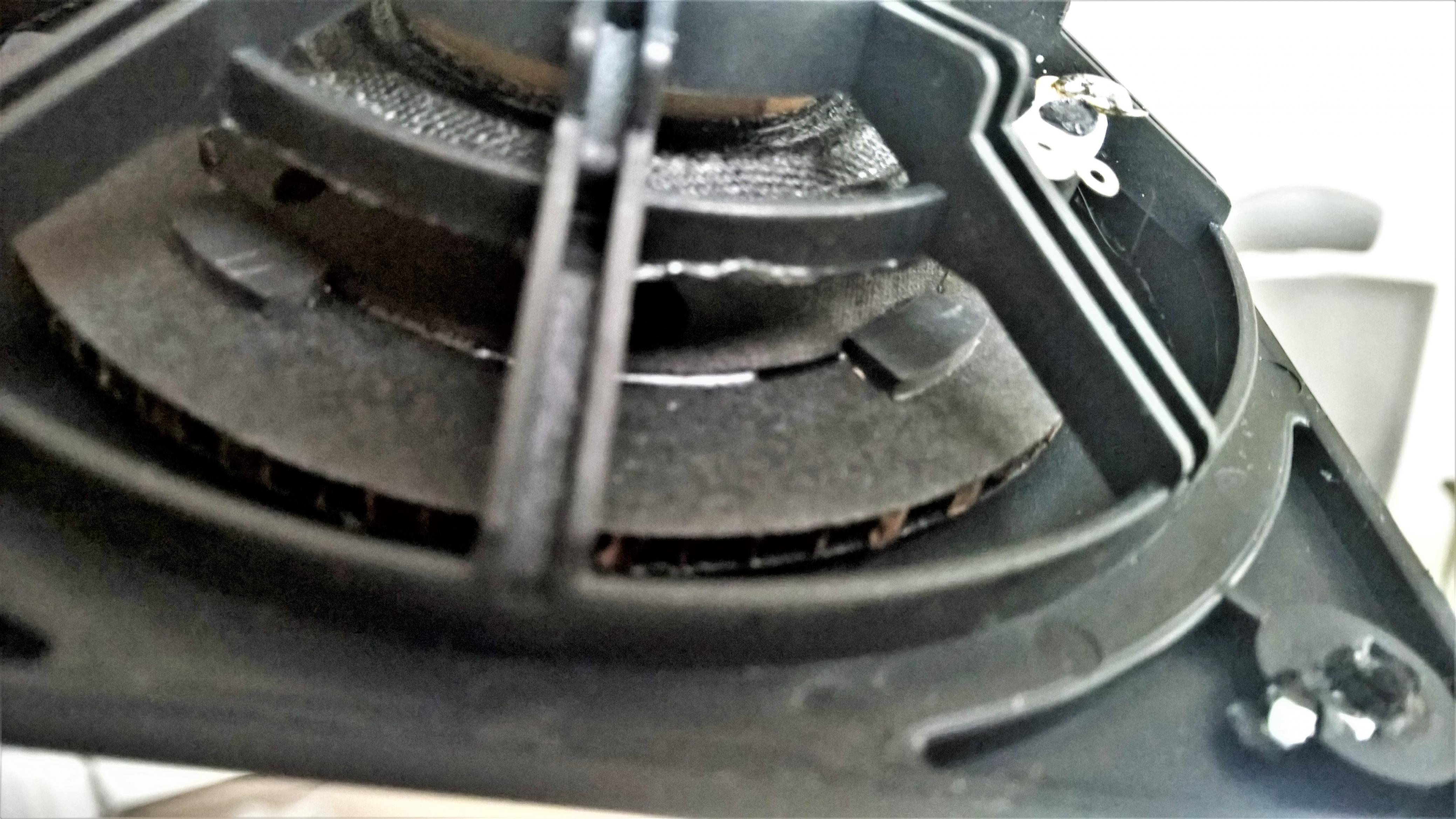

I am attaching a picture of a back of small BMR speaker, which works on similar principle and the membrane is of size about 4 inch. You can clearly see, that there are two layers of relatively thin paper with a not so thick honeycomb in the middle.
The overall thickness of the sandwich is around 3-3,5 mm max, so perhaps you could try to focus on something less stiff, less thick and more cardboard like 🙂
