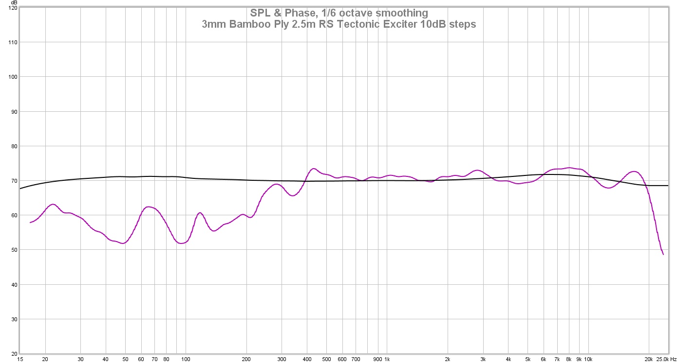

For interest here is a 3mm bamboo ply panel measured at 2.5 metres and driven by a Tectonic Elements exciter.

Panel Size was 380 x 530mm.
I had the panels cut by ponoko.com in both 3mm Bamboo Ply and in double layer corrugated cardboard.
Nice , 380x530 still a reasonable size. although it servers more as a mid high freq range driver. its amazing it extends to 20khz never seen exciters do.
but the mearuements are slightly smoothed 1/6 is pretty heavy and 10 db increments is rather heavy to, both makes the plot allot smoother then it is
is there any effciency? i know its hard to measure when it is not calibrated 🙁 just like my setup i recon your rew is not calibrated either ? since 70 would be somewhat low. would be 76 at 1 meter

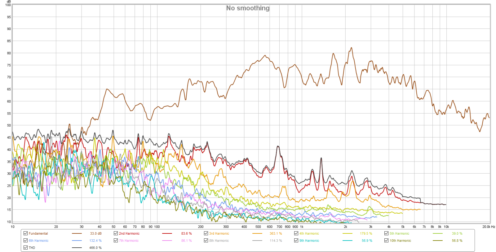

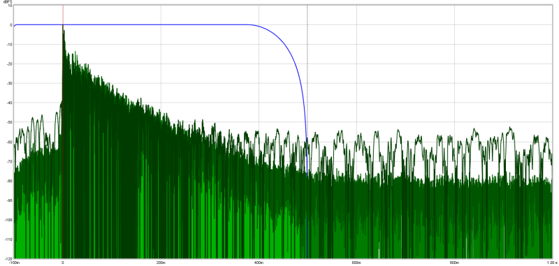

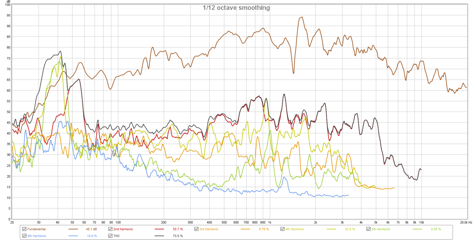

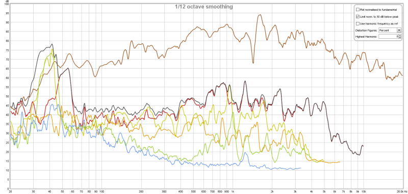

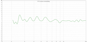

Distortion. Also including IR even though it seems like gobbledygook. Group delay might be right, I'm not sure. Doesn't look great, but perhaps we wouldn't expect it to given the physics of the speaker.
Most of that seems to be in the extreme low end. Crossing at 70Hz looks like it'd be reasonable. If I set the window to look at that frequency upwards, it says THD is 9.10%. At the moment I'm actually crossing at 120, which it calculates as 4.05% THD.
Maybe I'll play with EQing this flat in the next few days and seeing what happens to the distortion graph. Other reviews of DMLs seem to report that a measured flat EQ in the treble sounds subjectively too bright, so maybe this is not too bad of a place to start from. Framing and damping seems intuitively like it would help, but some of the papers posted earlier suggest that those would be more effective at taming the bass, unfortunately.
I'm also curious to try IR-based speaker and room correction, although it seems like all bets might be off with that approach.

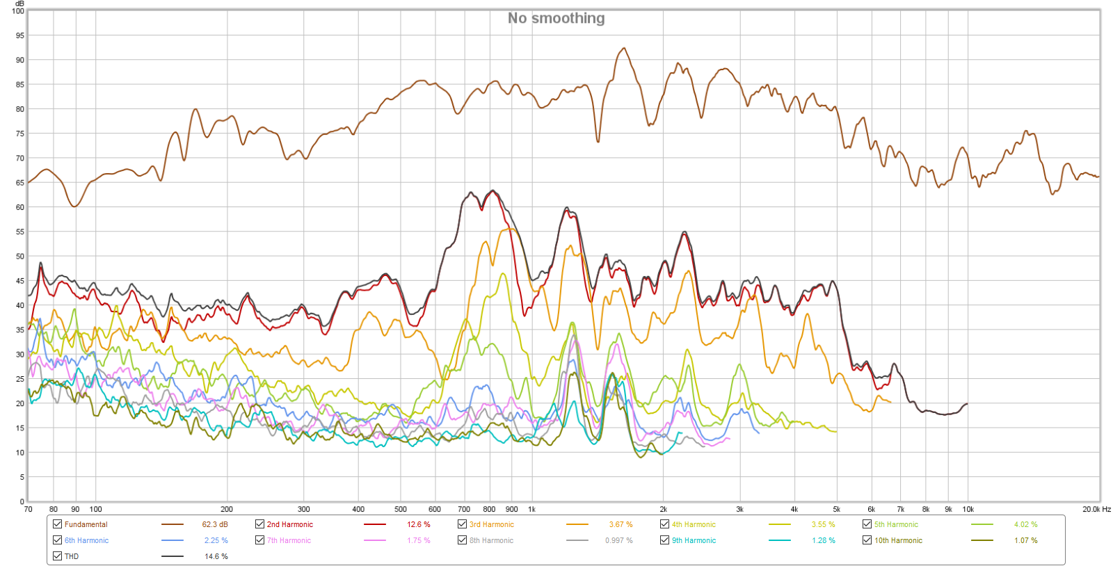

With the exciter facing outwards, response is flatter and distortion is worse.
I could hear some buzzing somewhere in the middle of the sweep, which I imagine might correlate to the peak in distortion. Maybe if I'm lucky that has to do with the panel resting on a ragged edge of honeycomb (very ugly sound if you scrape something along it). If that's the case, it ought to get better with better mounting. Otherwise, maybe it's down to the honeycomb being too thick, the exciter itself or the technology... or other ideas?
Distortion is indeed really high , the peak is the resonance of the whole panel usually , but distortion should be far less then 5% and for sure lower the 70 🙂 haha another thing it looks like the efficiency is really really low and you might be overly driver bing the exciter itself ?

Yes, truly awful-looking distortion measurements and riddled with nasty resonances. Proves once again, speakers you make yourself always sound great to you but sometimes only you.Distortion is indeed really high...
But what can be done? The foam-core poster-board multiple-exciter speakers in another thread measure a tiny bit better (3-5% THD). Maybe the paper facings help damp their racket a bit - and we also see results for damping globs stuck on.

hmm i get with the paper foam board and diy motor, definitely under 4%, i will make a new one tonight and post some measurements. i form the foamcore into an aerofoil or half a cylinder to increase stifness. spl matches my 12 inch woofer in OB so not to shabby. only anoying thing is the foamboard has to dry a pretty long time, so i hope ill manage.

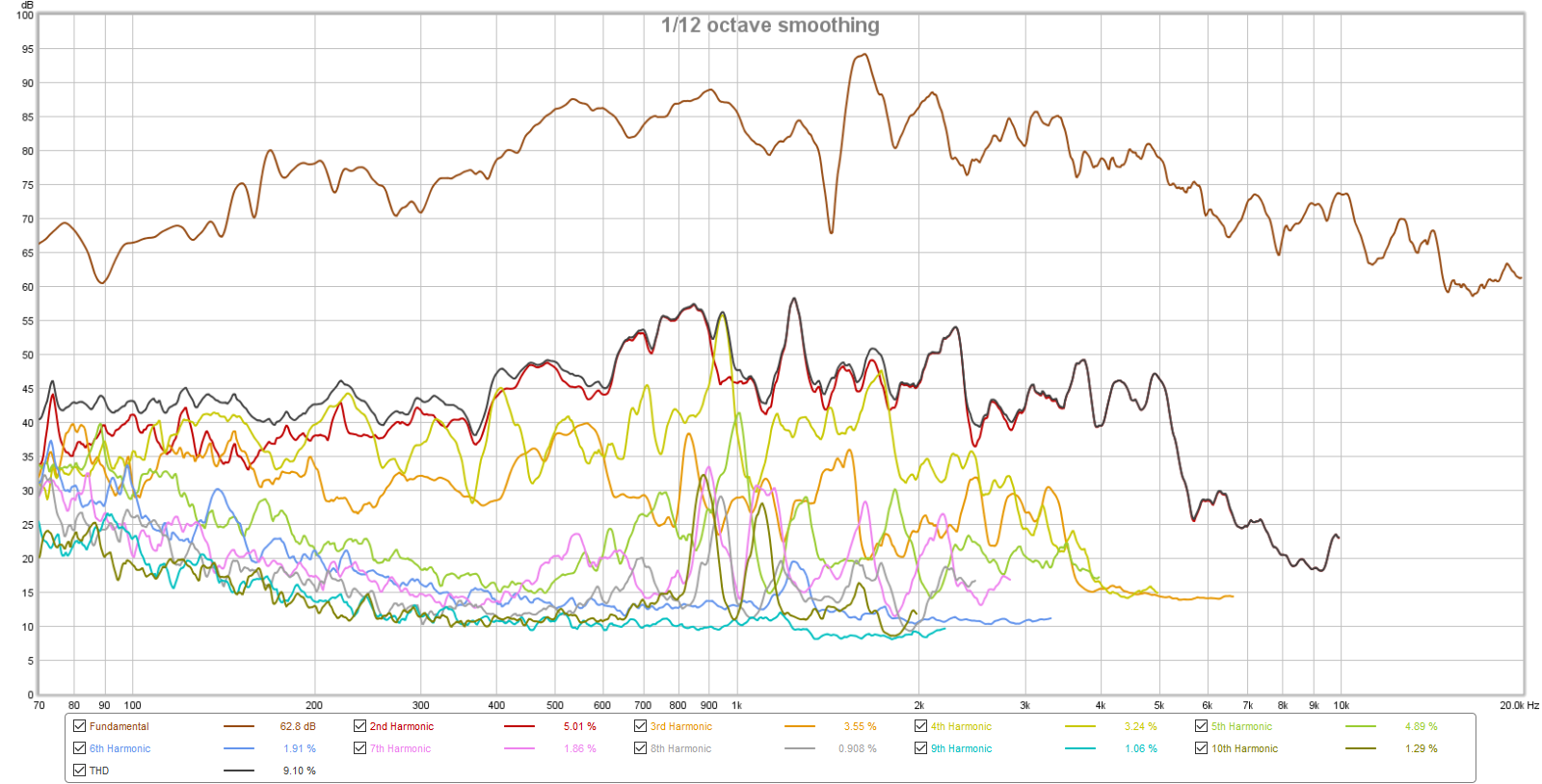

Ben, don't thank me for following through. I responded to the request for distortion not because I was goaded but because it was reasonable and because it was another chance to allow you to participate in the thread without being rude and condescending. It failed.
WrineX, to confirm the over driving hypothesis, I tried playing Chet Baker - "Round Midnight" with REW's SPL meter open and found that I was running the frequency sweep probably about twice as loud as I ought to have been. Fixing that, the resulting graph has as similar overall shape...
... how do I get REW to report THD over the whole range though? I noticed that if I accidentally clicked on the far left of the graph, clearly below where the panel is operating in any kind of reasonable regime, it'll report THD at exactly that frequency - for example, around 500% at 20Hz. Heh.
For the record, picking a couple other points along the spectrum, at 223Hz it's 5%, the peak at 557Hz is 0.477%, trough at 756Hz is 2.15% (with a local peak in distortion), and generally it looks like below 1% from there on up.
