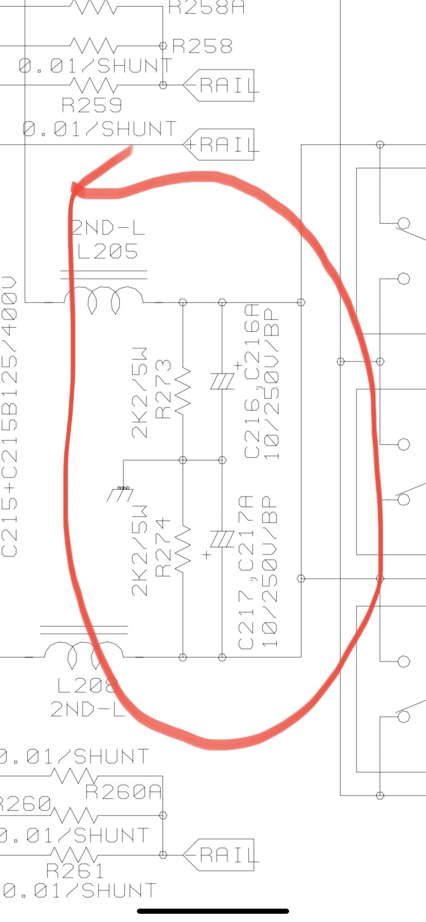

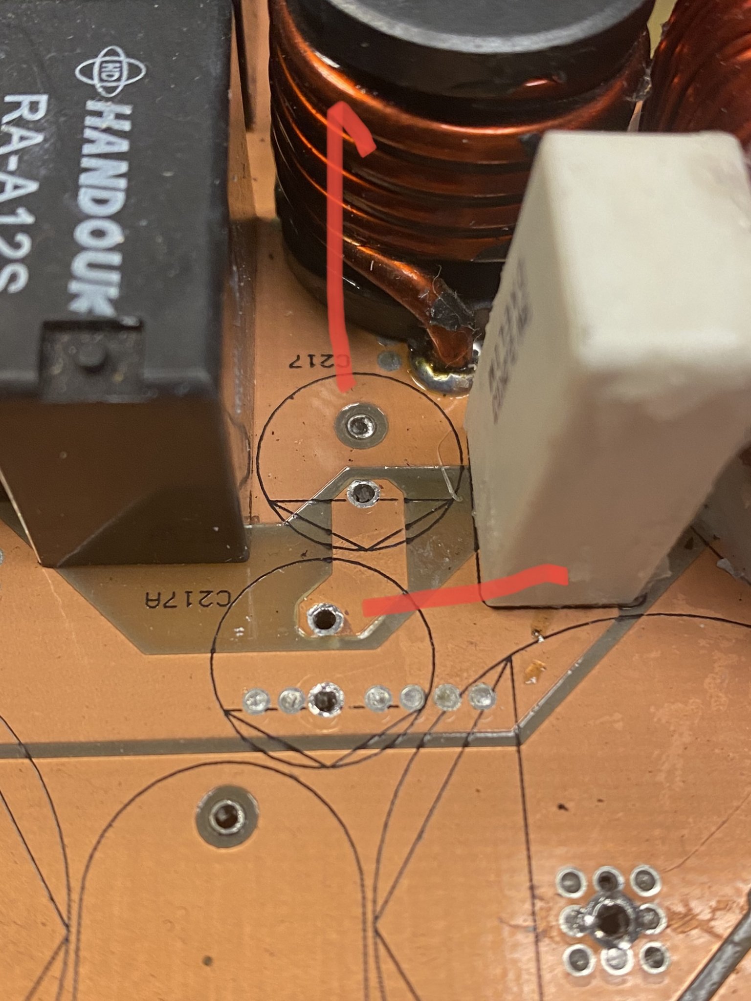

I’m onto the next section of this amp . The outputs filter caps are 10uf 250 volt caps which are impossible to find .
There are a total of 4 caps 2 caps are in parallel with each other same with the other 2 .
My question is can I get a total of 2 caps . 22 uf 250 v film caps to replace the 4 10 uf caps and hook 1 lead here and the other lead here as shown ? Since space is an issue . Or will this not work ?

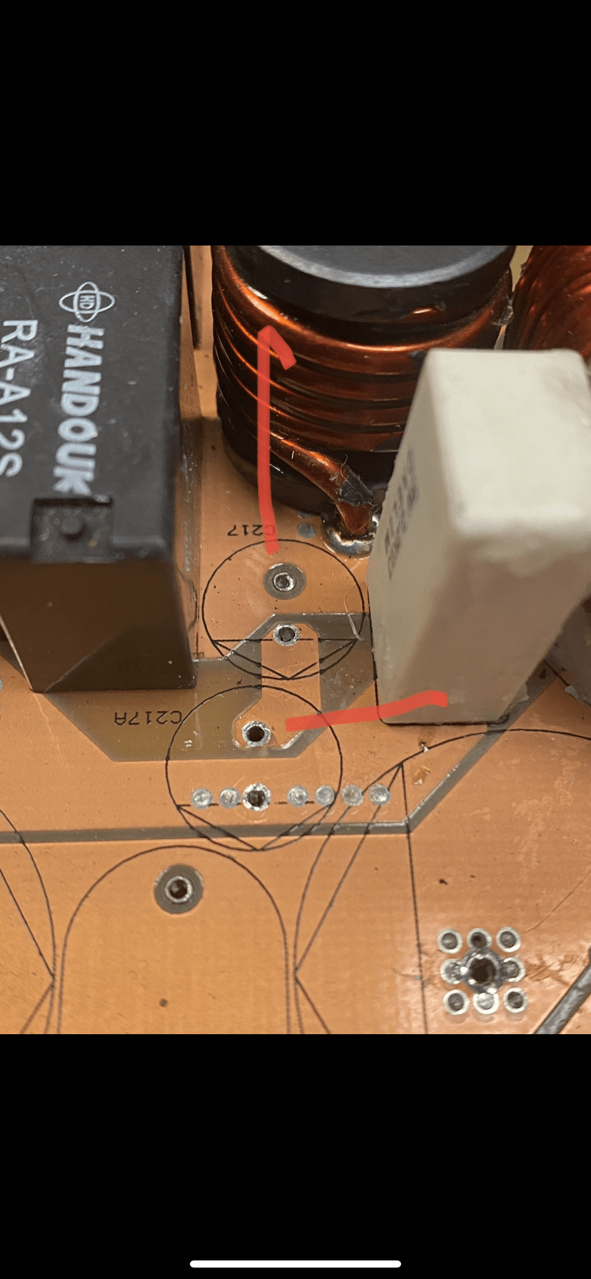

In the schematic the output filter caps appear to be in parallel. The originals are 10uf 250 v .
i ordered 4 caps total 22uf 250 v.
can I use 2 per side and use both positives soldered to the board as shown and hook the negatives together to make the new filter caps ?
