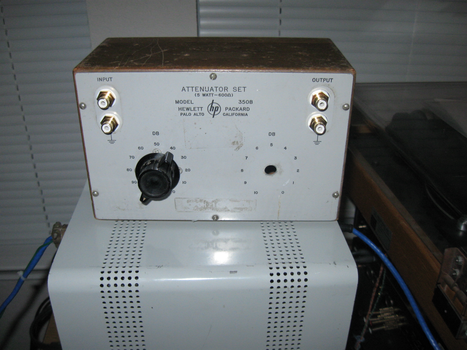

Your point about level-matching is critical- I turned a lovely Magneplanar speaker into something unlistenable by changing the NP electrolytic tweeter cap to a lower ESR polypropylene.
In a high impedance circuit, the ESR ends up being negligible. That allows one to set up comparisons for listening much more easily. The Bastard Box allows one to compare an extraordinarily expensive Teflon V-Cap to a cheap Radio Shack NP electrolytic in the first two switch positions, then has 12 positions of the switch which are randomized.
