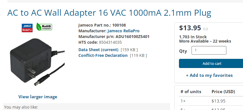

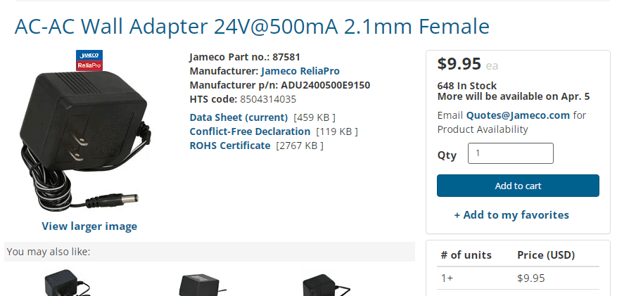

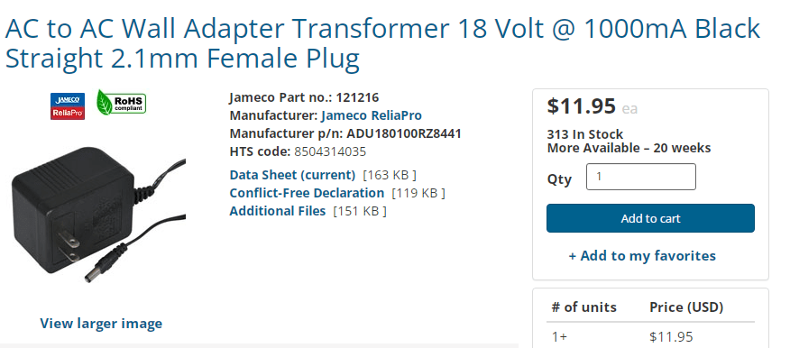

Tom, here are some AC-AC wall warts offered for sale at Jameco's store in Belmont California, and also on their website. You could try a test order from their web store to discover whether they'll ship all over North America; perhaps try Mexico or Canada or Barbados. Another way to find AC-AC warts is to search eBay and AliExpress and Alibaba for "CCTV transformers" ; apparently a big piece of the closed circuit TV hardware market is standardized on 24VAC power input, through barrel jack connectors.

Interesting. I wonder why the distributors turned me down then. I did look at Jameco back then. Maybe the requirements have been relaxed. I just had a quick peek at Digikey. They now have plenty of Triad brand wall warts now in the AC/AC power supplies section. Go figure.

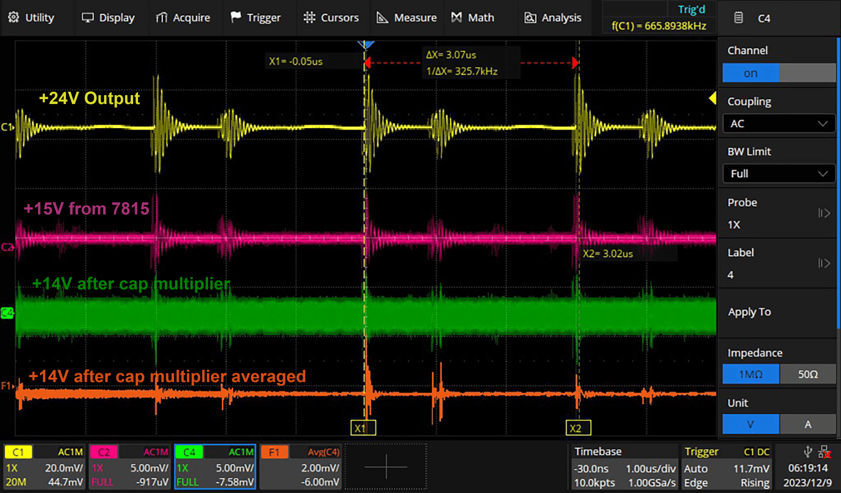

This is a screen shot of the AP500 screen; the P3 input breadboard with the ZTX NPN transistors, without the jfets (1k resistor in their place).
Two 12volt gel cells are in series, to KA7815 regulator to the P3 input breadboard.
The breadboard is in a 8 X 8 X 4 J box bonded to the analyzer ground.
The cookie tin still has cookies in it.
At this point batteries are looking good. I suspect that the jfets and more so the cartridge will dominate the noise.
