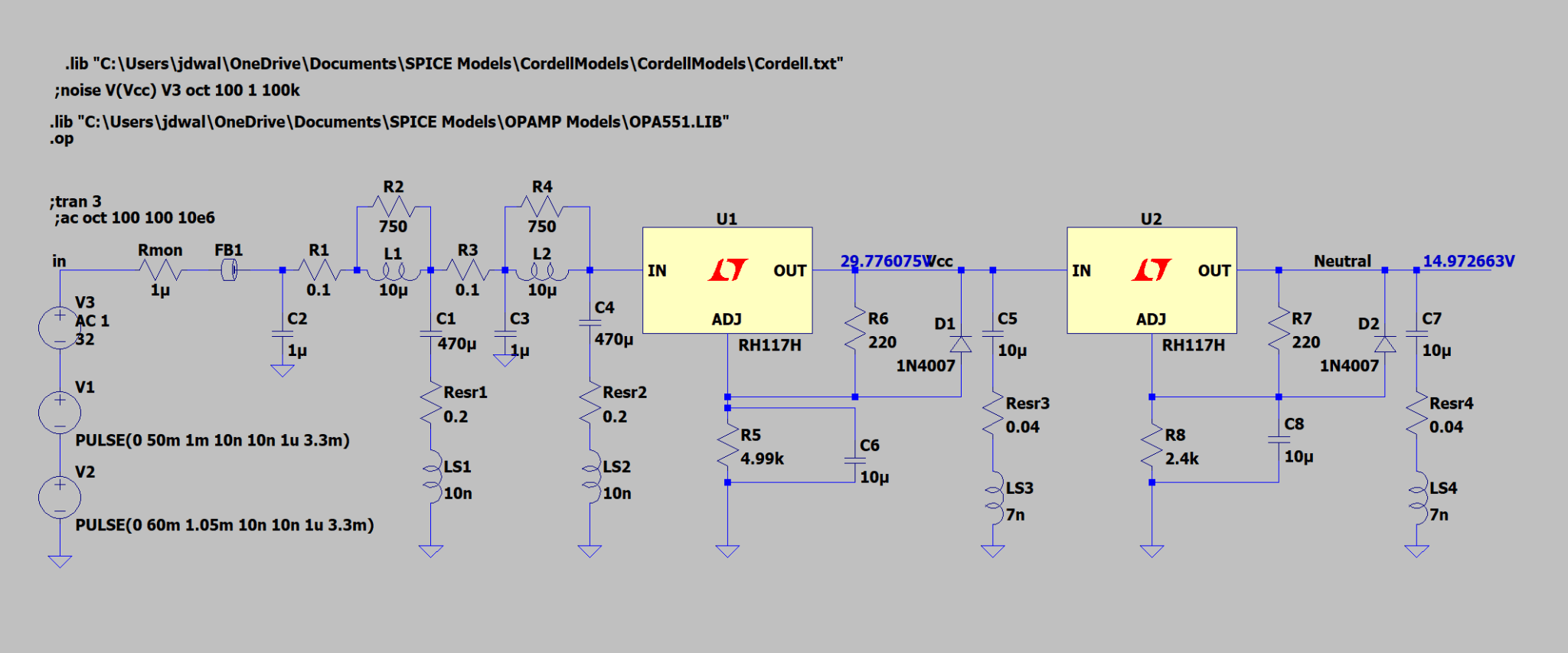

The Pearl 3 needs +/-15V power. Hmmm, perhaps there is a wall wart solution which would save space and money. An old HP Printer of mine bit the dust and it has a +32V/5A supply. Maybe a filter and rail splitter. Here's the problem:
I'm not so thrilled about the idea of connecting a synthesized ground (a/k/a rail splitter) to a phono stage. Including the possibility of shooting a third of an ampere through the windings of a moving coil cartridge, if the rail splitter circuit fails.
The famous Victor very low distortion oscillator uses a 35V supply to synthesize +/-12V (or 15?) with a quite simple circuit. It still manages -150dB THD. Worth a look.

Doesn't the synthesized ground have to source and sink current? Each channel's 4xJFET first stage squirts approximately 12 mA into the ground network (schematic in post #1 of the Pearl 3 thread). Are you confident the LM317 called "U2" is able to sink 24 mA?
You may wish to pursue the idea of shunt regulators rather than series; shunt regulators can source current and also sink current (within limits).

How about an AC wall-wart and a simple linear power supply like Rod Elliott's ESP-05 Mini? AC wall warts are not common but I have picked up a couple (16V AC) at car boot sales for a song. Creative Labs used to use them for a PC speaker system.
Here on diyAudio there's a project with schematic and Gerber files called "VRDN". It takes an AC-to-AC wall wart input, and produces +/- VOUT bipolar supply outputs at 1.5 amperes each. You get to choose anywhere in the range (11V <= VOUT <= 20V). A suitable wall wart for Pearl 3 applications might be the Jameco ReliaPro ADU150100RV0360 (link). Of course 1.5 amperes output capability exceeds Pearl 3's requirements considerably, so you could consider cheaping-out on the heatsinks and the total bulk filter capacitance. If you know what you're doing.

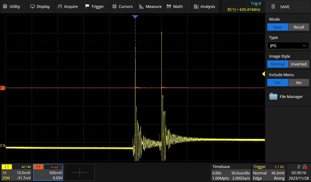

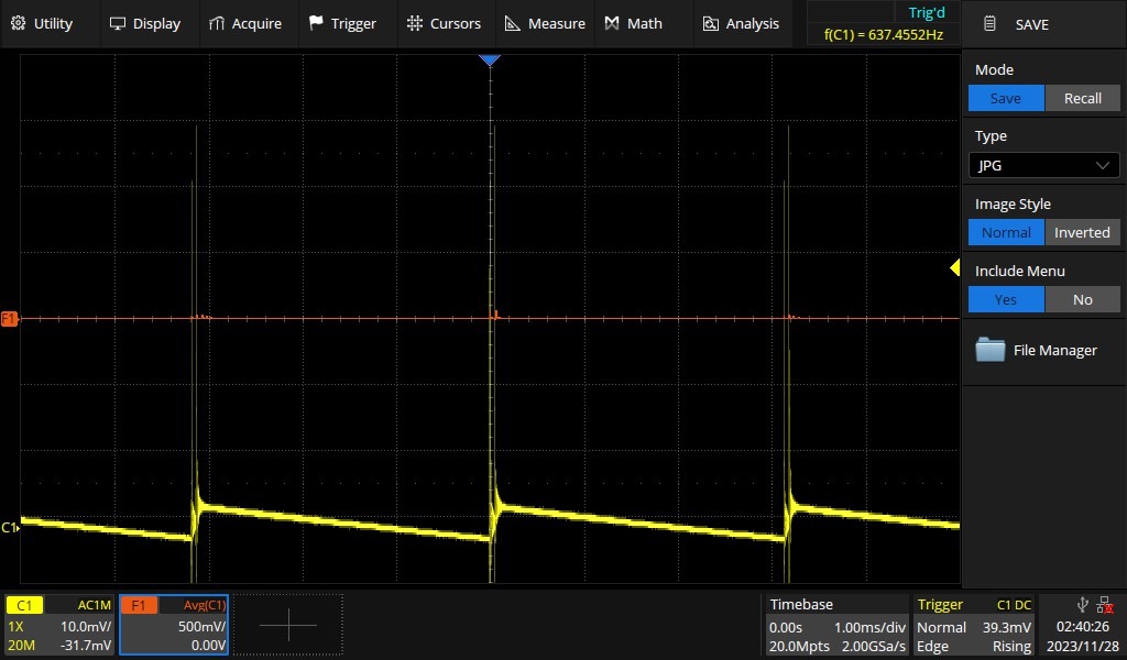

I'm not sure what current you were drawing from the wall-wart in your original pictures,
but most SMPS start to chirp ( become discontinous ) at loads 100's of times less then they were designed for.
Drawing milliamps out of a 5A SMPS at low noise and low currents might be difficult.
