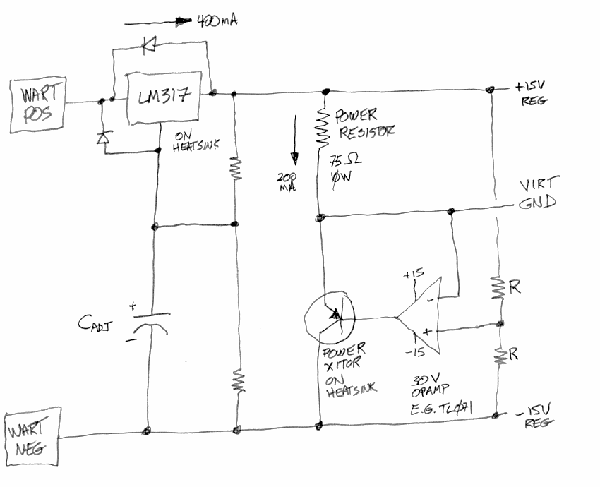

The Pearl 3 needs +/-15V power. Hmmm, perhaps there is a wall wart solution which would save space and money. An old HP Printer of mine bit the dust and it has a +32V/5A supply. Maybe a filter and rail splitter. Here's the problem:

I've been using a 24VAC wall wart to power my pre with great success. The AC wall wart (of your choice) feeds an adjustable 317/337 based regulator. This can also be used with a split tranny. The values can be easily changed to get any +/- that you'd want. I'll send you the gerbers if you want them. Note that the recitifer stage ground ties back into main ground at the source point to minimize noise.How about an AC wall-wart and a simple linear power supply like Rod Elliott's ESP-05 Mini? AC wall warts are not common but I have picked up a couple (16V AC) at car boot sales for a song. Creative Labs used to use them for a PC speaker system.
@audiosteve: I've tried that and it oscillated. This can happen if the currents drawn by each rail are unequal.

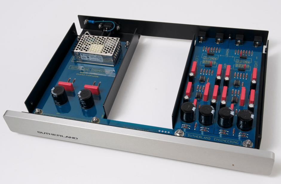

Didn't Sutherland also use a bank of batteries in one of their preamps.Sutherland did it.

Seriously? What oscillated? I've never had that problem. That makes no sense. I doubt the issue was with the topology. Please eelaborate if you can. Thanks.@audiosteve: I've tried that and it oscillated. This can happen if the currents drawn by each rail are unequal.

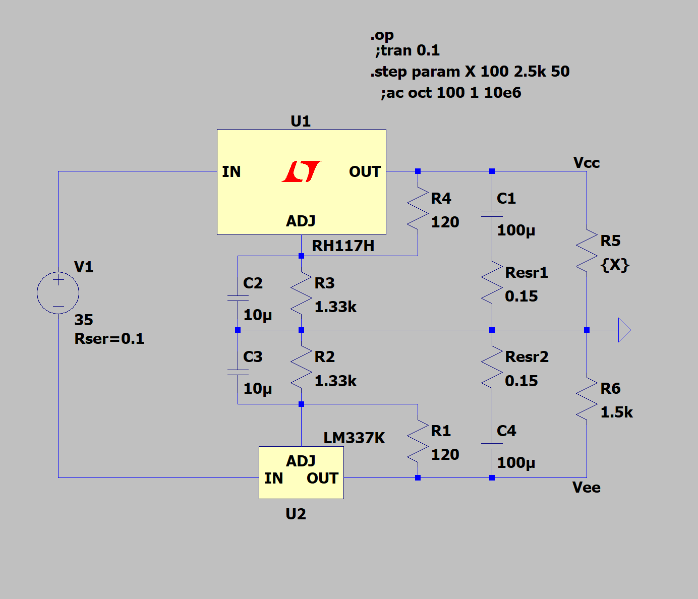

This is why you can't use LM317/LM337 as a rail splitter -- as the load on one changes, the voltage on the other moves in the opposite direction. It's a simple simulation changing the value of a resistor to mimic current drawn:
The LM317 needs a minimum load of 5mA to remain stable. This results from the change in transconductance of the pass transistor with current,

You are right...works only when both source current...Doesn't the synthesized ground have to source and sink current? Each channel's 4xJFET first stage squirts approximately 12 mA into the ground network (schematic in post #1 of the Pearl 3 thread). Are you confident the LM317 called "U2" is able to sink 24 mA?
You may wish to pursue the idea of shunt regulators rather than series; shunt regulators can source current and also sink current (within limits).
