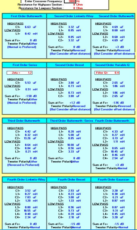

I still would appreciate clarifcation on what order my mid and woofer filters are. The schematic in post #16 shows the LP and mid range only have inductors.
How many orders can you have with one inductor as LP for mid , and two inductors in series for a woofer?
This is a great forum and the very knowledgeable members have helped me learn some basic XO design considerations. As I learn more I'm sure there will be more questions. Basically I thought the woofer filter is 1st order because there are only two inductors in series, with no other components, and they are equivalent to one 6.5mH inductor.
Thanks. In your post 26 attachment I saw it was labled 2nd order and thought that was due to the resistors. So I think I now understand that any filter with two components is 2nd order. I thought that replacing two inductors with one inductor, equaling the combined value of L1 and L2, would result in an equivalent 1st order filter.

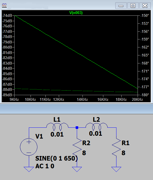

Henry, that's not correct. RL filters require two components per order, so four for second order... that's two inductors and two speakers (speakers are passive components).
Now i'm really confused. So my woofer filter with only a 1.5mH and 5.0mH in series is not equivalent to a woofer filter with just one 6.5mH inductor
