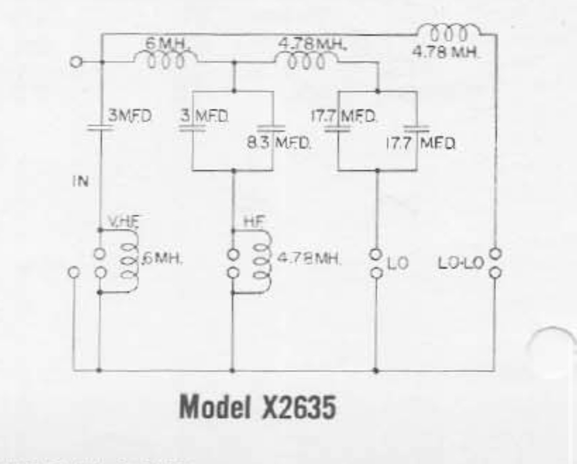

Can someone help me understand this 4 way crossover and help with selecting the inductors?
I’m trying to recreate the crossover used for the Electrovoice Patrician IV. I found a schematic of the crossover online (they’re potted) and this is it. Not shown in the crossover is a 16 ohm L-pad used on the midbass, tweeter, and super tweeter.
That “6 mH” inductor at the top that is in series with both the tweeter circuit and the 4.78 mH inductor for the midbass, someone pointed out that it made more sense for it to be a .6 mH. Which made more sense to me after doing the math, 0.6 would cross the tweeter to where it meets the super tweeter at 4250hz vs 425hz with 6 mH lol.

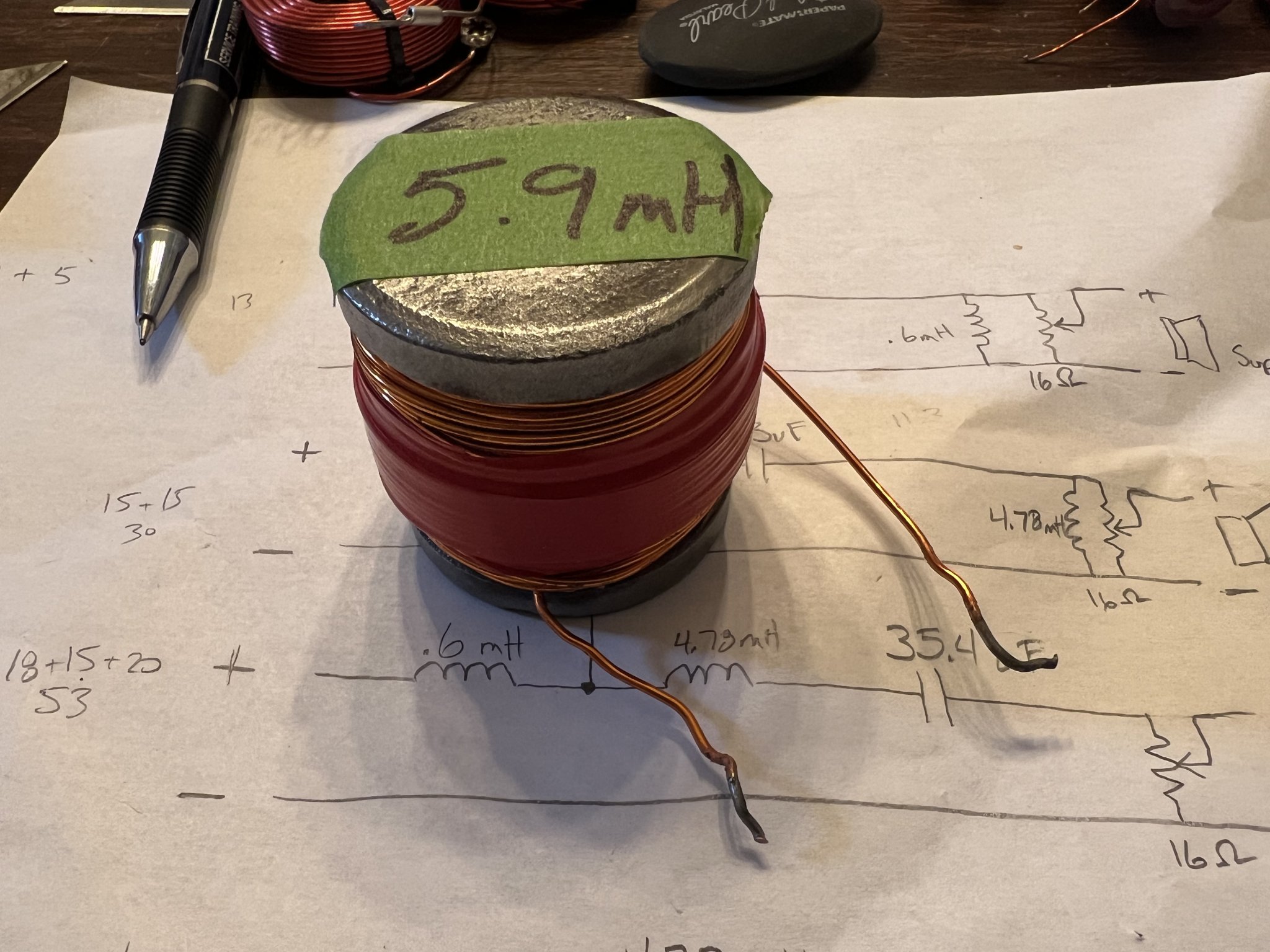

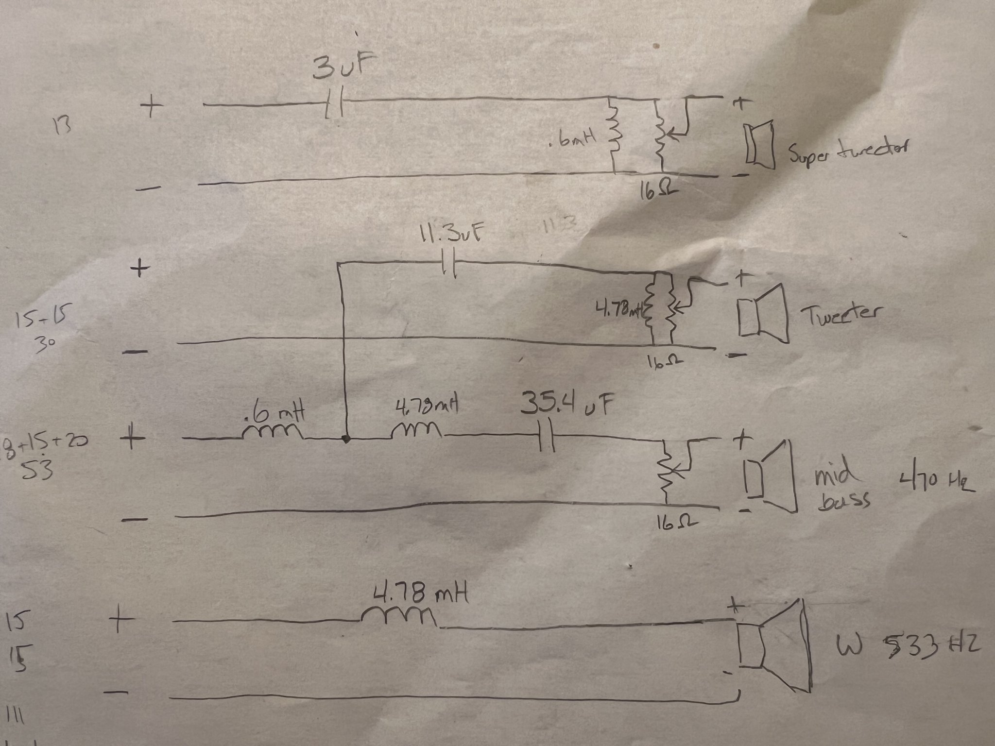

I drew it out to a form that helped me visually.
So I’m confused about the midbass circuit. Having a .6 mH in series with a 4.78 mH and then a 35.4 uF cap (two 17.7 uF in parallel as shown in the original schematic), wouldn’t that make the midbass play a band pass of just 280 Hz to 470 Hz, 6db slope? That’s a tiny amount of the spectrum. Am I understanding this correctly? All drivers being 16 ohm loads I’m seeing the high pass the 18” woofer at roughly 533 Hz, the midbass plays the same frequencies as the woofer at 280-470 (??? Doesn’t seem right).
Lastly, what inductors should I get. I’m thinking with a low pass of 533 hz on the woofer I can go with a large iron core. I have one here with a dcr of about 0.3 ohms. I need two 0.6 mH coils which I can go air coil. Not a lot of power will be going through these, the one in series with the tweeter go maybe 19-20 awg? The one in parallel with the super tweeter, 21-22 awg?
What about the other two 4.78 mH coils I need, the one in series with the midbass and one in parallel with the tweeter. Going with air core on those the coils will be unnecessarily huge, if I go with a thinner wire the dcr starts to rise and goes about the 5% of the Re rule (0.8 ohms in this instance). Should I go iron core on those? Or go air core, using like 20 awg and accept the higher dcr?

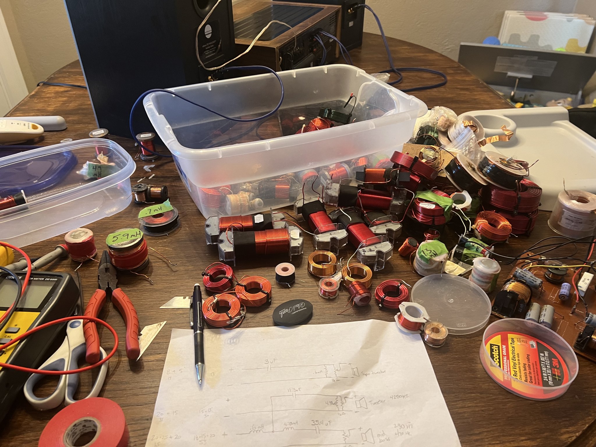

I have a decent collection of coils and have a good amount of magnet wire so I can wind my own air core, but have no issue just buying some iron core.
Example for the woofer circuit, I was just planning on taking this 5.9 mH iron core and taking it down to 4.78 mH. Looks to be 15-16 awg. But would love direction on what I can get away with as far as the inductors. I can’t see the need for an 18 awg 4.78 mH air core that weighs a few pounds being wired in parallel with the tweeter.

Most of these crossovers are tailored by try and error simply based on real fr response of the drivers used. If you use other drivers, you need to adjust values.
0.6mH is the only way. Otherwise there would be almost no signal to upper mid/tweeter.

This crossover network is definitely custom designed for specific drivers and their FR's.
With that 6mH issue solved as .6mH, it needs to be realized for the values to make sense -
the woofer is actually 8 ohms (not 16). The rest are 16 ohms. With that realized the C/O frequencies are roughly :
Woofer = 250Hz
Mid/Bass = 270Hz & 600Hz
Tweeter (so called) = 700Hz & 4Khz
Super Tweeter = 4Khz.
(as you can see, there are obviously response/impedance of driver issues as variance)

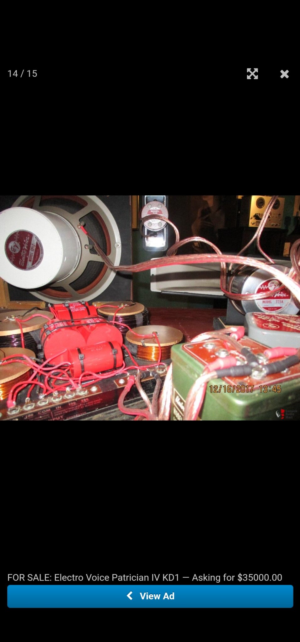

I think EV built a crossover with the parts they had plenty of. Looking at the scheme my first thought was: why all these identical values? But that is pretty ridiculous. Now my guess is the posted scheme, obviously being old, could be wrong. Where did you get it?
Is it this monstrosity?

As far as the series woofer inductor I don't see why you can't unwind the larger coil. DCR won't be critical unless it goes high and adds loss. You have trim pots on all other drivers so as long as you don't seriously attenuate the woofer it shouldn't matter. It's not like a notch filter where DCR can effect Q so you have to look at R + DCR to model the effect.
Good luck and cool speaker to be working with.
Rob 🙂

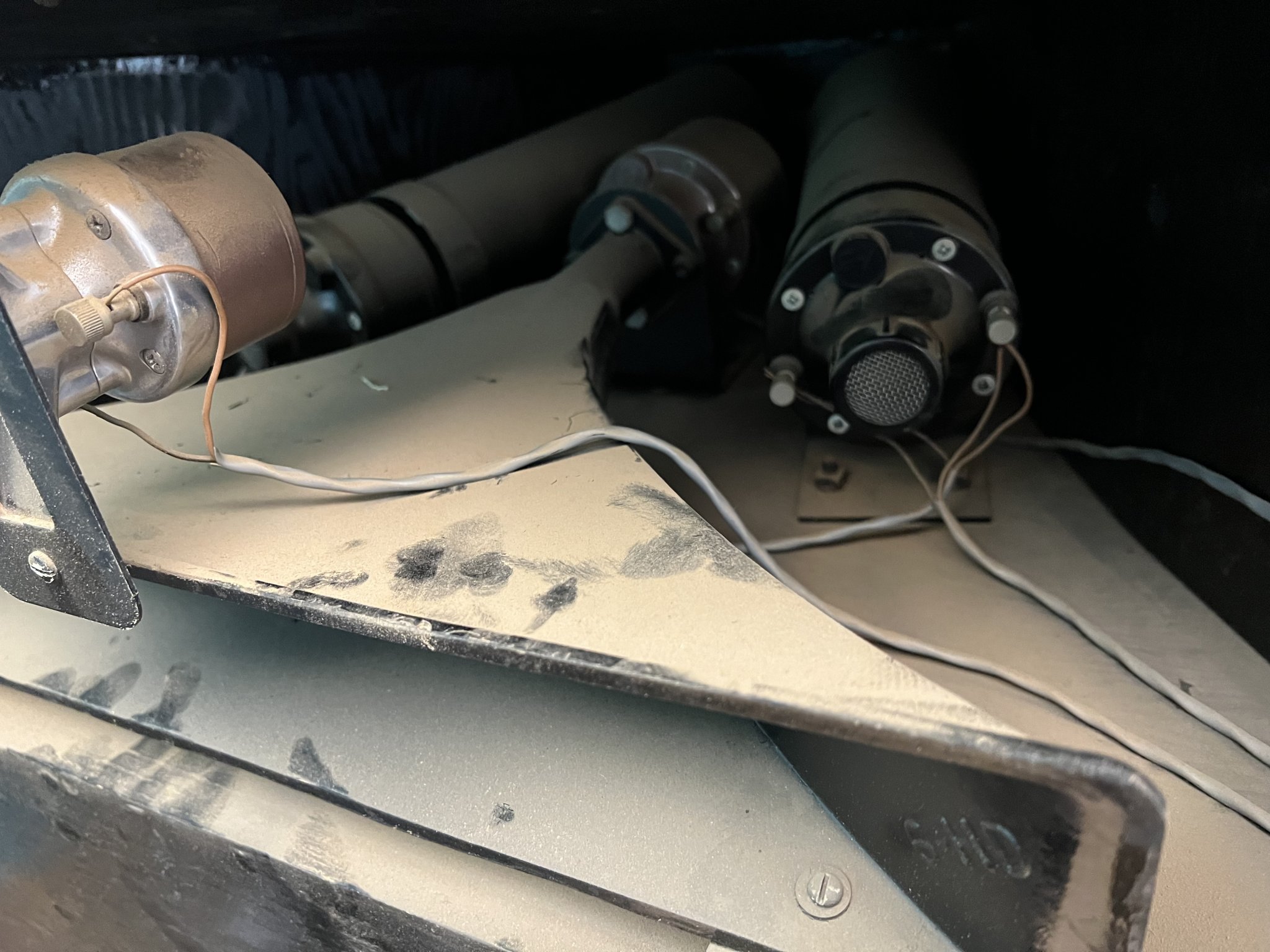

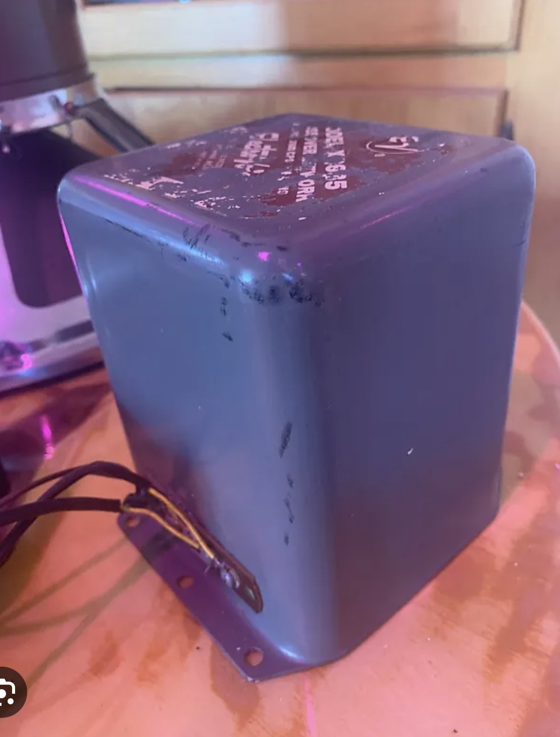

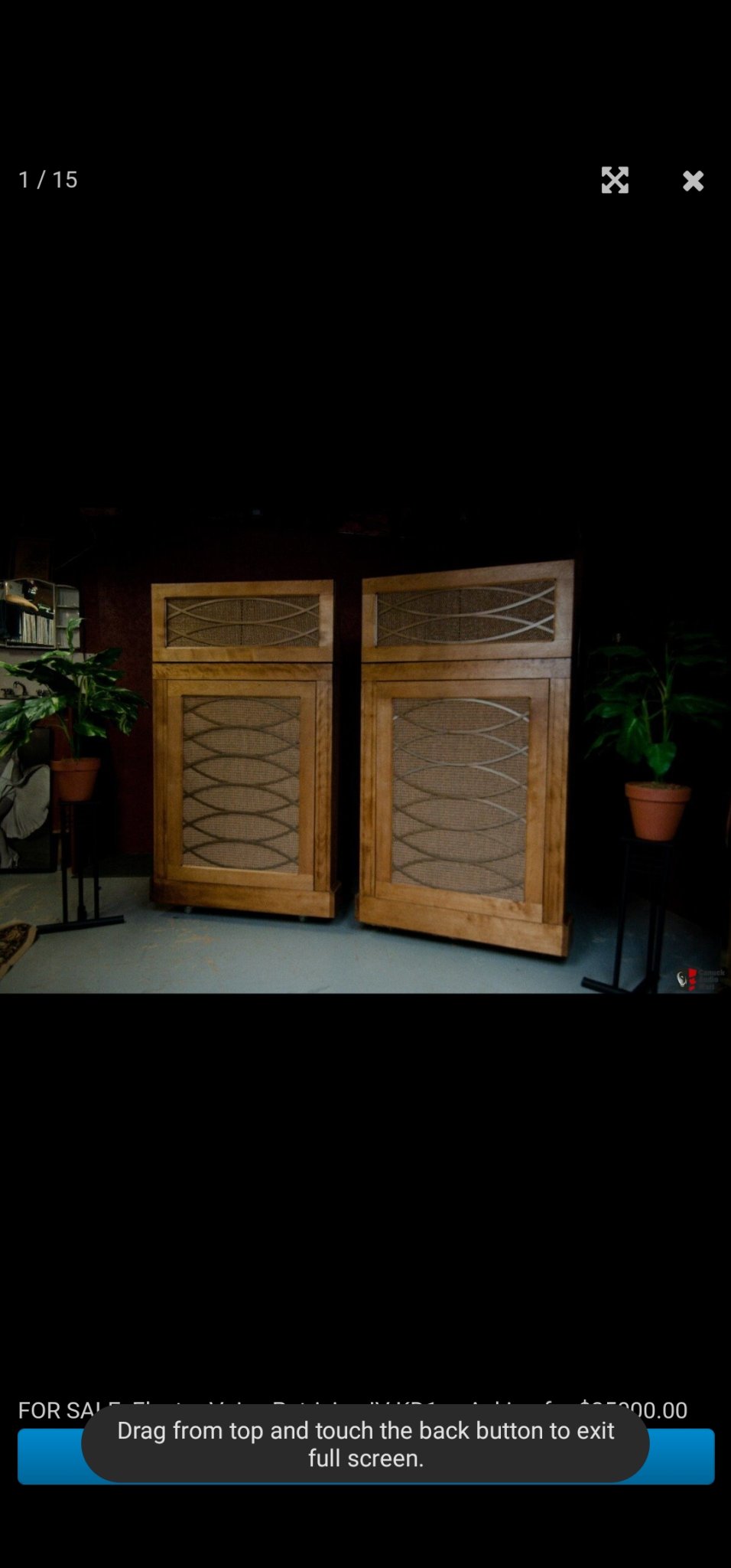

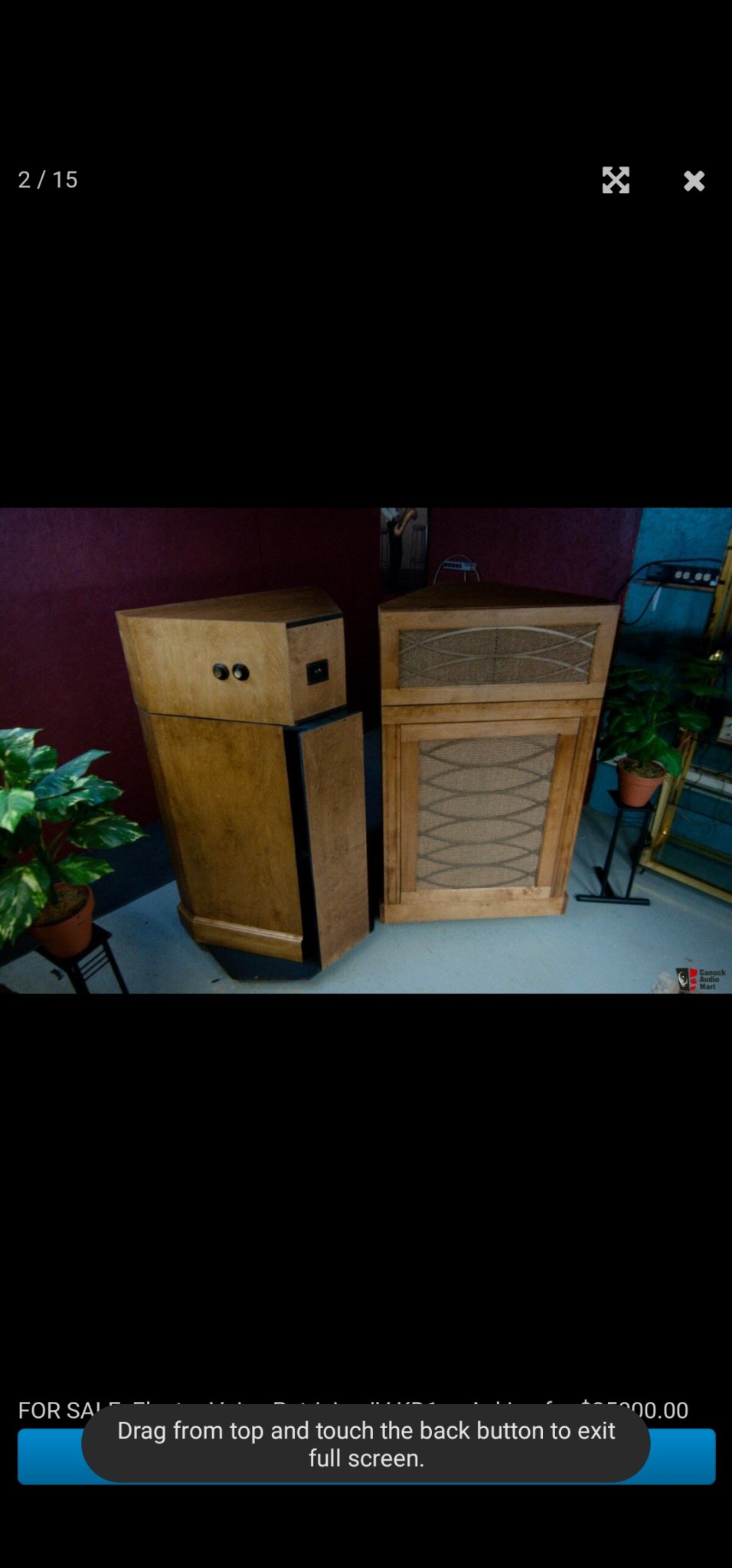

Here is an image of the original crossover.

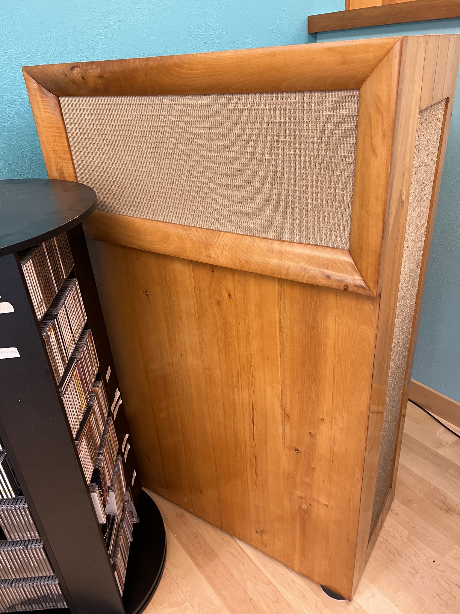

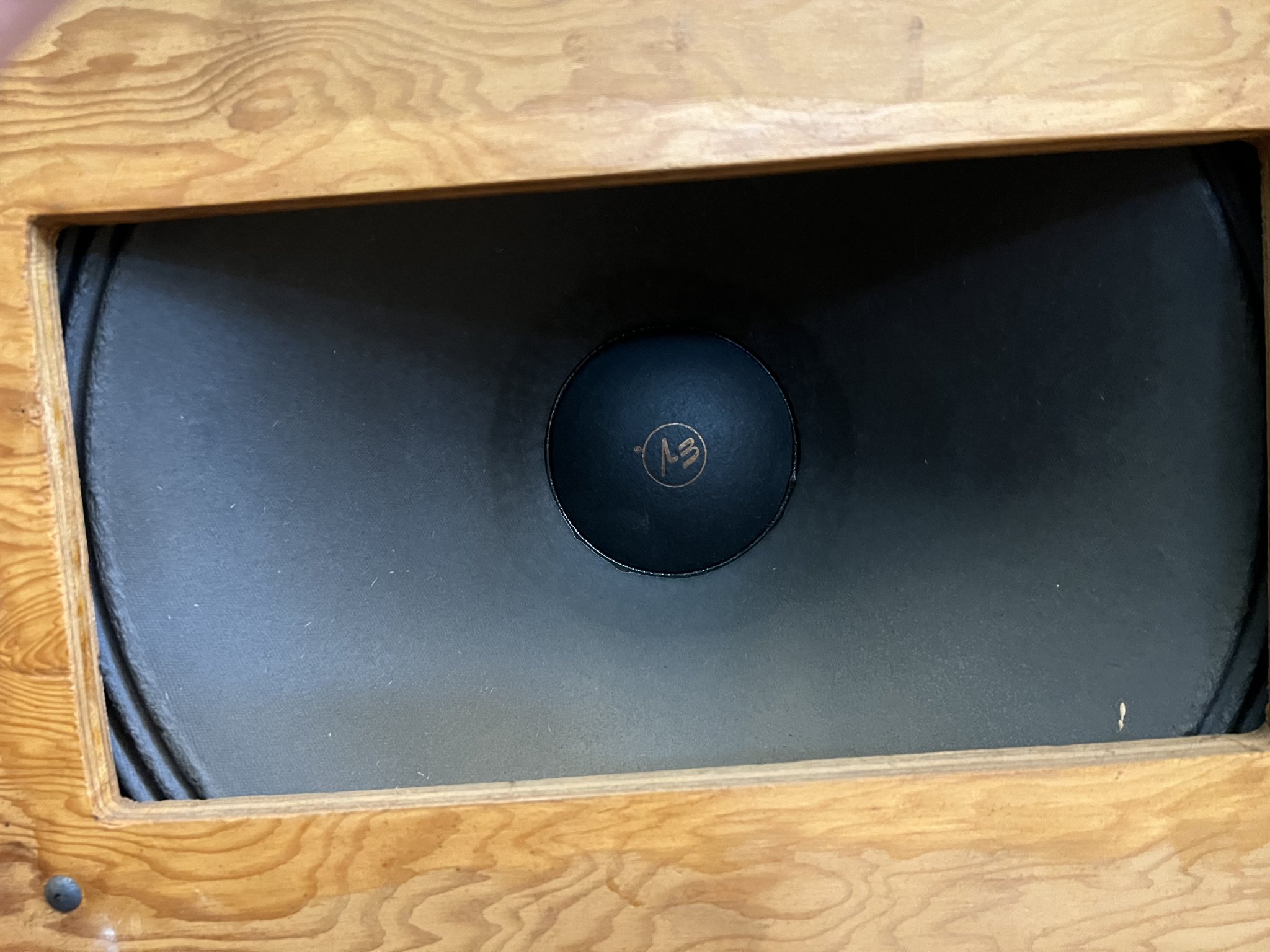

Lol, that is indeed it, a huge horn, he got the kit though. Home built, clearly the one in your photo there has had an updated crossover. Here is his actual speaker, needs dusted out of course. Odd that he’s hauled it from home to home for the last 60ish years and has never heard it.
