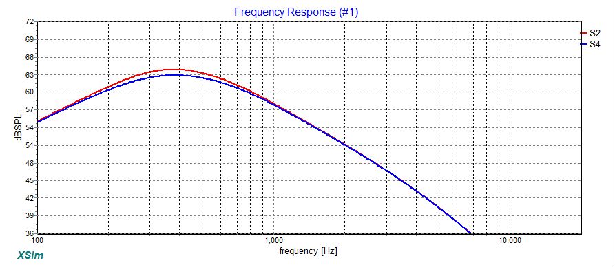

DCR of 2.3 ohm, is that too high? I read there was an unwritten rule about not going above 5% of the Re of the driver, but then why would they make this inductor, that would be over 40 ohms for an Re. I just remember people saying that air core is better for midbass and higher frequencies.

This compares using a 2.3 ohm inductor to one much lower. The difference isn't large...DCR of 2.3 ohm, is that too high?
1. on the lower tweeter (HF). The crossover frequency goes up.
2. on the upper woofer (LO).

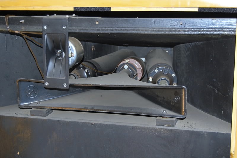

Slightly OT, but this midrange arrangement is really unusual. At first I thought they feed folded bass horn though those ~cylindrical transmission lines, but looking at additional photos I realised they have their own 180 deg folded exponential horn, not unlike a megaphone, into which upper midrange and HF horns are nested.
