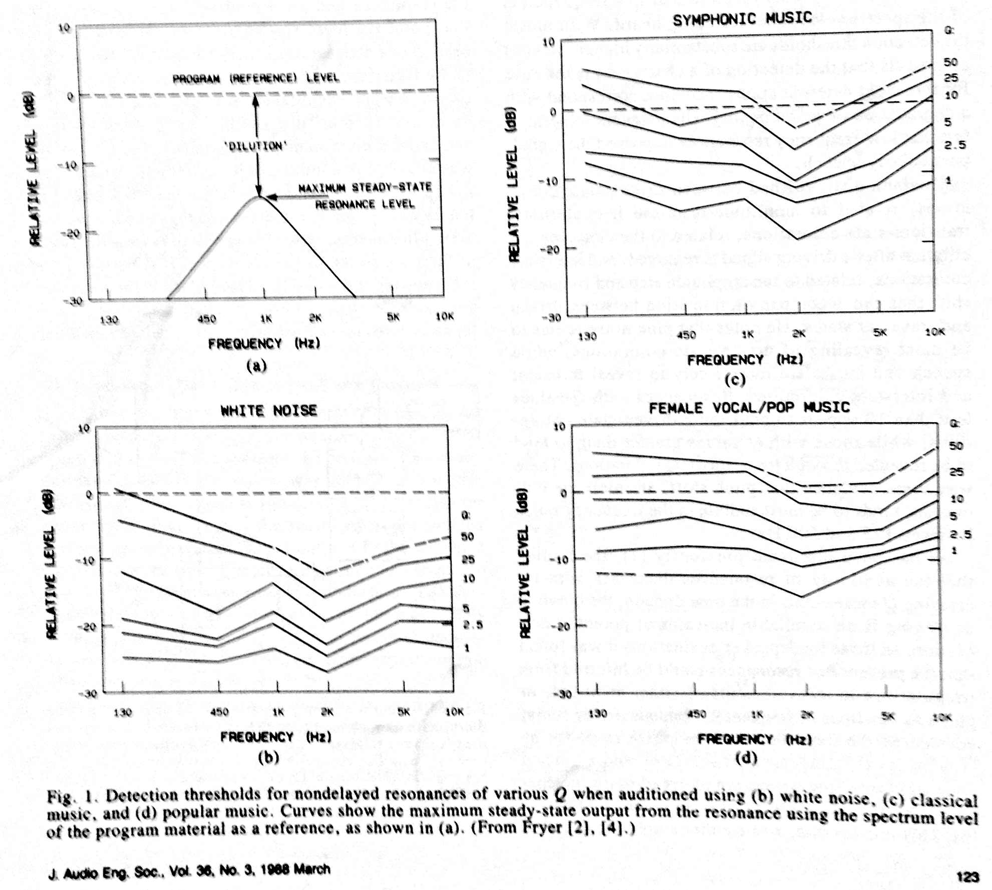

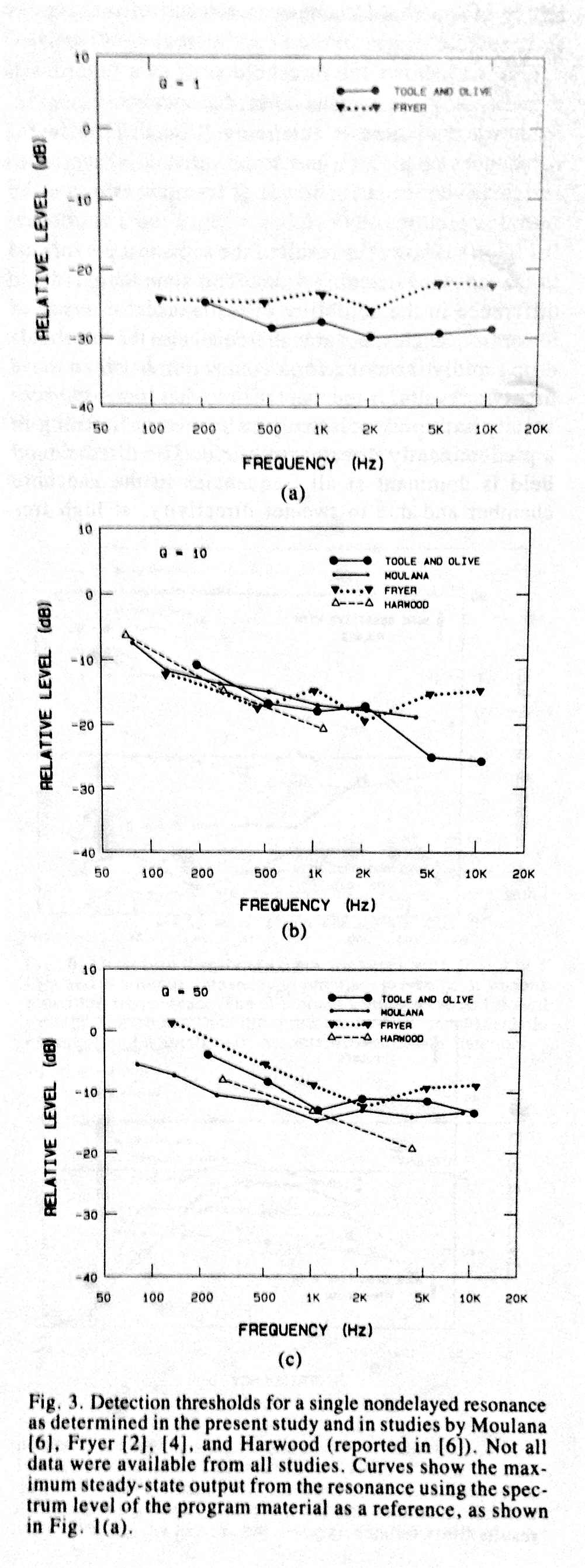

The literature supports David and Oliver in that quieting a box at frequencies below about 500 Hz calls for stiffness to push the resonances above this frequency, and at higher frequencies around 1 kHz it should be less stiff and very lossy (damped) to stop the sound transmission. Also agree that high damping is needed to suppress the cabinet's output at critical frequency where the panel resonates, and David commented on as being near transparent if there is no damping.
So undamped heavy walls alone are worse than light damped walls in the mid range and above.
However, this is an incomplete assessment. The Harwood curves are not a complete or up to date set of targets when assessing resonance audibility. I don't agree that we can use Hardwood to excuse significantly more resonance in the lower frequencies, and therefore justify a light/damped wall approach as the best solution. Harwood didn't have the benefit of the knowledge from numerous studies since then.

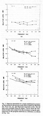

In "Modification of Timbre by Resonances: Perception and Measurement", Toole and Olive determine the audibility thresholds of resonances of various Q over frequency, and compare their results to Harwood and other earlier studies. I've attached some of their results along with outcomes from Fryer.
They show that higher Q resonances can have significantly higher levels before they are audible, compared to lower Q resonances. They explored this exhaustively with music, white noise, pink noise, and also looked at the impact of room reverb vs headphones. The findings were pretty consistent. So by increasing loss through adding damping, this decreases Q and you need to suppress the resonance peak level (which damping will do) more thank at high Q to make it inaudible for a given frequency. Olive found a rough figure of merit that each halving of resonance Q requires an approximate 3 dB reduction in level to maintain the same detection threshold. So the point here is that a higher resonance peak can and will be OK (within limits) if its a higher Q.
Olive and Fryer and others were also a bit less charitable than the BBC, the BBC allowed relatively higher low frequency resonance before audibility than any of the other studies.
So I think there are others ways to skin this cat.
Resonance frequency can also be increased by bracing, which makes the panel appear smaller. It doesn't have to be through panel composition alone. So, using mass to control low frequency resonance and significant bracing to push up the critical frequency seems to me the best approach. Damping can then be used to trade off Q vs level.
As posted earlier, the internal box absorption significantly lowers air borne excitation at upper mids and this can't be ignored. I reread the Harwood paper and it doesn't appear as if any filling material was used in their tests so this factor wasn't included. By having less airborne excitation, there is less resonance excited. Pushing the critical frequency into a frequency where the box is highly absorptive will show much better results in suppressing airborne resonance than the examples in the Harwood study.
There is still the issue Oliver mentioned of structural coupling through the driver frame, but this can be reduced through decoupling mechanisms:

So I dispute the Harwood results are the last word. I think its more than feasible that a heavy, heavily braced box with targeted damping can easily exceed the performance of the BBC ideal. It would take design and measurement, along with applying more representative targets which factor in resonance Q.
In my own experience, I built such a box. 1.5" MDF, extensive bracing, epoxy corner fillets lined, wall with epoxy to further stiffen and then added very lossy boundary layer and I find it dead quiet. I have an accelerometer here but in 10 years use never found the need to bother testing this cabinet with it, its obvious to the listen. This observation may not satisfy the skeptical, but I know what resonant and inert boxes sound like, and am comfortable with the outcome. I also have a set of JPW AP3s that use the BBC approach, thinnish wall, constrained layer, light interior lined boundary damping. I lived with them for years and the box in this case is far from resonant free in the lower mids.
As for the issue of wanting to minimize weight alone, I think this is critical for commercial designs to reduce shipping costs, but probably merely desirable from a DIY perspective.
I also uploaded a pretty interesting paper on acoustic properties of sandwich panels, showing how damping with shear forces can improve high frequency cabinet behaviour. Interestingly, they advise on two damping layers to provide adequate sheer loss.

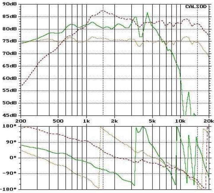

These have notches right around the cabinet diffraction peak. I'm guessing here but it looks like they tried to notch out the diffraction at one observation point, or cluster of observation points. Bad idea, it makes it flat at one point but colours the tonal balance in room. Been there tried that over many years.
My understanding was that they were notching driver resonances, but I never cared enough to confirm. You always come up with some alternate view Dave, but I'm quite sure that is not what those notches are doing.
Further, the tweeter notch is in the transition band, at about the 40 dB down point where
it is not going to impact the total summed response significantly. I believe it is helping to
reduce tweeter displacement at the notch frequency.
The published data by Toole, which came from Freyer, has confused many in its interpretation.
The studies are done with a dual path filter. One side is flat straight through. A parallel path has adjustable Q and level. At a variety of frequencies a resonant circuit is set to some Q and its level raised and lowered to find the threshold of audibility. Low Q resonances are found to be more audible and in general for every doubling of Q the peak must be 3 dB louder for the same audibility.
There you have it. High Q is less audible and we should never attempt to damp resonances!
Unfortunately the electrical filter test has mislead us since we can independently adjust Q and level. In the case of physical systems level of the peak is not fixed as we adjust Q. It turns out that if we cut Q in half by adding damping the level of the peak will naturally drop by 6 dB. So the reduced Q should make the peak 3 dB more audible (if level were fixed) but its level drops 6 dB for a net improvement of 3dB.
So damping resonances is actually worthwhile (whew!), always!
People are heavily bothered by the thought of cabinets with minimal stiffness and I'm not really advocating that. Still, I have never seen a cabinet so floppy that significant bass was lost and the notional limp mass curtain would still give some bass issolation. The real issue is not energy lost through cabinet transparency but the narrow band resonant nature of the transparency. Most cabinet measurements show their first resonances in the lower midrange and damping the resonances is the only practical course for real improvement.
As for Harwood being out of date, we still make cabinets of the form he describes with the issues he measures. We have yet to find cures outside of some form of damping. It is also noteworthy that the camp that believes damping isn't required and stiffness or wall mass are the answer have yet to show any measurements to back that up.
David
Notches shown are when the network is loaded by resistors for testing. The curve into the drivers will be dip free and the total response will hit the Acoustic Butterworth targets.
David S
Good point Dave, I remember reading that about the resistive test loads
but was not sure how they'd test with the drivers as a load.
I believe that the woofer load would have to have a peak at the dip frequency
for the drive voltage to flatten and I think that the dip is to deal with a cone
resonance so that the acoustic output matches the target.

If I come up with an alternative view, its for technical reasons only. I'm not trying to be contrarian, its no fun having learned people ignore the facts I present because they don't follow an orthodoxy or reputational pecking order.
It looks like Dave is right on the tweeter, I was right on the woofer
The T27 had a resonance of 1200Hz, so that explains the notch in the high pass to 8 ohms.
I pulled up my impedance measure of the B110 and there is no resonance anywhere near the 1 kHz notch in their low pass filter (see below, freq, mag, phase). The impedance is fairly benign there. Driver impedance loading will not fill in this dip on the low pass.
I also pulled out my B110 measurement (in JR149, attached) and there are no unusual break up modes or peaks near the filters 1 kHz low pass notch.
The 1 kHz low pass notch has nothing to do with electrical loading.
I'm now certain in my comment as it applies to the woofer, and it makes sense when thinking about what KEF were trying to accomplish. KEF were attempting to achieve butterworth response in the acoustic domain and in order to do so, they had to provide shaping that equalizes out the diffraction. Had to. I have the old KEF acoustic butterworth papers and they were being very specific to try and hit this target with very tight tolerances, and at one observation point in space.
That cabinet size puts the diffraction peak right at where that low pass notch was. the notch may also be equalizing out artefacts of the driver being mounted behind the baffle.
The diffraction signature varies with observation point so the "acoustic butterworth" can only be achieved at one location in space. In my experience as supported in 2 years of measuring and tuning the modded JR149 and many many years doing the same with other speakers, this approach (flat at one observation point above all else) creates tonal error in the in-room response and at off axis positions. But it depends upon the room and where the speaker is placed (ie how strong the early reflections are). You might get away with it in a very large room with the speaker away from boundaries, but that's not what these were meant for.

Tweeter:
Dave you know from probably 20 years ago that I get the diffraction thing. Diffraction bumps are not usually as high Q as the notch that is in that crossover but I'm going to try and not get into a back and forth yet again with you. I believe that certain revisions of the B110 had a resonance that was "corrected" in this crossover. So, if the OP plans to use the same spec drivers as in the KEF CS1A design, in a baffle with similar dimensions, and with it front mounted this crossover might be a good choice. This is all that I was suggesting by posting the links in the first place.
Having dealt with you in the past I do think that you are deliberately contrarian Dave, as you are quick to point out who is right in your mind. I was not suggesting to use this crossover with a JR149 type box. I said previously that the woofer would not have an impedance peak at the notch frequency - that should be obvious.
You wrote:
"If I come up with an alternative view, its for technical reasons only. I'm not trying to be contrarian, its no fun having learned people ignore the facts I present because they don't follow an orthodoxy or reputational pecking order."
The "facts I (you) present" are you sure they are facts? Do you have in spec B110 SPL measurements directly driven in the KEF CS1A enclosure and measurements on a large flat baffle to prove that it is diffraction?
You wrote:
"The T27 had a resonance of 1200Hz, so that explains the notch in the high pass to 8 ohms."
So if you knew that the T27 had a resonance of 1200 Hz then why were you so quick to leap to
the conclusion that I was wrong and that it was diffraction - to be a contrarian.
I find this really annoying and I remember this pattern from past discussions with you.
Pete, I thought the t27 fs was much higher. I looked it up after I posted (it wasn't easy to find) and at that time realized I was incorrect about the high pass notch. I stand by the rest.
Regarding diffraction,yes, I have a model of that baffle size and the peak is at 1 kHz.
I post what I think is technically correct and back it up. I'm sorry you take it personally.

I was trying to point out two broad factors that need to be considered, but that weren't:
- one pass/fail criteria ala Harwood can't be applied without factoring in q of the resonance or more recent and complete research on the topic of audibility. Adding stiffness increases q, so even though the level is higher, it may not be more audible. Secondly, Harwood was too lenient in allowing resonances at lower frequencies
- I pointed out the beneficial effects of bracing, internal absorption and driver decoupling to a heavy stiff cabinet with high resonance points and myself and others pointed towards useful data in this regards
I agree it would be nice to see measured data detailing pros/cons beyond the Harwood paper but I raised enough skepticism that its woefully incomplete and out of date.
Adding stiffness doesn't typically increase Q. Of course there are a number of possible scenarios, but the most typical one discussed in the forums is of assuming a material and then considering what thickness is best. The vast majority of cabinets are MDF or (a distant second) plywood. Both Barlow and Harwood show measurements of the specific case of varying wall thickness of a cabinet or barrier. For both, resonances go up in frequency but do not change in Q. Specifically, the panel output (Harwood uses a microphone nearfield to the center of the cabinet surfaces) at the resonant peaks is constant.
I have no argument with the Olive data on audibility of resonances. It is good to expand our understanding of the topic. I would repeat my caution on its interpretation, especially when applied to mechanical systems. Adding damping to reduce resonance Q is always desrable because the peak level drops at twice the rate that the perceptability increases. This needs to be understood.
I would assume that there was common ground between the Harwood numbers and the Olive numbers. It is worth discussing Harwood's method. He simply sampled a large number of cabinets and noted the frequency and level of the significant panel resonances (vs. Mean woofer level) and also whether they were audible or not.
From this he could plot a nominal boundary between audible and non-audible. This is a very practical approach. We have to be careful not to generalize too far beyond his specific cases (mid sized 2 and 3 way loudspeaker cabinets) but for that his methodology is sound. I don't accept any arguement that it is out of date. Cabinets are still made out of wood and our hearing mechanism, to my knowledge, has not eveolved. As to Harwood's rise in the threshold at low frequencies, I would guess that was tied to his approach of taking nearfield panel measurements.
As to bracing or driver decoupling, They are valid approaches. Andrew's paper backs up what was previously found at KEF (where we both worked): cabinet vibration is largely driven by direct acceleration from the woofer chassis.
For the majority of diy builders who don't go down the path of decoupling, effective damping is the best course and excessive cabinet mass or rigidity makes that difficult.
