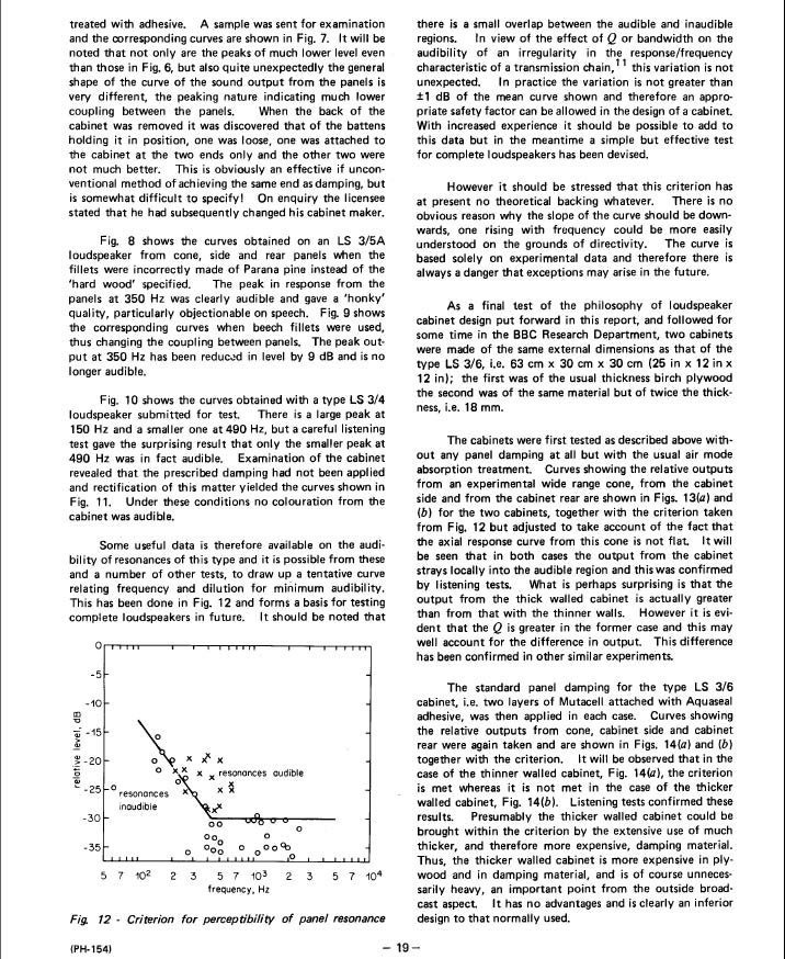

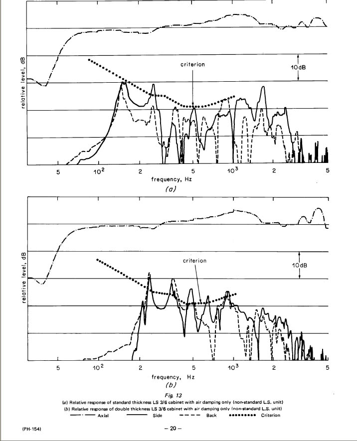

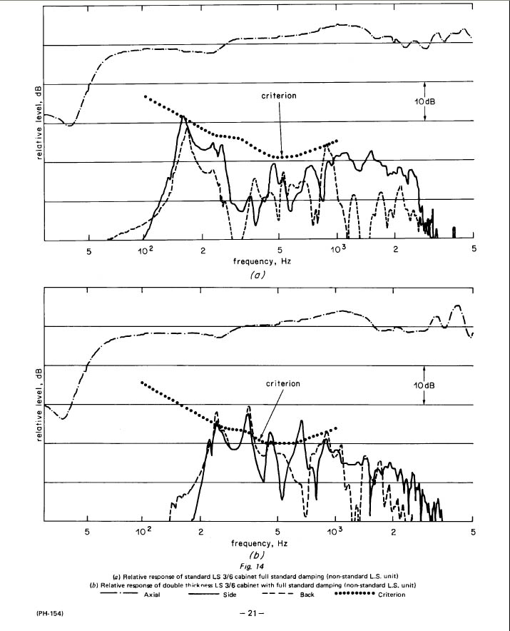

I obviously can't understand what that is telling me about "transparency" for very thick and very heavy panels.
I asked about limits when the "rules" as have been stated no longer hold true.
I.e. is 300mm concrete "transparent" to audio signals?
If it isn't, then when do the rules change from transparent to attenuating?

I have not seen accelerometer curves for 300mm concrete. I suspect you haven't either.
What we do know is that heavy and dense materials, in the absence of effective damping, have multiple resonances. At these resonances the walls are highly transparent. Walls of realistic design (somewhat less than 300mm thick) have their resonances in the audio range and are not "cured" by virtue of being heavier and stiffer than the next guys cabinets.
Skyscraper designers know that all the steel and concrete in the world will still resonate and present an earthquake danger. The only cure is large tuned resonator masses and pools of viscous fluid.
The "rules" are very simple: have a high proportion of your wall mass from damping matter rather than rigid matter. This will lower the Q of your resonances and the frequency of resonance will not be of any importance.
Doesn't this make more sense than hoping problems will finally go away when silly cabinet dimensions are reached?
