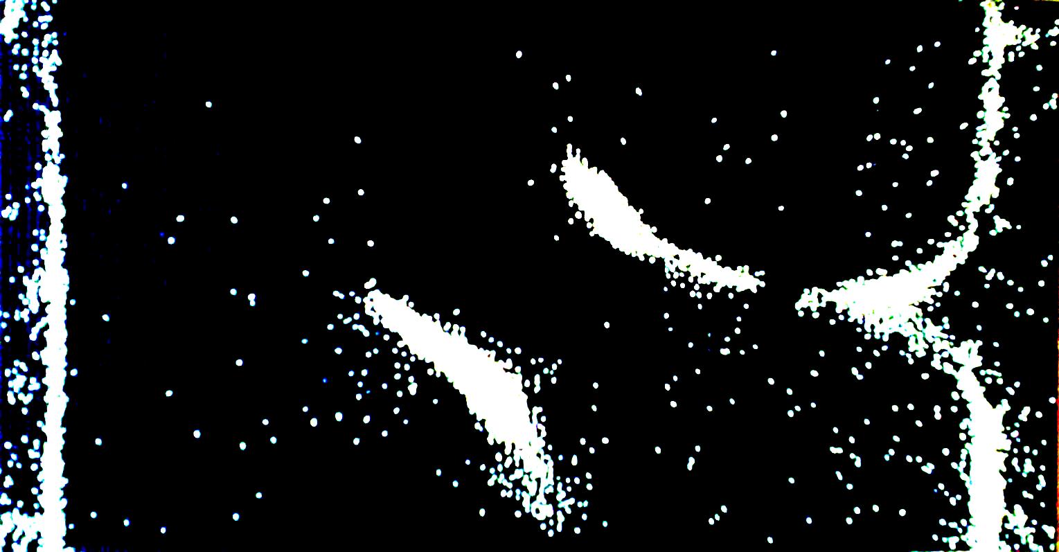

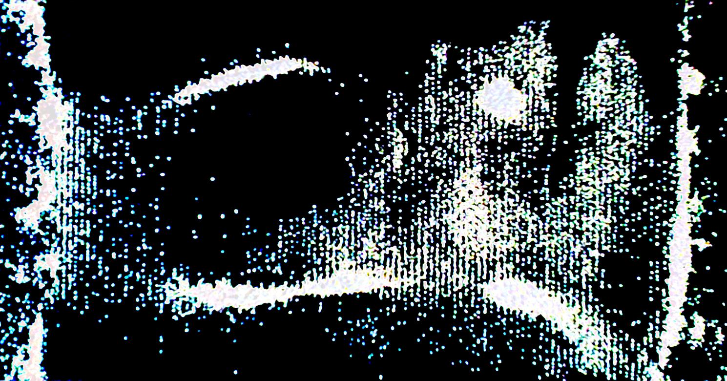

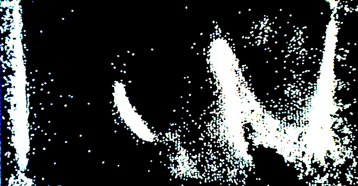

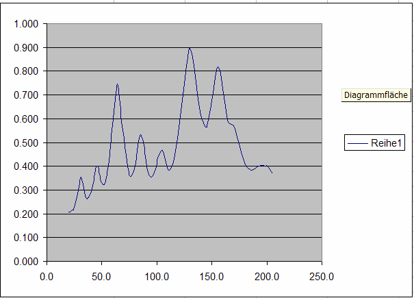

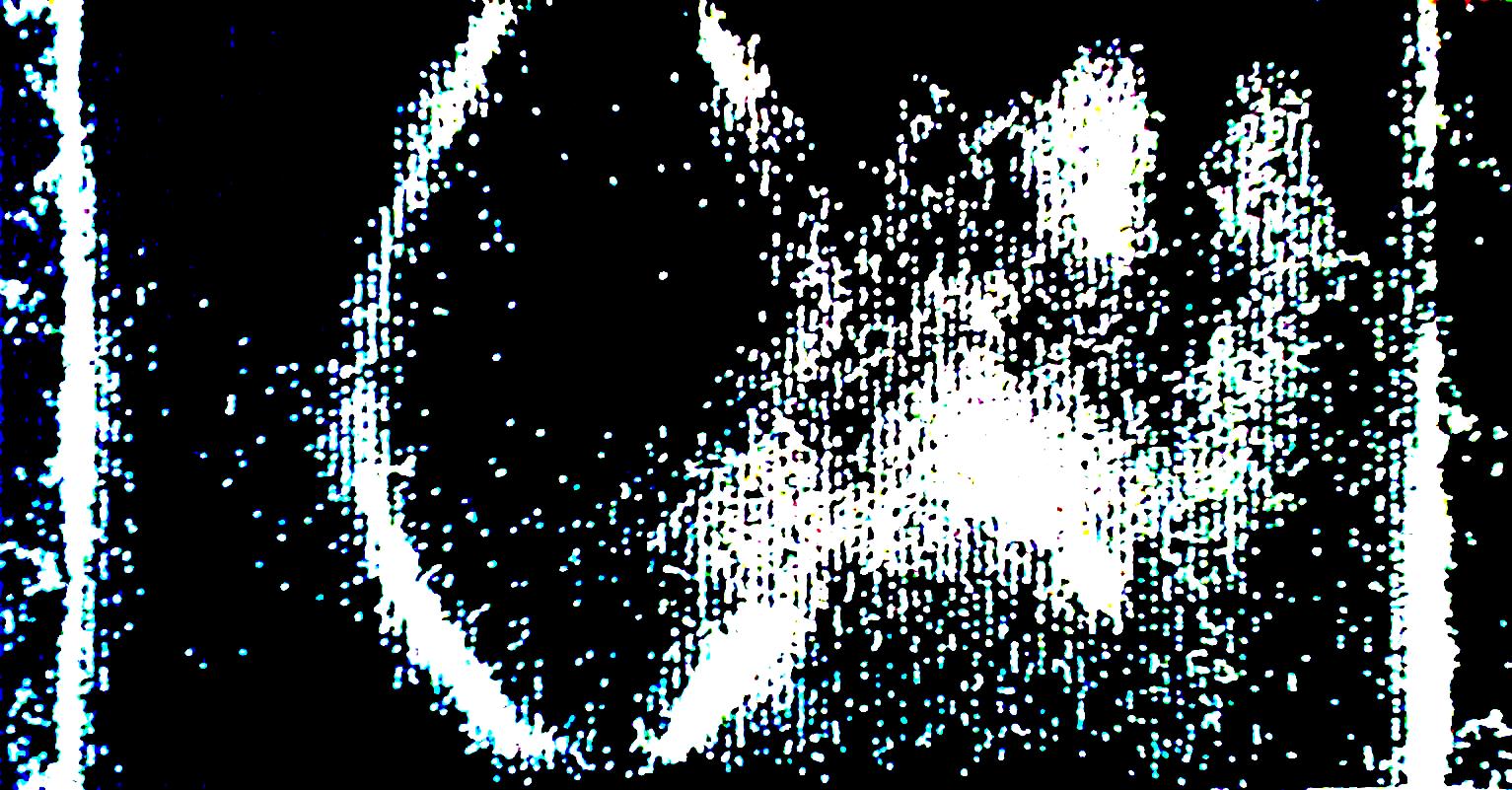

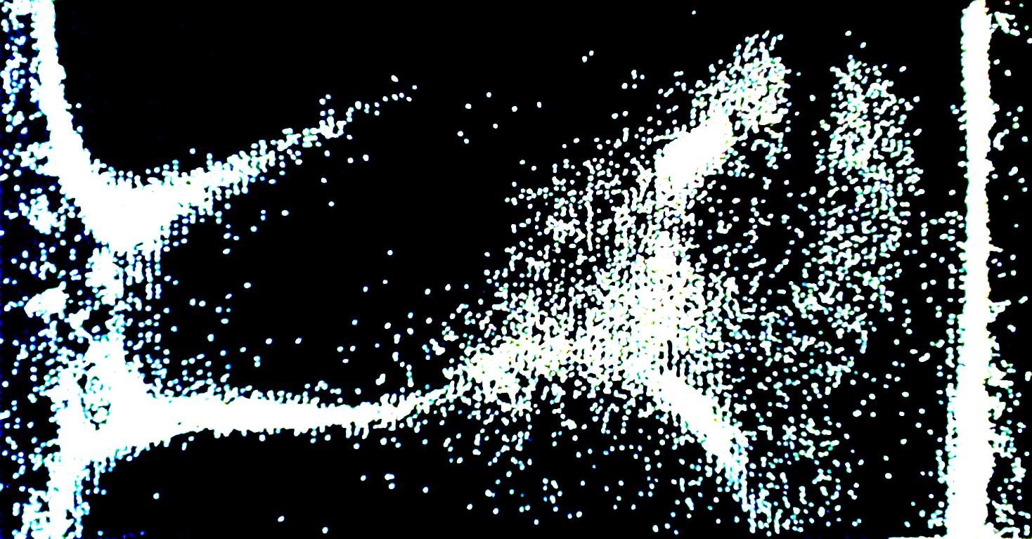

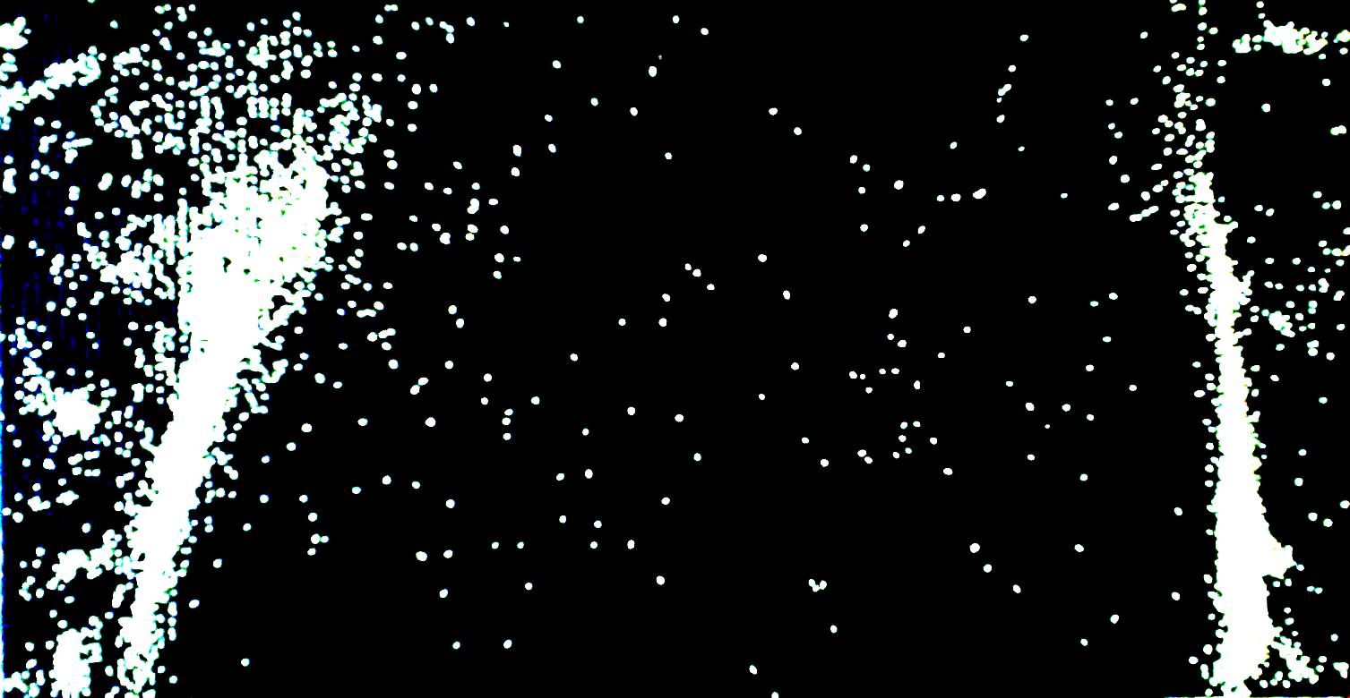

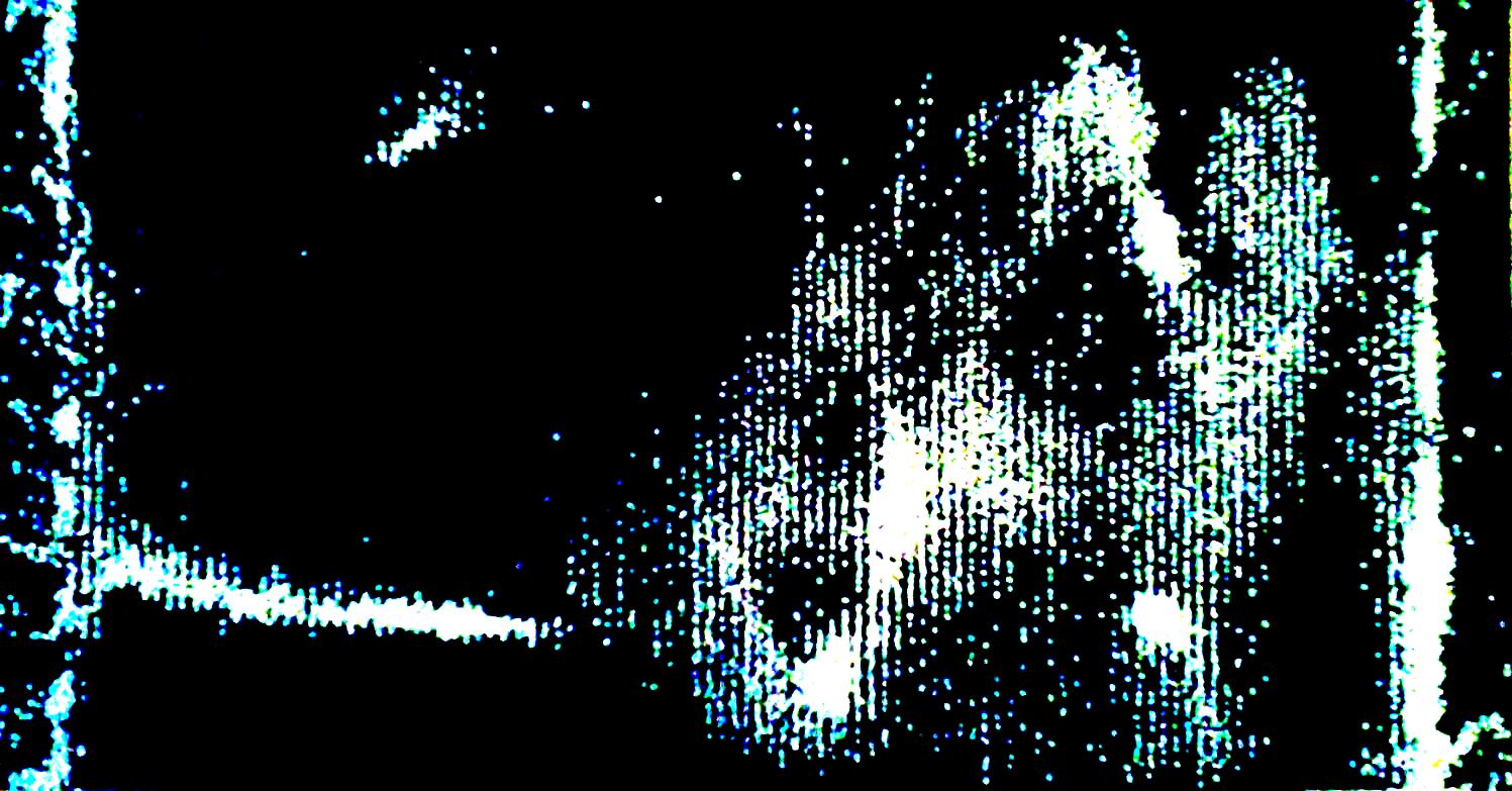

This diagram is proportional to the driving point velocity of a rectangular panel form PP structure, that is fixed at two edges and exited with offset from the middle using an electrodynamic exciter.
PP is a material known for high damping ...
What you can see here is that the Q of lower and higher order modes is about the same. That is a common behaviour with all kinds of materials and also composites: There is no increase in damping with frequency rising.
I made these measurements at a prototype sheet to be applied in a bending wave panel. What you see is modal overlap rising with frequency of course.
In Addition to the diagram i posted some pictures showing, how the corresponding modes looked like ...
The white regions represent node lines of low (or zero) velocity. Node lines are separating zones of opposite phase of motion on that sheet of material.
These are phpotographs of powder, that has been used, to make the nodelines of the vibrational modes visible. Basis method is about 200 Years old and is according to Ernst Chladni.

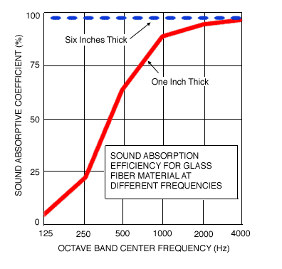

Here is an example of loss factor vs frequency for an industrial acoustical panel. Does this refute anything?
Thanks, thats an interesting reference, although it doesn't benefit your point. They are actually showing the total performance of a constrained layer system (the MPM metal damping sandwich). It shows a slight rise with frequency towards a max at 1kHz.
