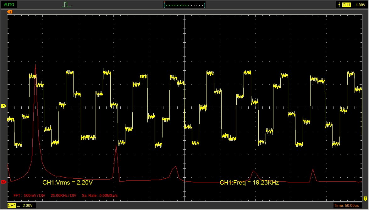

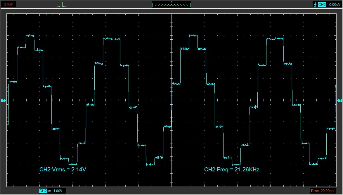

Well, it would be nice to have some more equipment, since I already love this hobby. For now only Hantek USB scope 4x250MHz with some modest FFT and function generator. It's just to detect the problem, do the amplifier compensation, check the frequency range and similar simple things, while the THD measurement is modest with it, i think 0.1% is the limit. When I look at the output of any of my DACs, it's not a sine wave, it's a stepped signal with a lot of THD. What conclusion can I draw from measuring it, other than that I have a lot of THD and noise?

Yes, I agree. I'm just not the only one who has done it. 😎
In the real world, it sounds better than with a filter. I don't know how much it bothers the rest of the electronics, but the speakers must already be wiping out everything above 20kHz.
It wreaks havoc if preamplifier and/or amplifier doesn't have input RC filter.
Such signal has bandwidth, by rough estimate, above 3 MHz. It would excite any existing instability in the following amplification chain, probably resulting in HF ringing. Mild example looks like this:
https://www.diyaudio.com/community/threads/jlh-10-watt-class-a-amplifier.3075/post-7139823
After seeing your pictures, I will never listen to digital stuff again. I hope that we now reached a conclusion that no DAC is even worth listening to at all and should only be used in phones and squeaky toys.
Trust me, it sounds great, lively, natural. Do not look at the pictures in general, they do not tell how it plays. Such a signal does not reach you, or any living creature. Some filtering is done by the preamp and amplifier, some by the speakers and cable capacity. On the DDDAC I have a transformer on the output, it cuts almost like a brickwall everything above 80k.
Can imagine non os (been there done that) but no analog filtering at all is possible torture for most (pre)amplifiers and loudspeakers certainly when those lack input filtering. It seems asking for trouble but apparently you like listening to the result.
The filter should reconstruct the signal, remove the harmonics that do not exist in the original recording, so that it is not the same as on my pictures but a nice clean sinusoid. Unfortunately, for some reason oversampling + digital filter + analog filter affects the sound badly. Ever since I discovered that, I just make these DACs without oversampling and filtering. I have certain filtering on some devices because I use 1:1 transformers due to DC offset, and in the new project there will almost certainly be a transformer in the I/V stage as well.
