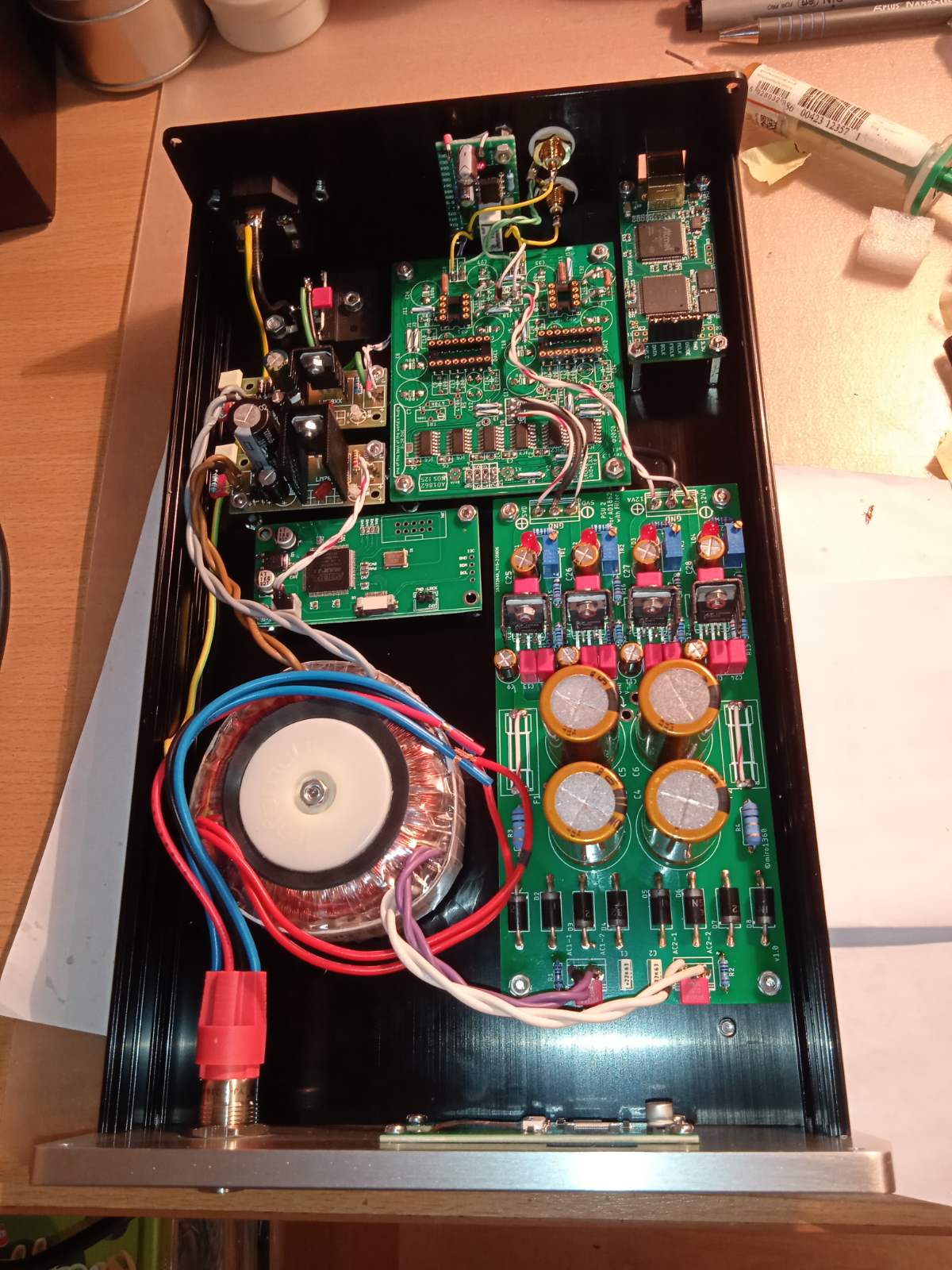

At the moment I only have DDDAC with that transformer, the others the others don't have it (AD1862, AD1865 and PCM1702). They have no filter. I'm just finishing the mini AD1862, as you can see there are no others except the mains transformer.Just don't state that they are filterless when there are transformers involved. I recall having tried a AD1860 based DAC long ago without anything except its internal IV opamp and it was awful.

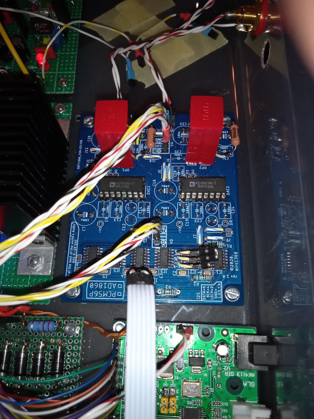

I also tested the AD1860, that sounds great just a little softer than the others, very similar to PCM56. With external OPA and good power supply.
