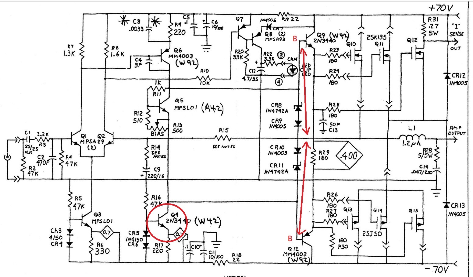

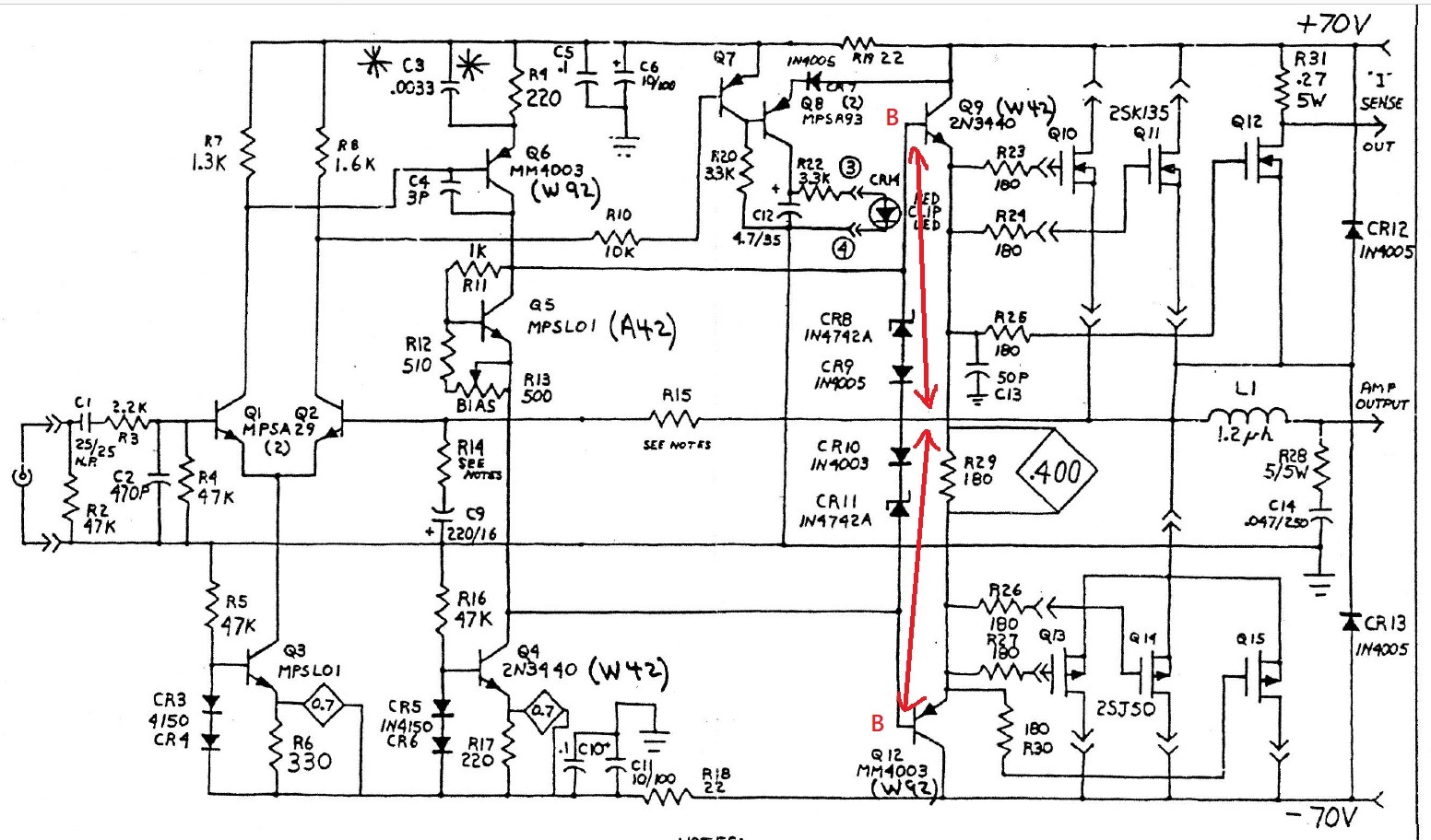

can anyone offer help understanding the flow of this circuit
That will be off because the output has high dc. You measured resistance to the heat sink as low from the mosfets. Is the working channel the same?

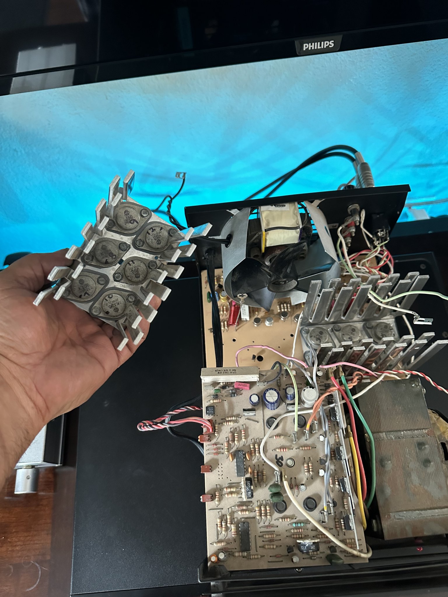

Hi Wayne, I did measure the mosfet cases to the heat sinks. The good channel readings were exactly the same. I took a leap of faith today and installed the suspected bad mosfets on the working channel and all was well on the outputs = 0vdc ..and then took it a step further and played music thru the channel so the problem is on th driver board and i can eliminate the idea that i have bad mosfets. heres a picture of the switched mosfets ..the installed mosfets were the one on the side of the driver board that was not working.....question? what would happen if i were to loose rail voltage on 1 of the sides of the circuit under load.
