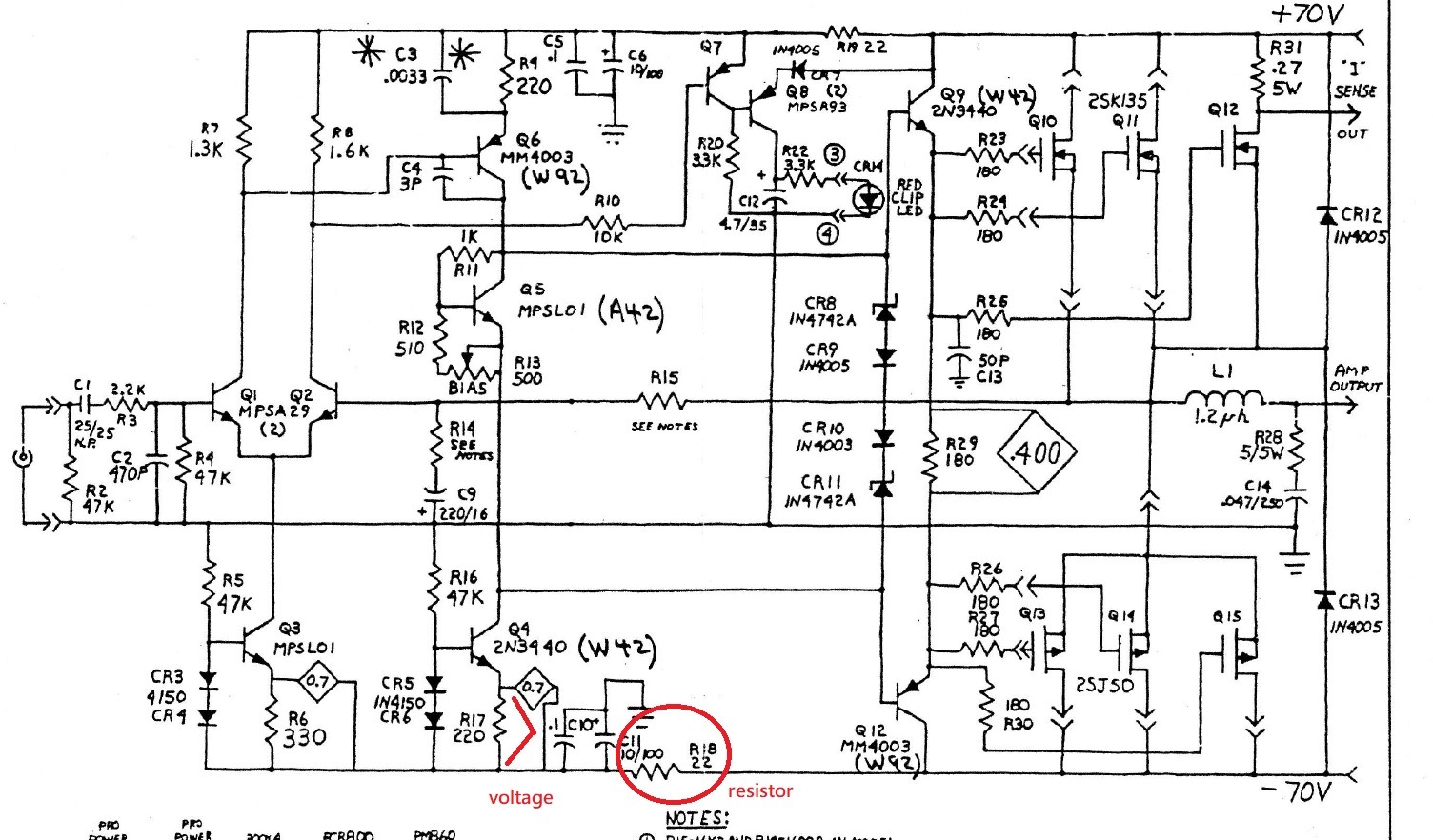

can anyone offer help understanding the flow of this circuit
Ok, correction. across the 180ohm resistors...I think these are the ones connected to the gates of the mosfets? ...dc volt =0volts. there is a 180ohm resistor for each channel across those resistors i got a reading of 500mv, i think thats the bias?
please check the resistor and the voltage marked in red color
r18= 21.9 ...voltage across r17 220ohms =.61volts
thanks

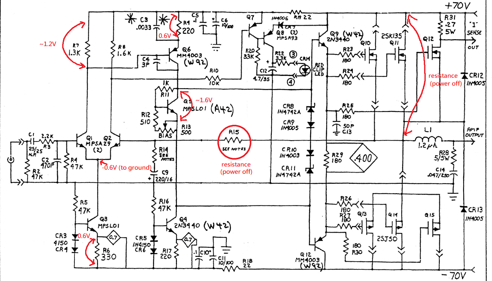

power down, no voltage at the supply rails, measure the output MOSFETs resistance in the circuit board and the feedback resistor R15 (schematic value is 22K), if the resistance is normal then I listed the reference voltages in the diagram for the amp in normal condition, please check and compare with them
Good luck
Good luck

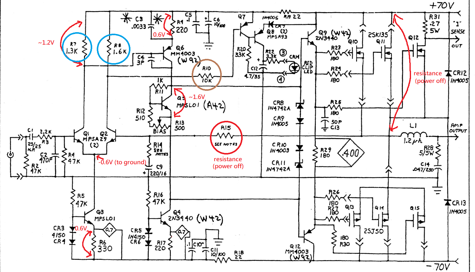

thank you Patrick. I really appreciate the help. the measurement on the Q1andQ2
these are the reading i came up with. very hard to do with no numbering on the pc board. ..not sure how to check the resistance of the mosfets but i did check them with a peak tester and all the mosfets were identifiable. the connection from +70 to the 1.2uh coil is open infinite res
Okay the outputs seem okay or at least the gates are not blown and the other 180 ohm voltage seems okay. The suggested voltages would be good to know. The 220uf cap wont be happy after seeing relatively high reverse voltage. Can you Ohm out the Mosfet cases to the heat sink with the power off?
