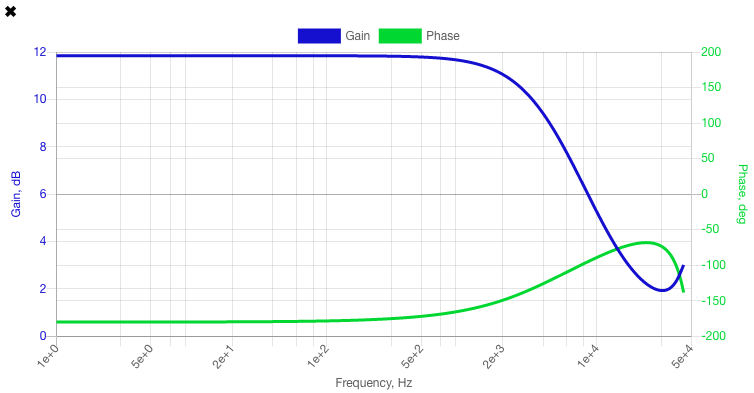

Well I got everything working, including the web server. I have to say, that's very cool.
I have a couple of issues/questions, though.
I'm using my 2nd gen Scarlett 18i20 as an input for a turntable and trying to do RIAA correction digitally (because why not )
The issue i'm having is that the coefficients in the MiniDSP excel sheet https://www.minidsp.com/images/fbfiles/files/All_digital_coefs_v1-20101026.zip are giving errors in Camilladsp - that the biquad isn't stable.
Any idea why that might be the case? I swapped the a's and b's around and that seems to work.
The second issue is that the filter viz makes it hard to know if those filters are working correctly, because the bit we care most about 20hz - 20khz seems a bit squashed
Not the end of the world but a little hard to work with if you're using the web interface.
Final issue is that I'm getting a bunch of errors/warnings in camillagui that it's having trouble with a parameter and that's causing some issue
I'm wondering if this is because camillagui is not in the same directory as camilladsp?
Anyhoo, great work, this is a really thorough DSP implementation that can do all this neat stuff on a raspberry pi!

this works, but is it _right_?
a0 1
b1 1.732765500000000
b2 -0.734553443600000
b0 1.000000000000000
a1 -0.755552100000000
a2 -0.164625711300000
